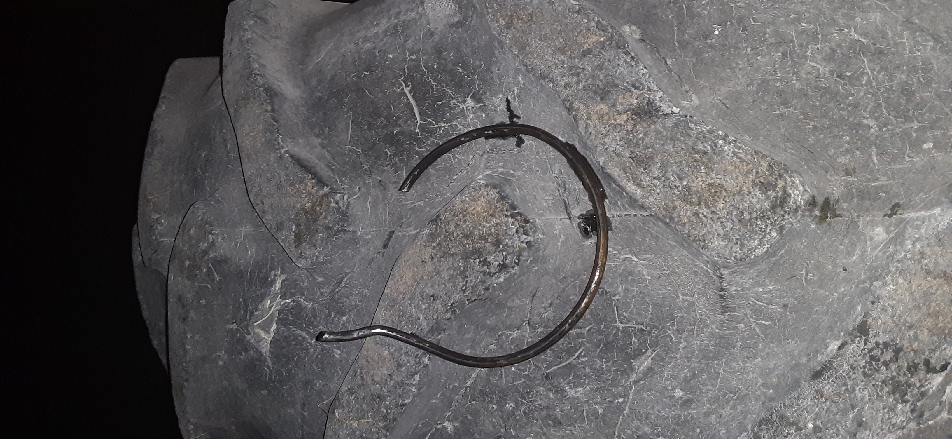

Awhile ago when I was working on it I found a ring in the bottom of the clutch housing

That would have been helpful to know. A 3 inch diameter piece of wire ????????

I think so
I told people about this on a previous form topic but no one told me anything

this is what I found
