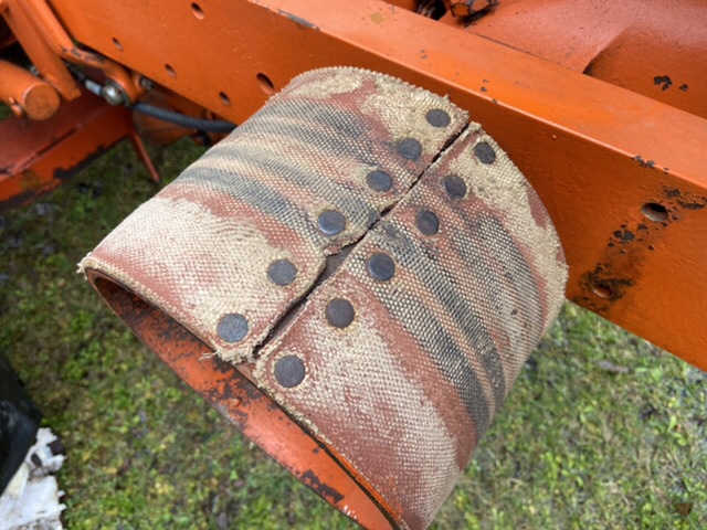

Post Options Post Options   Thanks (0) Thanks(0)   Quote Ed (Ont) Quote  Post ReplyReply Direct Link To This Post Posted: 17 Apr 2024 at 11:17am
This is my pulley with belt material riveted on. Wonder if this was factory or dealer installed? It worked well. I can’t remember if it came from the dealer like this.
Edited by Ed (Ont) - 17 Apr 2024 at 11:21am

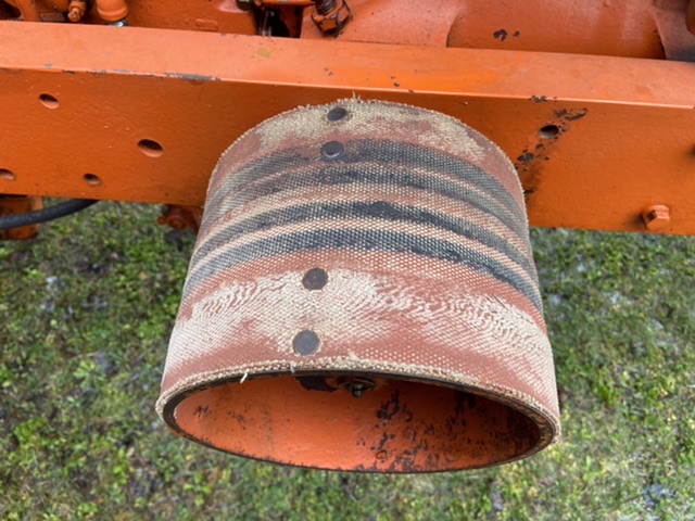

Post Options Post Options   Thanks (0) Thanks(0)   Quote Ed (Ont) Quote  Post ReplyReply Direct Link To This Post Posted: 17 Apr 2024 at 11:24am
Another view.
