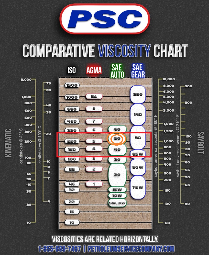

I will not give a recommendation because i dont know.. But "MOST" hydraulic oils are in the 10 - 20 - 30 viscosity range..
50w engine oil is comparible VISCOSITY WISE to 80-90 gear lube or ISO 150 - 220 industrial gear lube...
Edited by steve(ill) - 29 Mar 2024 at 2:57pm
