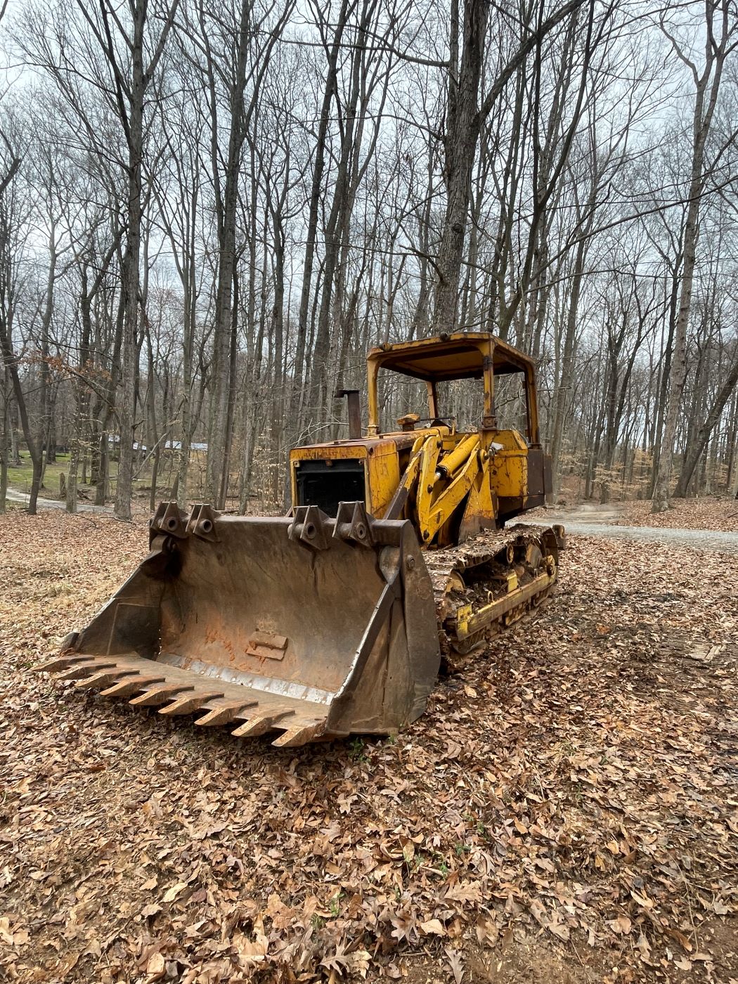

I have the 3500 engine, can anyone tell me what the injection timing should be . I need a service manual if anyone has one forsale .. my loader has one top track roller thanks!!

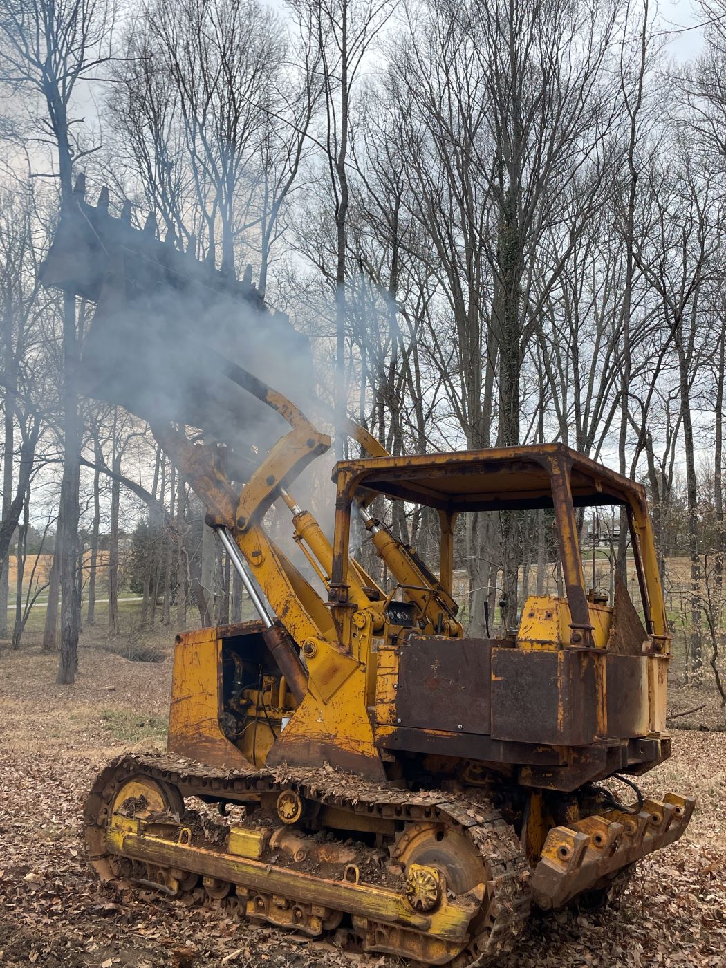

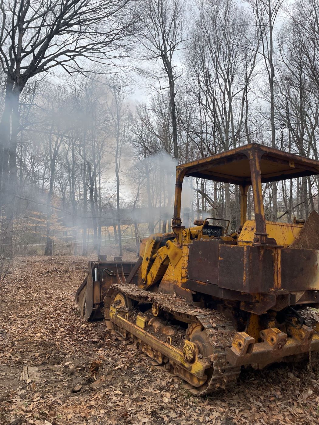

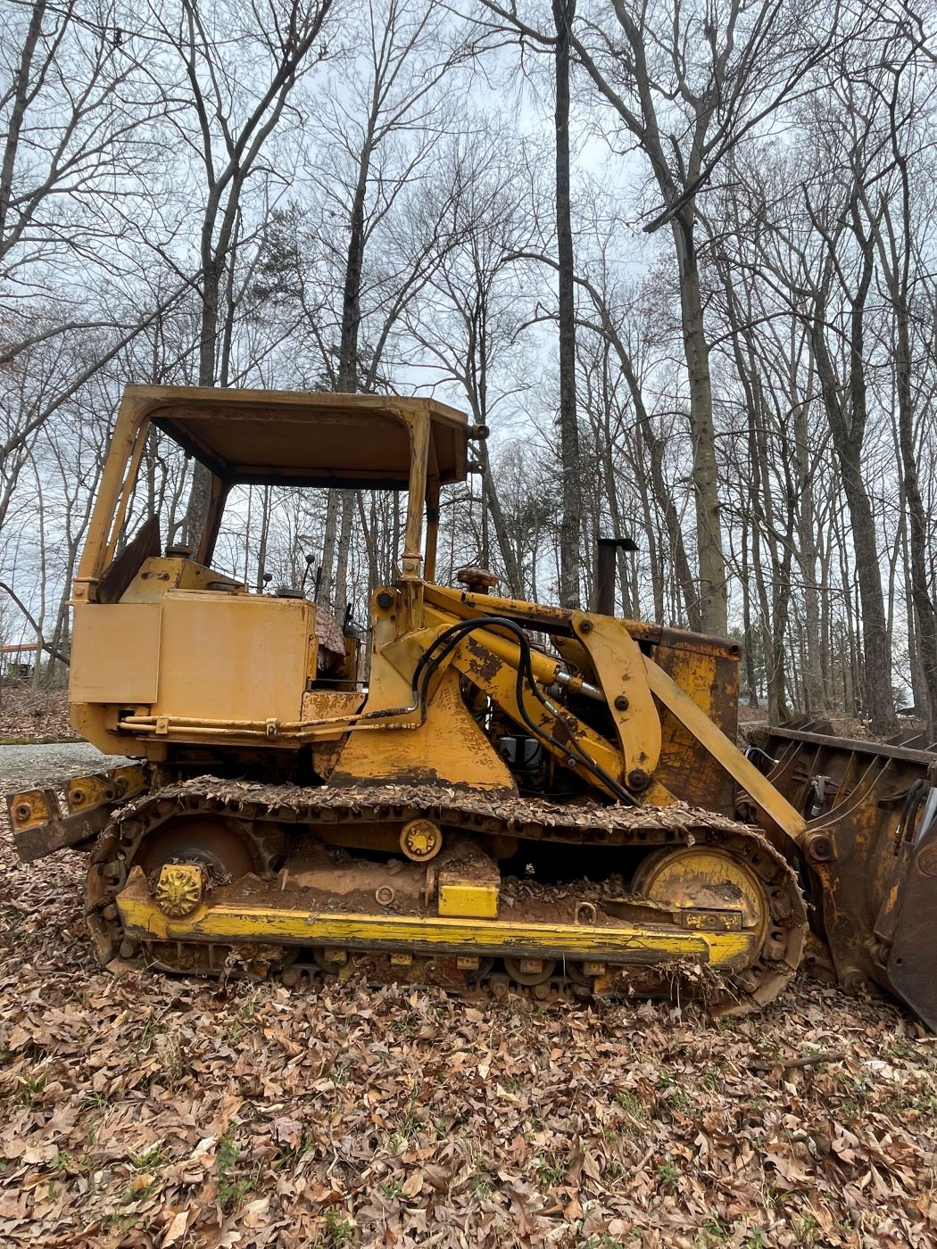

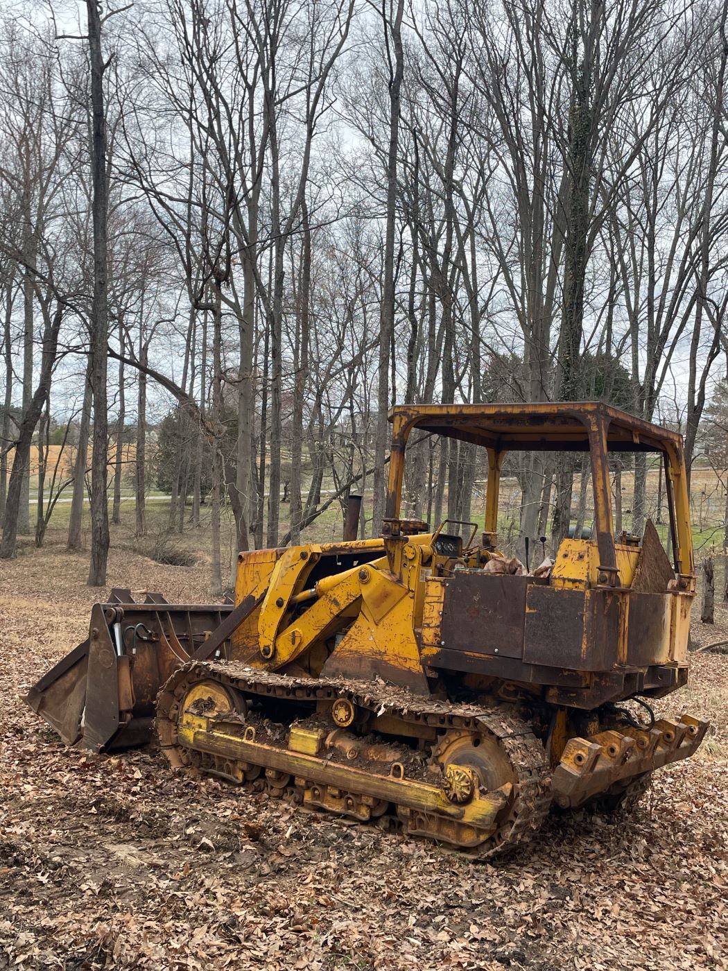

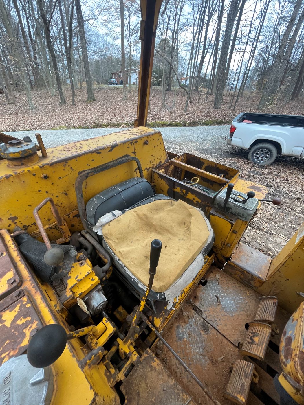

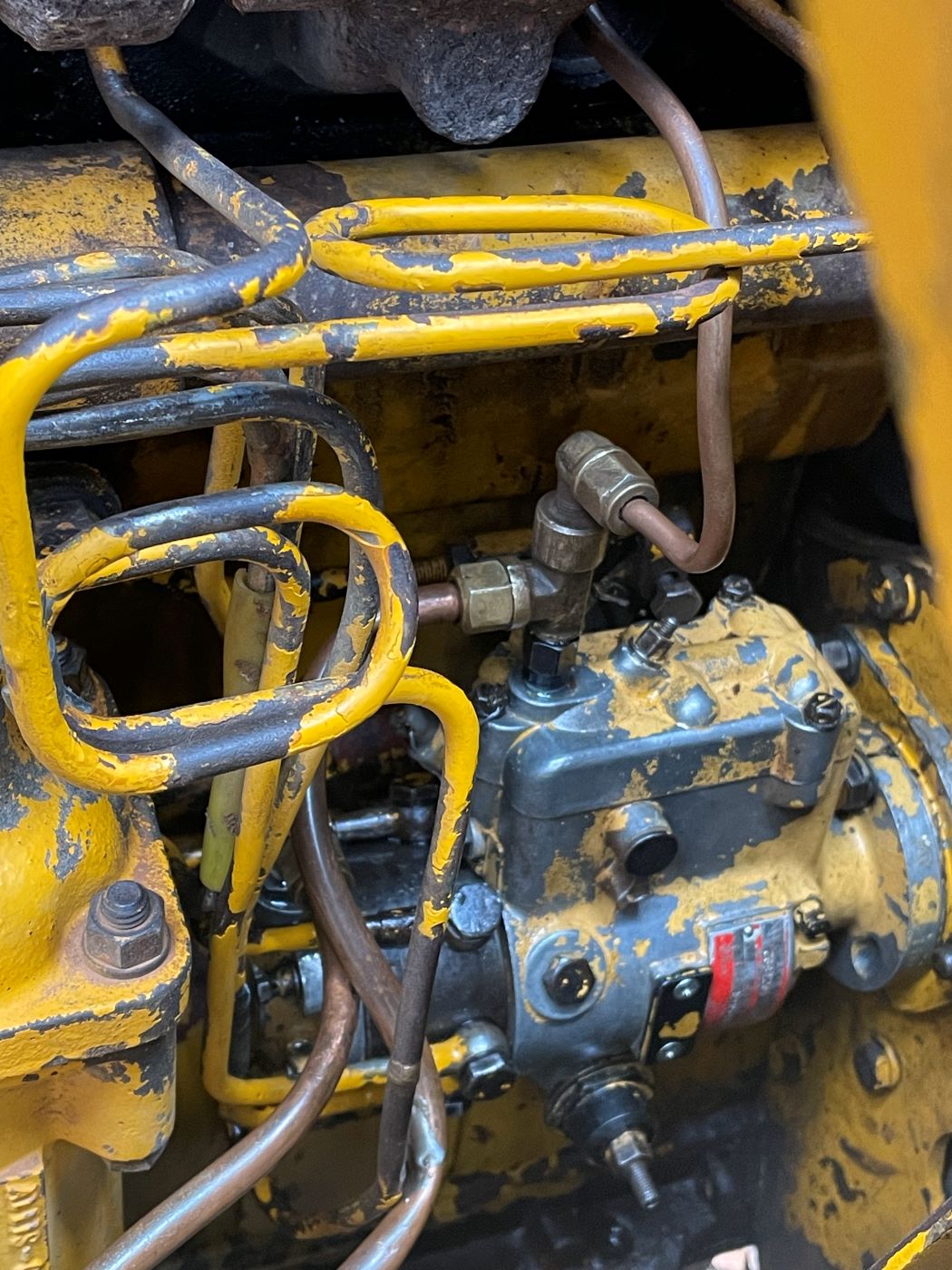

Ok....Been talking....texting..and emailing with Randy...he got the tractor running...I sent him links to the necessary parts and service manuals on ebay. He was struggling with pictures to post....so he text them to me ...I resized them ..hoping they will work...looks like a nice specimen.  He could jump in now and answer question..or comment.

Really needs the missing fastener in the Roosa-Master pump flange.

There are only two trades holes in the pump adapter , I thought the same…

Sorry, I meant threaded holes,

That would be the first two fastener mounting for the Roosa-Master style pumps I've seen and I've been around a lot of them; though not Allis-Chalmers in design
I'd wager you are correct in the two fastener mounting scenario. I've never seen a flange with the four mounting holes/slots in the past. All have been the three slots only. This pump is for a 3500 Allis engine and you can plainly see the 180 degrees opposed mounting slot:

One thing that stands out in the pump picture on the tractor is the soft copper line with the kink in the line.  Should have a rubber fuel line there to keep the lines from rubbing a hole in each other...Wink
