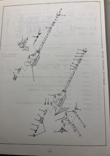

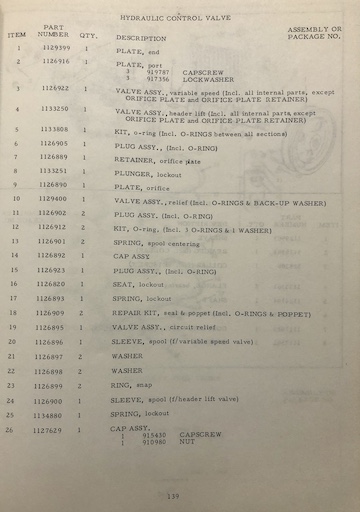

Remove the valve's spool rod(plunger)from it's body. There is usually a snap ring at it's front. The rear can be a hollow nut?. Once the spool is removed, clean/inspect all the dirty oil from within it. If you find more than just dirty oil(yucky solids?), then unbolt the valve body from it's valve stack(multiple valves sandwiched together?), if that is how its arranged? And, thoroughly clean all valves/springs/portals, etc.  Probably best to replace o-rings at this time?
Here's a copy of Gleaner AII Dealers Parts Catalog, Section II - Combine, March 1965, hydraulic control valve pages 138 & 139. I believe the valve you're interesting in is Valve #3.

Valve three is my stack in question…I’ve had this all apart…when you call to speed up the variable speed oil flows through port past the poppet number 18…once you are done calling for oil spring 17 pushes the poppet closed….when you want to slow down something has to release the poppet…I’m guessing the relief valve number 19 has to move forward and push the metal stem of poppet to release the oil back into the valve…is that a correct line of thinking? I’ve had this section apart on the bench and by shining light and adding oil and operating the spool by hand it doesn’t seem there’s any sections on the spook through normal travel that send oil to the relief valve to push it forward…my relief valve is free also not stuck in the valve…I’ve tried to make adjustments to it even though the book says not too, and I’ve tried a different relief valve from a combine the neighbor had.

Number 9 orifice plugged ??

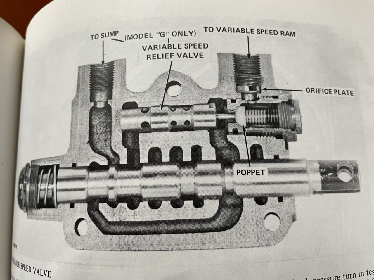

Post Options Post Options   Thanks (0) Thanks(0)   Quote Oldoug Quote  Post ReplyReply Direct Link To This Post Posted: 09 Jan 2024 at 11:27pm
Here is a cut away picture of the valve in question…oil is supplied and returned through the same port on the valve…the port labeled “TO VARIABLE SPEED RAM”…how is the return oil supposed to get past the poppet?

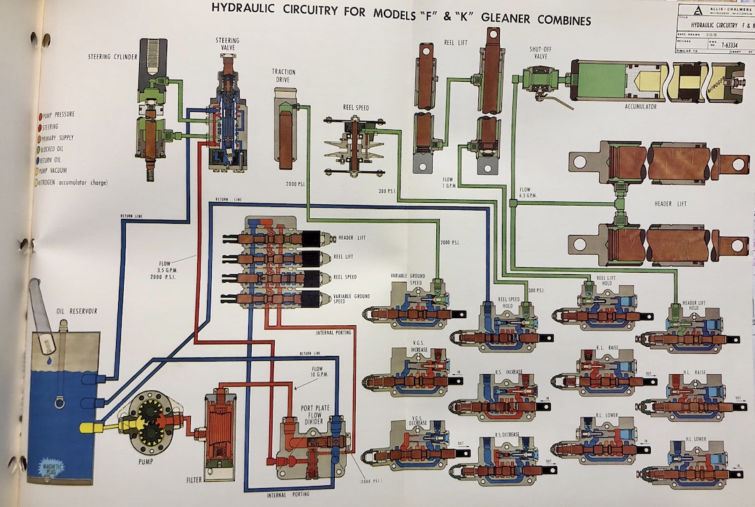

So you have an AC Gleaner Service Manual? I do too. Maybe you haven't found it's hydraulic circuitry fold-out near the back of the manual? If not, here is a copy of my gleaner K/F hydraulic circuitry that shows the functionality of each component. It shows by colors how the Variable Speed Valve's internals function. In that same service manual's hydraulic section, try going to page 7 where it discusses in detail how the variable speed valve(VSV) operates.
It appears that you've addressed most every other avenue per your A2's hydraulic restoration? So my guess is that some item(s) within your VSV are either worn out, absent, or incorrectly placed? Hoping the above illustration helps you? You do restoration right? So do you have multiple gleaners setting about? If so, then remove an UN-touched VSV from one of parts machines & insert it into this A2's hyd system & see what happens. If that corrects the problem & you want to know whats up with this problematic VSV, carefully disassemble them both & compare.

Thank you for this color breakdown schematic…this is what I have been hoping and looking for all along is some information on how the oil flows through these valves.

Sorry I missed the feeder house bit. The pressure relief valve in your black and white pic is a little misleading. It's more of a pressure bleed off spool. It appears to be pilot operated to push the poppet.
