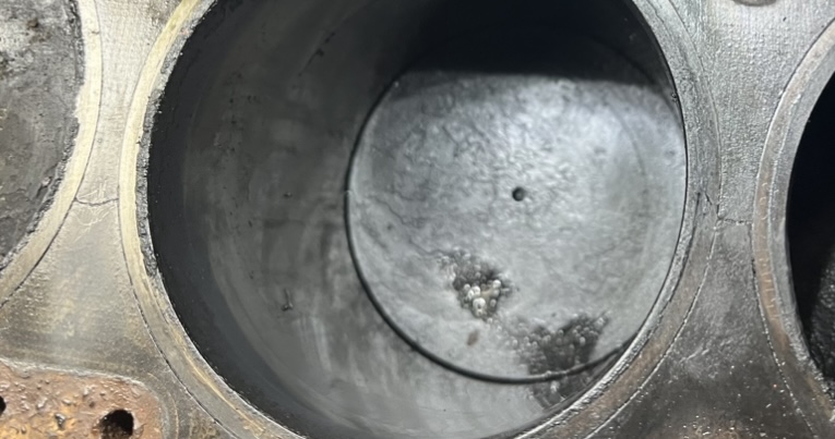

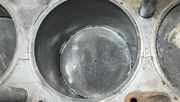

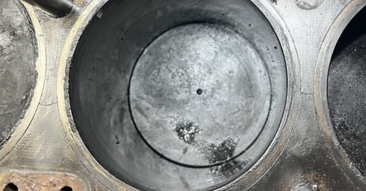

The engine has never been touched, original head gasket. Factory paint on every bolt. After removing the fuel injection system and the head - Headgasket looked ok. Sleeves look great, the head looks great. No cracks. After cleaning off the head gasket, we discovered cracks between the cylinders.
Just started hunting for options. It’s been a very frustrating couple days on the phone and on the Internet.

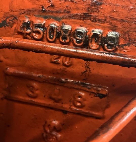

I’m pretty sure I found the engine casting number it is 4508909.   Cracks are between cylinders 1&2, 2&3, 4&5, and 5&6
Any advice would be great

Those cracks won’t hurt anything.   Coolant in the oil is more likely from the sleeve o-rings.   Mike the bores and see how much wear you have before you go crazy…. Maybe new o-rings will solve the issue.

With 100% crackage on the top deck, I find it hard to believe it isn't cracked at least ONE PLACE down below, meaning a different block.
