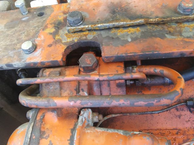

Got a D14 forklift that power steering doesent work. How do you check pressure make an adapter? It has a D15 pump. Spindles are loose and greased and oil (ATF) is above the big gear. I jacked the front end off the ground so no weight was on it and it still wont work.

With engine running, you should see oil flowing looking in the fill hole. No oil movement, means bad pump. No pressure test needed.

Doc, not much flow at idle but good flow at half throttle but no power steering
Points: 22588
Post Options Post Options   Thanks (0) Thanks(0)   Quote DrAllis Quote  Post ReplyReply Direct Link To This Post Posted: 09 Dec 2023 at 4:51pm
If no noise when trying to turn, and the oil flow continues (two people to do this), I'd suspect the control valve spool is stuck. Tried to turn BOTH ways, right ??? because one way power and the other way no power is a broken rack pin.

yes I tried both ways and it makes no noise. I will have to get help to check flow while turning.  Thanks for the help

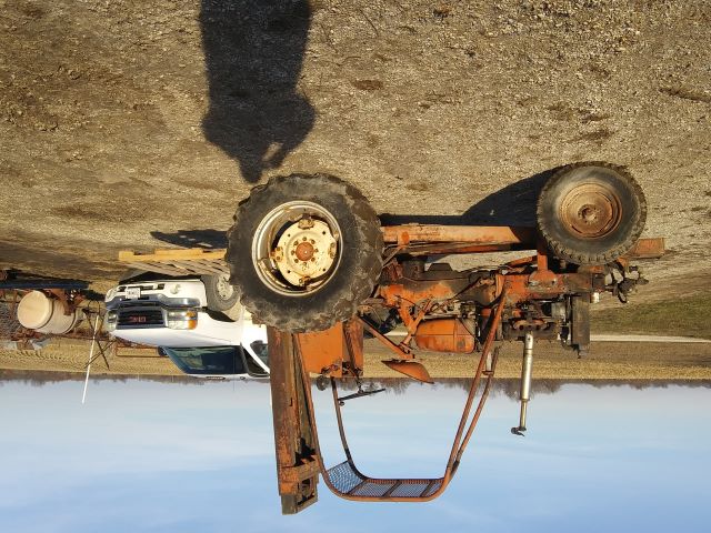

Well I got the power steering working (sorta). The front casting is egg shaped so much that the steering arm is resting on the axle pin so it still doesn’t steer good. Looks like I will be taking the frontend off and putting a new bushing in. Is that cast iron or cast steel? What kind of rod would you use to weld with a stick welder?
Points: 22588
Post Options Post Options   Thanks (0) Thanks(0)   Quote DrAllis Quote  Post ReplyReply Direct Link To This Post Posted: 13 Jan 2024 at 6:15am
Can't tell you. I would use a light blue flux rod I call super-rod which is made for dissimilar metals like cast/cast steel. I always said I could weld wood to plastic using that rod. Not cheap but good stuff.  It never needs to be chipped off as it cleans itself when cooling.
Points: 89994
Post Options Post Options   Thanks (0) Thanks(0)   Quote steve(ill) Quote  Post ReplyReply Direct Link To This Post Posted: 13 Jan 2024 at 8:17am
the main problem welding on a casting is OIL contamination.. Wash it 4 times with solvent or gasoline, then do it again and wire brush.. Impregnated oil will be the welding problem.. Use your torch or propane bottle to warm up the area to 200 degrees.. That help bake off the oil, and "warm" cast welds much better.
