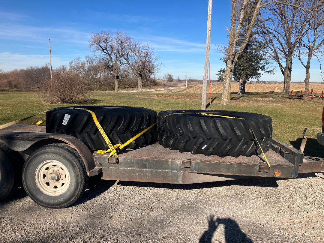

Do they need a pair of rims for 18.4 x 28's ?? I've got a pair.
Well, I don't know, you could give them a call. Hewitt tire, 641-259-2097, ask fort Steve.
I mentioned the 18.4's because I think some series's 4's had them and they are a hard size to find. I have lots of 16.9x28's around here, four tractors, one set of duals, may be a spare or two out there? All my 18.4's are 34's or 38's. Just brought home my first, (and probably only) set of 20.8x38"s.
