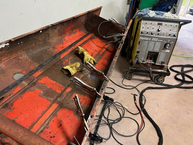

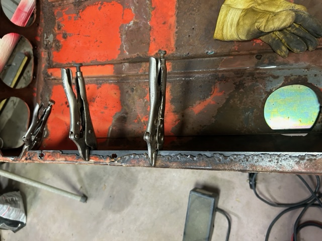

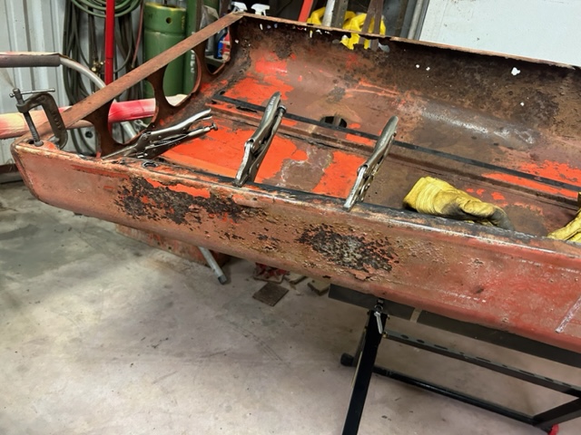

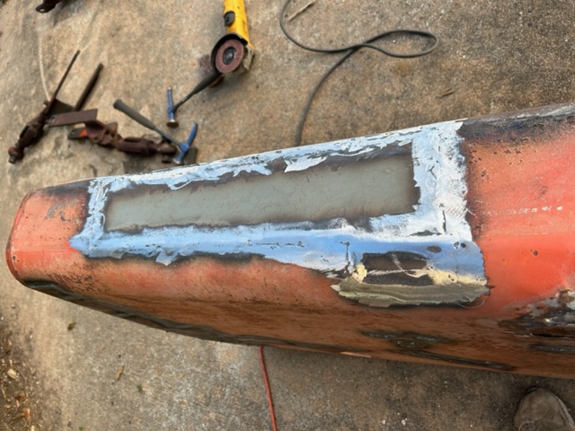

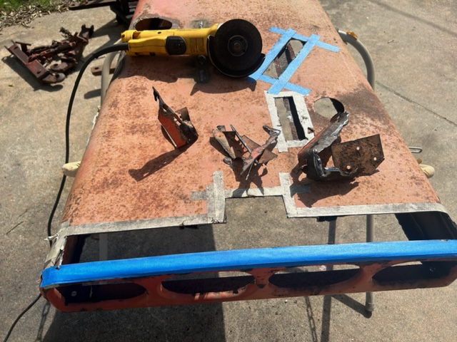

Here are some pictures of the hood with the new pieces tacked in.  Im not the best welder but I think it will work ok.  I didn't take any pictures of the fully welded piece yet.

I hope you're good at body work. I would have looked for a better used hood with the salvage yards I have around me.

That is ambitious. Those large flat panels will require extreme care to avoid warping. Good luck

Yes, I would love to have another hood and front grill.  Unfortunately there are no salvage yards down here.  We are about 50 miles from the coast and the climate is not kind to equipment.  The 190 sat outside all but the last 6 years or so and for about 10 years it was barely run.  I now have a place to keep it in an open ended building at least.  Also, there were not nearly as many Allis Chalmers tractors down here as up north.  I see a D17 around here every once in a while, and we still have one of Grandpa's but not any 190s.
I am doing my best to keep the warping down.  Fingers crossed....

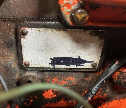

I checked the engine data plate yesterday evening.  If I am reading everything correctly.  The tractor is number 129 off the line and the engine is number 1231 (2D01231).

Points: 22799
Post Options Post Options   Thanks (0) Thanks(0)   Quote DrAllis Quote  Post ReplyReply Direct Link To This Post Posted: 02 Nov 2023 at 8:30am
Engine s/n's start at 1001, so it's pretty close, isn't it ??

Yes pretty close I think.  The tractor is 190 1129D and engine at 2D-01231 would put them 102 units apart.

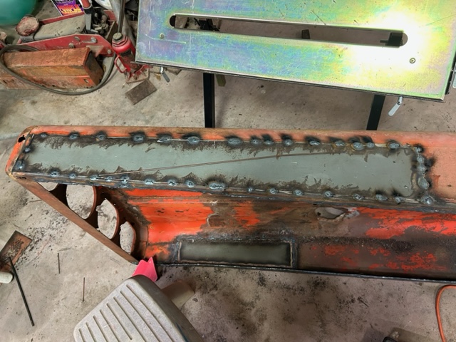

DPK11, try to spot weld your 190's sheet metal with your Heliarc welder. That is how Allis-Chalmers built them at their factory in 1964. Spot welds don't create excessive heat in sheet metal like a weld. So a spot weld usually will not warp the metal? Your Heliarc welder was popular during WWII era. It's spot weld capability improved our US airplanes build factory's previous riveting methods. Heliarc means it initially used Helium as a shield gas. Hence the name.
Here is a youtube link to a 2.5 minute video that demonstrates how to do that with a tig welder. fyi: There is no audio in the spot weld video, just captions.
Edit: Looking more closely at your previous photos that contain welds, makes me think you're inserting new sheet metal and butt welding old to new? If that's correct, try this technique of spot welding a butt joint by placing an additional "backing sheet metal strip" from behind (opposite/out of site) the new&old pieces. In your 190's hood case, maybe use a backing sheet that is 1-1.5" wider than new insert? That way it adds strength across both seams & will make this technique a little easier. The backing will add some more weight to the hood, but only you'll know its there. Assuming you're using 18-20 gauge sheet metal, then not much weight added. If you're using thicker like 16 gauge, just try to spot weld butt joint without any backing.
So if using a backing, place all 3 pieces of sheet metal in place(new butted to old/ laying over backing) spot weld the 3 pieces over the butt seam.  Then add additional spot welds on each surface pieces (old) (new) to their backing piece about an inch either side of the butt seam.
Here's another video "walking the cup" that shows tig 101 for beginners. It covers tig welding methods for thicker metal stock. Dude in the video does a great job of informing & demonstrating a tig's potential. You know you got one cool Heliarc welder - right?

Thanks for the tips. Yes on the side panels I am butt welding the new metal in.  I think it is either 16 or 18 gauge for the panels and the strips for the mounting holes on the bottom lip is 1/8".    I will try the backing and spot weld method on the top sheet metal.  So far it is coming out ok.  The welder is fairly new to me.  I got it a couple years ago.  I happened to see it on Craigs List and picked it up from a really nice guy in College Station TX. He owns a company that makes all the brass signs, emblems, paper weights ect for Texas A&M university.  He had purchased the welder new for a project but had no more need for it.  I got a smoking good deal on the welder.  He was asking $550 which was a great deal but when I handed him the cash he handed me $50 bucks back.  I had a lincoln square wave 175 before that I now gave to my brother.  I am no expert, but I do enjoy Tig welding more than any other process that I have tried.

If your environment is salty humid as your describe, then you may not want to use any backing panels as I mentioned earlier. To that end, my guess is that the OEM riveted support members under your 190's hood have somewhat more rust than areas not supported? If that is the case, then using a backing panel may only increase their area's surfaces for accumulated humidity to create more rust. Just keep spot or butt welding new pieces into hood as you've already done. Maybe try to "stitch" butts by doing consecutive spot welds along the butt seam, instead of welding seam. Remember, excessive heat is your enemy on sheet metal.
By the way, awesome purchase price on the Heliarc.

Yes definitely more rust on the sheet metal over the hat channels and front frame assembly.
I will keep doing the butt welding and plan to try and pour some rust treatment down the hat channels form the underside.  Watched the videos you suggested which led me down a rabbit hole on tig welding.  Learned I have not been paying nearly enough attention to the tungston shape, cleanliness etc.

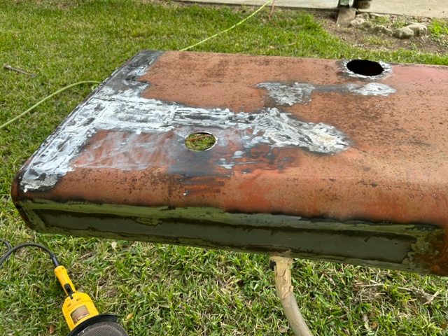

More progress on the hood this weekend.  After over 35 hours into it I have pretty much all the welding done.  Hit it with grinder and I am satisfied that its going to look ok when done.  I had a few warps here and there but a little work with body hammer and dolly and they came out pretty good.  Gave me a chance to use the hammer and dolly set that I have had for years and never used.  Actually purchased it years ago with the 190 in mind. I plan to try the aluminum reinforced filler on the weld seams and low spots.

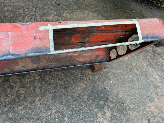

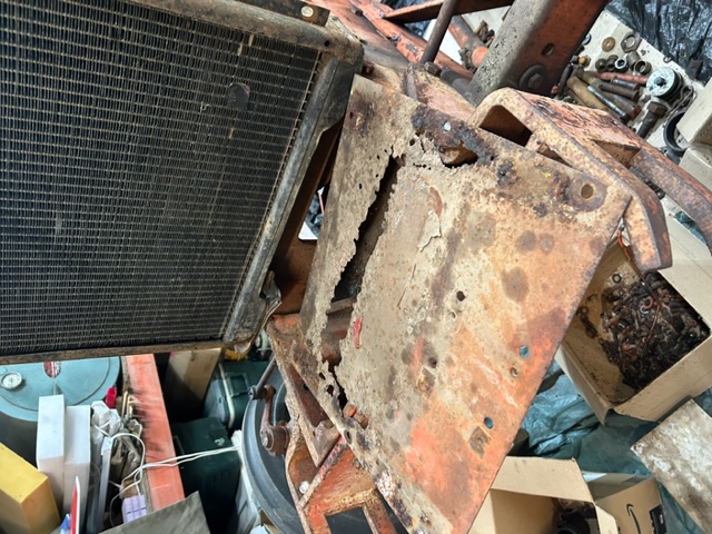

Made more progress.  Pulled the side panels and plate under radiator.  Pictures show badly rusted over the years.  I made a new bottom plate and have begun welding up new metal in the side panel radiator mounts.

You're welcome. Yes, the tig video guy does a good job highlighting pertinent  items. You've done a good job on the 190's hood restoration. When I initially viewed your previous under hood photos before your restoration, my first thought was your 190 had trashed its engine water pump at some point & during that process, perhaps the engine fan blew leaking coolant across the bottom of it's hood, making it rust quicker?  But then I guess your 190's engine fan just sucking/blowing your Gulf humid salty air non-stop across hood might do the same, probably even worse?

You are correct on all points.  The water pump has failed multiple times over the life of the tractor.  And it was run with a leaking water pump front seal more than once to finish a job.  Coolant (antifreeze) is supposed to be a rush inhibitor but my guess is that the fan spraying under the hood, then drying over time and possibly softening paint accelerated the rust in those areas.  The pattern of rust underneath definitely suggests that.  Thanks for the compliment on the hood.  My welds have improved through this process.  That is about par for me.  I do this type of work so infrequently that I forget most of what I learned before doing it again!

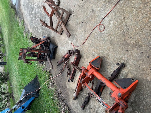

A tale of 3 hitches.  I am still making progress on the 190.  Most of the welding is done but I still have lots of work to do to smooth everything out.  After the suggestion of salvage yards, I did some searching and found a yard with a 190XT only 2.5 hours from me.  Pictures online looked awesome and the tach only shows 3559 hours.  Found out it was a tractor salvaged via the TERP program.  It looked very good in the pictures but unfortunately all the sheet metal, and engine was long gone.  TERP requires knocking holes in the block and cutting the frames.  Sad to see such a nice tractor destroyed.  All that was left was torque tube back.  I did get the 3 point hitch assembly, hydro valve stack, power director valve, and steering motor.  My 190 has the snap coupler system and grandpa installed the 3 point adapter in the picture.  The adapter was pretty wonky and not very stable.  It looks like it was designed to swing with the spring on the snap coupler so the traction booster would function with it.  When he was row cropping I remember grandpa having problems with too much side to side play so Dad tried welding the unit solid and adding mounting bolts up top.  This didn't work all that well and only stripped out the treads and broke bolts for the top mount.  More bracing was added which only broke again.  Grandpa quit row cropping and did all hay and only used the drawbar from about 1980 on.  I use the 190 mainly for box blading and 3 point shredder.  My plan is to install the 3 point unit and hopefully still use the snap coupler drawbar.  I am not sure if I will hook up the traction booster linkage to the 3 point or not.  The traction booster and depth limit levers have been frozen in the full down position as long as I can remember.  Also the spring block is installed on the coupler disabling the traction booster.  My plan is to see what I can make work again and go from there.
