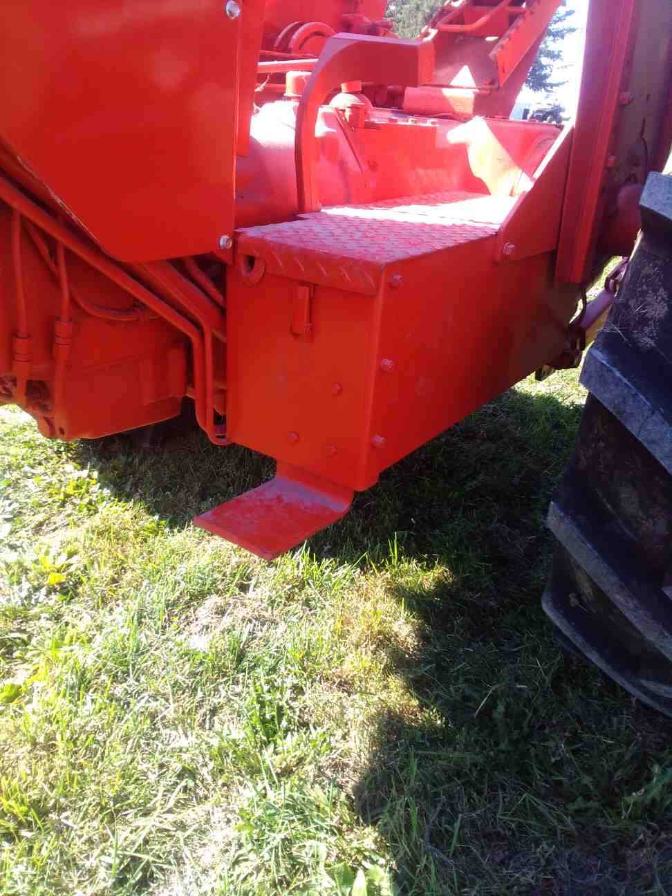

A few pics coming. Yes, we went into the display area.

Neat piece of history and thanks so much for the pictures. Curious how many hours are on it?
