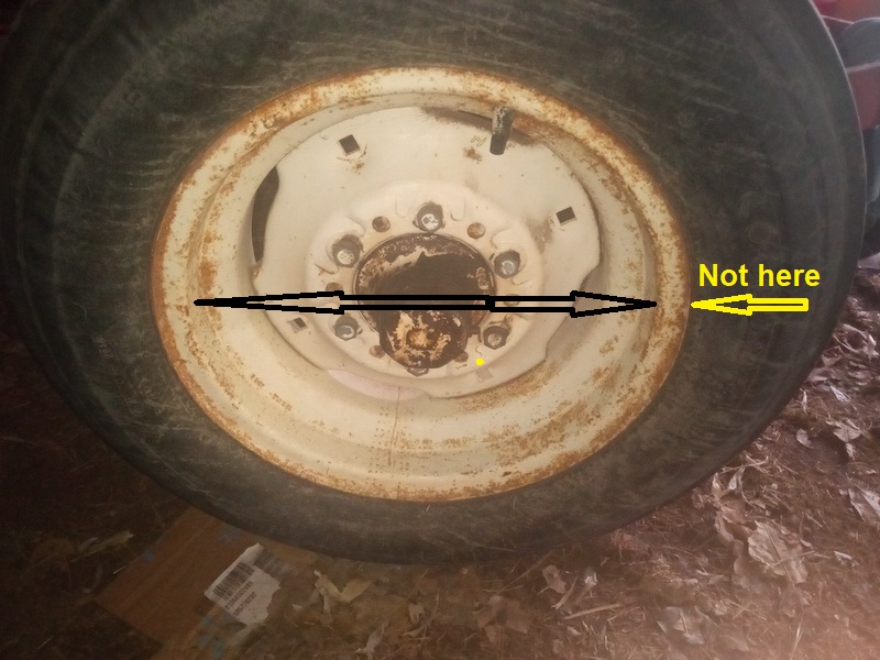

A 15inch tire isn't going to like seating up on a 16 inch rim.  Where are you measuring the rim?  The rim diameter is actually measured across the inside of the rim at the black arrow where the bead seats,  not across the outer lip of the rim.
rrhead(SD) View Drop Down
Location: Canton, SD
Points: 438
Post Options Post Options   Thanks (0) Thanks(0)   Quote rrhead(SD) Quote  Post ReplyReply Direct Link To This Post Posted: 28 Jul 2023 at 6:09pm
That does measure 15 inches. Wasn't sure where to measure. That must mean they have been changed at sometime. Thank you very much for the info. rrhead(SD).
