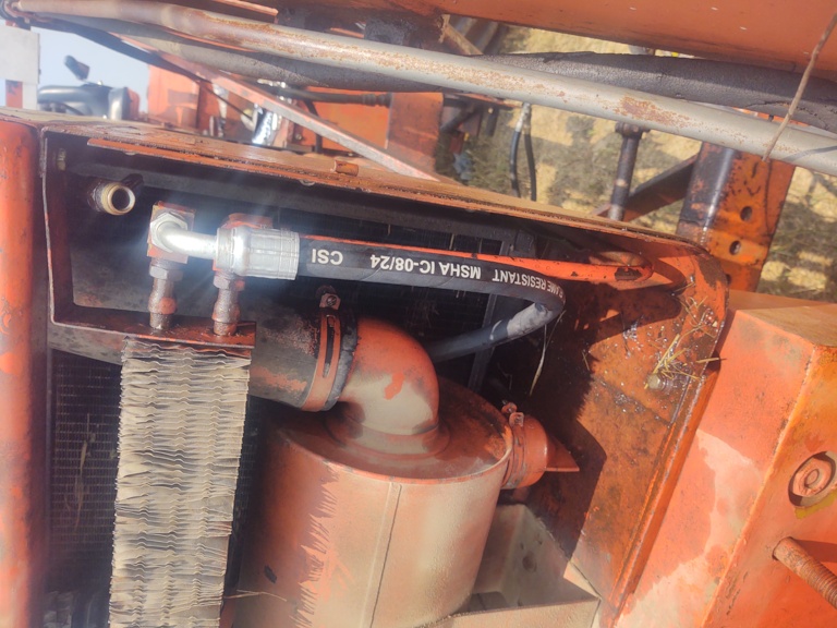

The top steel hydraulic line going out of the oil cooler and into the steering column developed a leak (by rubbing against the bracket above the radiator) and I thought I would document for others the options that I discovered to fix it.  I called Agco and they did not have the steel line but said they could get it from a 3rd party source.  Unfortunately, I needed to get the tractor operational immediately and couldn't wait 3 days for it's delivery.  The 90 degree brass coupler attached to the oil cooler that the steel line (with a flare) screwed into has a non-standard hydraulic fitting.  I went to Oreillys and they didn't have anything.  I went John Deere and they didn't have anything.  Turns out that my Agco dealer had what he referred to as "Oliver" fittings so he made a 7 foot hose to get me operational and I bypassed the steel line.  The "Oliver" fitting used was a crimp on 90 degree so not something from the 1970s.  These fittings were just laying in his drawer loose so no identification.
The tech didn't know the official name of the "Oliver" fitting style.  On the other end, I had a JIC fitting so that was easy.  Curious if anyone knows what that style of fitting is actually called for future reference?    My internet search hasn't produced anything.
To make it easy on me to tighten the connection, I pointed the 90 degree out.  I am going to remove and point it inward so I can put on back the nose grill.  The steel line hasn't been removed yet as can be seen in the picture.  I ran the rubber hose over the top of the radiator for now.  The area where the steel line runs beside the radiator is limited in size so not sure how that is going to fit without buying the steel line.  I am guessing a rubber coated clamp is better in the long run to avoid the hole again.  Looks like I need to remove the hood to see what I am doing on the final repair.
Are there better ways to fix this in the long run?  What have others done in this situation?

I have areally good welder in our neighborhood that welds hole in steel line for me. He has a special dye he can put on the line to test for leaks. I have one on my 190 now that drips by the hydraulic pump I need to take to him. Took 50 years for that leak fix it and be good another 50.

There are some steel lines on some tractors here that have been brazed. I plan to do that to a coolant bypass line on the WD project

Had a line on a 190 that went to the hydraulics and it split right on the 90 degree bend back by the flywheel area.  Lit up the torch and brazed it shut some 30+ years ago.
  Brazed up other lines over the years too, even an injector line on a d17 diesel.

I,m thinking just work the old one out and get some tubing a flare tool and make a new one- but have seen a few with this hose setup working good

Have brazed a lot of hydraulic lines over the years with good success.           MACK

I have had good luck with both brazing lines and bending new ones.
I would not use brass fittings on a hydraulic system - they do not like pressures that high.

The brass fittings I refer to look to be original equipment.  They had orange paint on them and require the "oliver" fitting.
I noticed no one has commented on what an "Oliver" fitting is really called.
Going to pickup the metal hydraulic line later this week from Agco that I bought to see if it will fit.
I have never brazed anything so not sure what kind of luck I would have.

I always called Oliver fittings (antique ).  And AC used some.                      MACK

i have a parker tubing bender that i can bend 1/4 to 1 1/4 tubing to .080 wall and do the 37 degree flares for the jic fittings  the hardest part for me is getting the tubing that i need when i need it

Find a neighbor that can still braze, it's quick & simple repair on steel tube.

A local hydraulic shop can braze your line pretty cheap if you are not comfortable trying that.

Can you show us a picture of the "oliver" fitting?

"Inverted flare fitting".

Inverted flares are used often in the automotive world. Hydraulic brake connections are but one usage of them.
Never have heard the term "Oliver Fitting" and must be along the lines of the generic term "Band-Aid".
