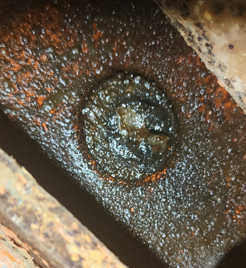

Hello,
I have a 1953 WD that has a transmission full of milky oil. Its not gear oil and I would like to get all of it out.
The middle drain plug is busted in the hole. Should I try to remove it? If so, how? Any ideas? I think I'm going to try to chisel the edges, make a notch and hope that a hammer persuades it to bust loose.
I thought that if I parked the rear end up a hill the oil might run down into the pto and drain out there, it did not.
Then I tried the front end up a hill, the oil did not run out the rear.
Doesn't the whole transmission share the same oil other than the hydraulic cavity?
Thanks in advance for any ideas.
Will
Southeast PA.

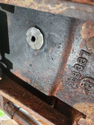

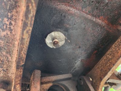

Post Options Post Options   Thanks (0) Thanks(0)   Quote acisbest Quote  Post ReplyReply Direct Link To This Post Posted: 10 Jul 2023 at 1:37pm
Tried to weld a washer to the drain plug, then I welded a nut on the washer. Water started leaking out of the plug so the heat must have opened things up. Waited a few hours to let everything drain.
Put a wrench on the nut and it fell off. So, I was not able to get good penetration. Tried about three other times, could not get a good weld on it.
So, decided to drill it out and pipe thread it. Only about 1/8 of thread but I think it will hold.  Good enough for a tractor I use about 1 to 2 hours a year.
Points: 88565
Post Options Post Options   Thanks (0) Thanks(0)   Quote steve(ill) Quote  Post ReplyReply Direct Link To This Post Posted: 10 Jul 2023 at 3:06pm
plug was probably cast iron... That dont weld so good... OLD rusted out cast iron is even worse... Most of them plugs are HOLLOW on the inside.. If you have problems with the threads, drill out to a 3/8 pipe and rethread.. Probably be thicker metal the further out into the old plug you go.
Edited by steve(ill) - 10 Jul 2023 at 3:08pm
