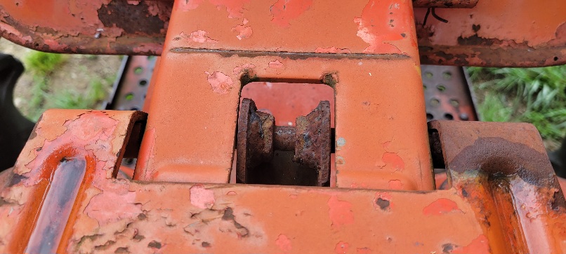

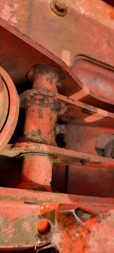

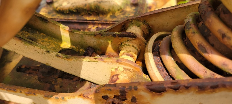

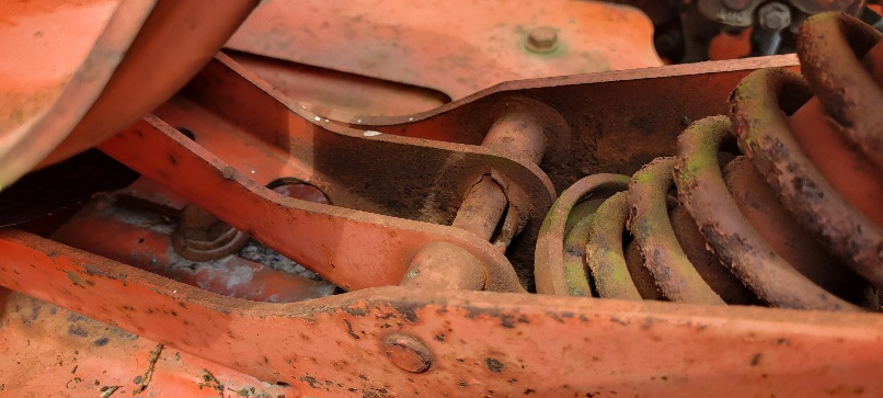

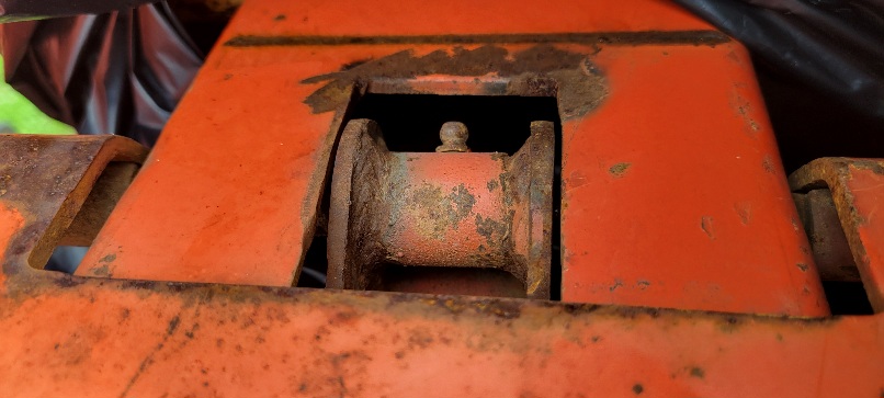

My gripe for the day !!
Never had a seat assembly that bottom pivot wasn't worn thru or almost threw the bushings.
That is if the tractor has more than 1000 hours on it or someone hasn't already repaired it.
You can't even replace the shock assembly without removing bottom pivot pin and that is not a simple task.
here are 4 different seat assemblys currenly in use...
Yellow tractor has less than 1000 hours
Edited by Macon Rounds - 07 Jul 2023 at 10:59am

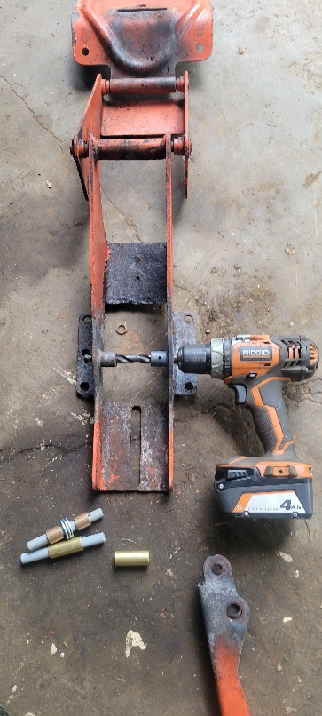

I replace those two bronze bushings with a steel pipe/bushing stock. This allows a damaged hole to be repaired by welding one piece of pipe where two bronze bushings were before. Drill a small hole in the top center so it can be oiled. Never attempt to remove those small roll pins. Lay the suspension in its side on a pipe and with a 4 lb hammer and 7/16" punch drive the pin downward shearing off the roll pin. Easy ?? Not bad when you have a solid bench and proper pipe and blocking. I can't hit as hard as 40 years ago but 6 or 7 good whacks usually gets it.
Macon Rounds View Drop Down
Joined: 18 Feb 2010
Location: Pittsburgh Pa
Points: 2269
Post Options Post Options   Thanks (0) Thanks(0)   Quote Macon Rounds Quote  Post ReplyReply Direct Link To This Post Posted: 07 Jul 2023 at 11:42am
Yep
drilling those roll pins is a waist of time.
Pounding out is the way !!
Usually lay it up on the anvil "with a helper" and still get it glowing red. And 4 # works well...
I did this one by myself, yea.... not a pretty site.
Heating it up and chasing it around the garage floor.
Grrrrr !!!!
if you can see on the floor I manufactured some longer brass bushings. I do drill a hole for oil and have even put grease fitting in them. longer bushings keep them from migrating out or I have just put washers between the factory bushings....
The ones I have repaired should never need replaced again, except for the shock. And the next repair man will thank me.
I use antiseze ...
