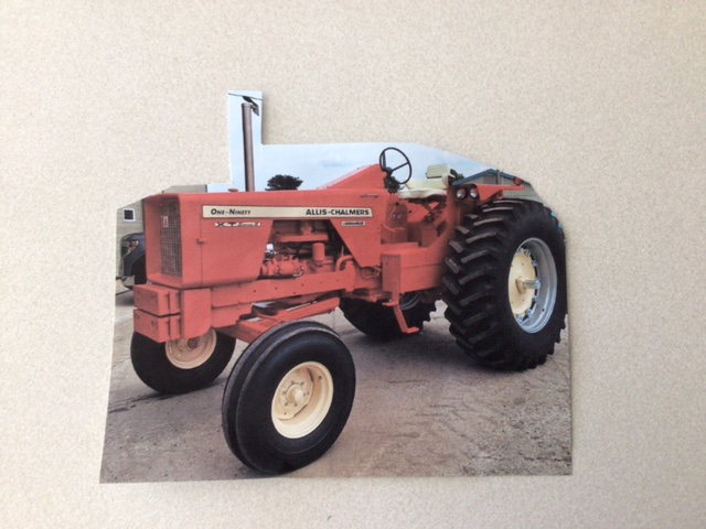

   Good afternoon. I am referring to 'OPEN STATIONS' only (no cabs).
This picture shows our friends tractor. It is identical to mine. Both have very close serial no's. Again, they are 190 XT - III.

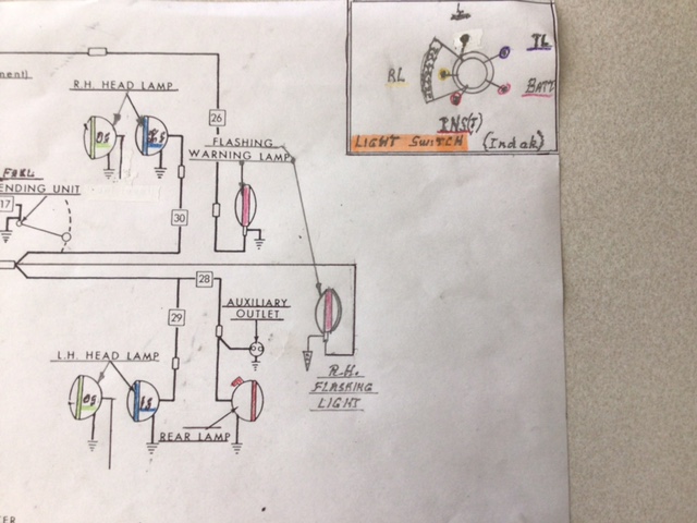

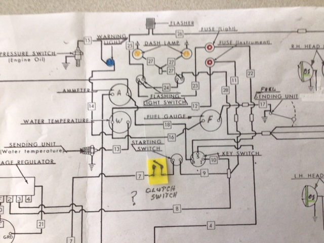

   Please find below, two sketches of the frustration areas.
   Any help with a correct, complete set of schematics would be appreciated, especially the wiring behind the dash.

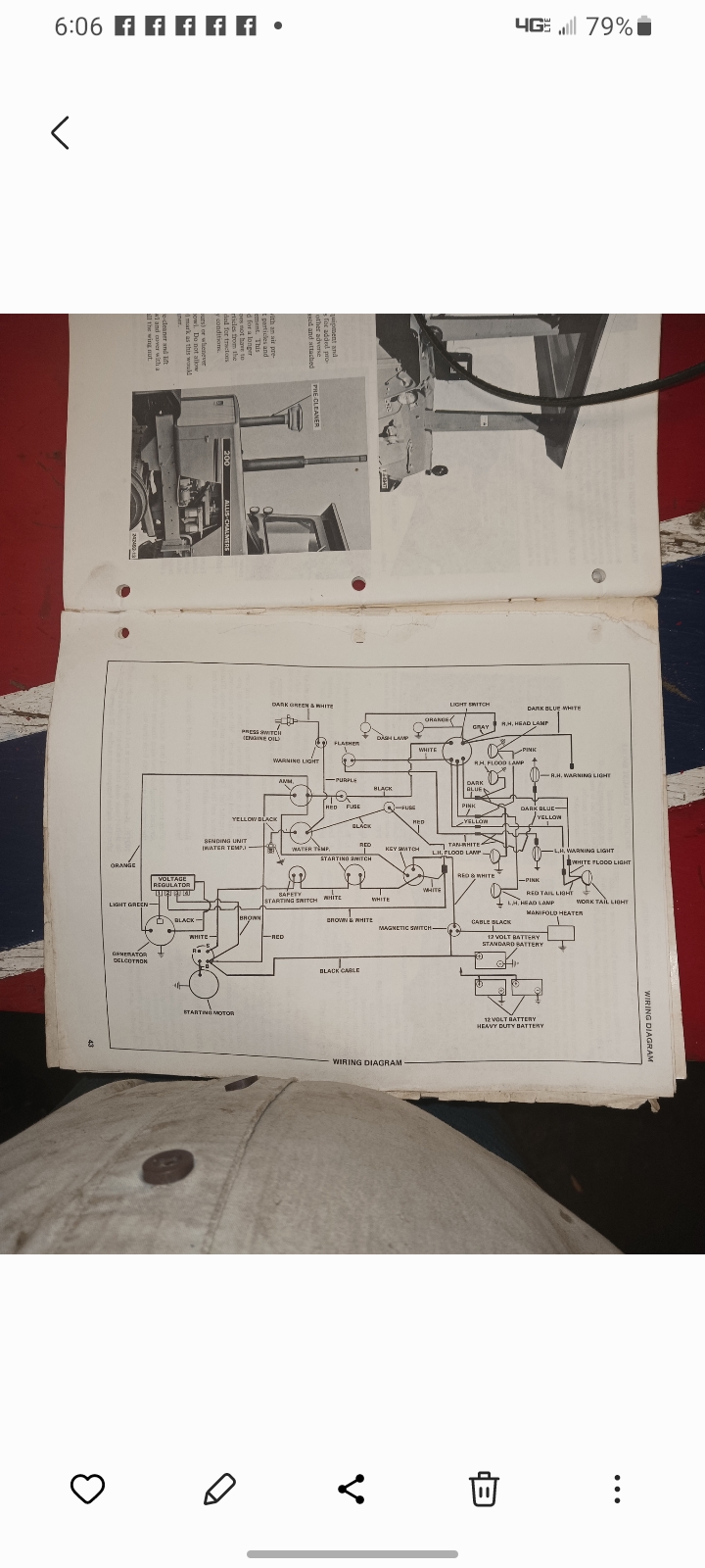

OK, I looked at my 200 manuals and compared to a 190 manual I have and the wiring diagram looks the same for each. Only difference was if the 200 had the factory cab. That a slightly different diagram.The 190 manual I have is for a series III.

Post Options Post Options   Thanks (0) Thanks(0)   Quote Lonn Quote  Post ReplyReply Direct Link To This Post Posted: 13 Jul 2023 at 9:33pm
From my 200 manual. Early 200. I hope you can see it. Took me a long time to figure out how to post a picture from my phone.

Post Options Post Options   Thanks (0) Thanks(0)   Quote Ross D. Quote  Post ReplyReply Direct Link To This Post Posted: 14 Jul 2023 at 6:26am
   Hi Lonn.   This drawing initially looks good. I have been away from the project for the last 3 days. I will be back at it today. This appears to have exactly what I need.
   I appreciate that you have been able to send it to me.
