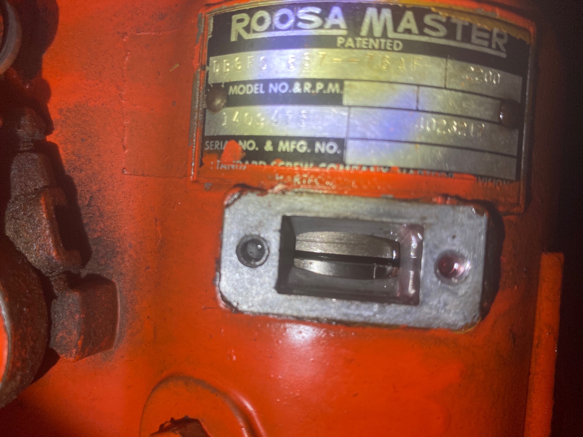

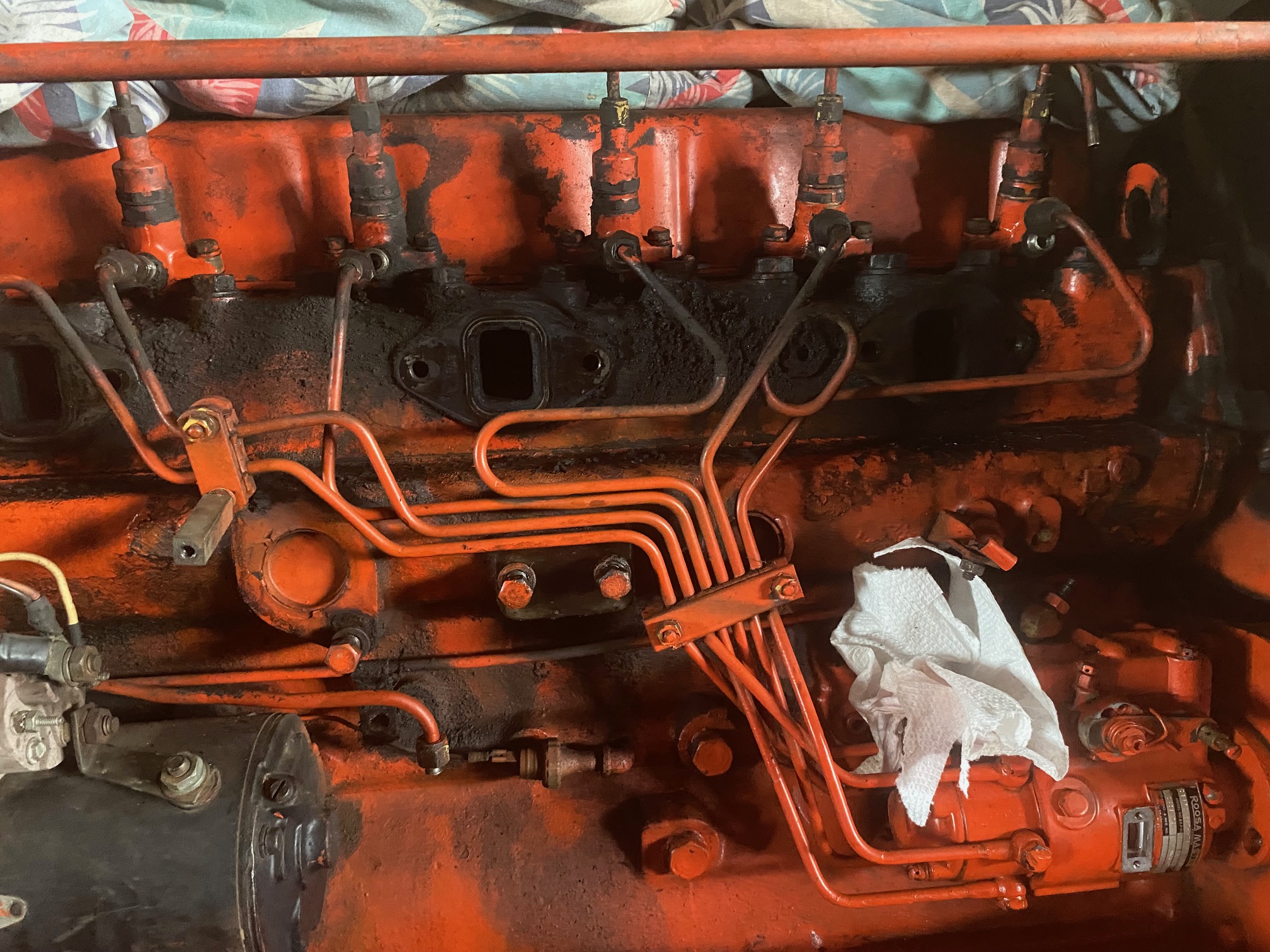

Thank the Lord for Dr Allis’ way for the 185’s injection pump removal! It’s a way better way Than tackling those banjo bolts. Plus…when I went to remove the exhaust manifold I was shocked that 5of the 6 anchor bolts were loose! I’ll have the lines in the window lined up perfectly when I pull the pump out in the morning. My question is….can I pull the pump with those lines lined up not knowing if I’m at #1 TDC??? Or do I need them lined up after proving I have #1 iat TDC? ?? Thanks. Dana

You don't even need to align ANY timing marks. Scribe a line on the pump's mounting flange to the engine's front plate so you KNOW EXACTLY where the pump was positioned rotationally. Pull the pump back and off and make note of the driveshaft flat tang "DOT" and the "DOT" inside the pump's drive socket when you pull it off. Re-install the pump dot to dot and align your scribe mark and it is exactly timed where it was before. Leave all banjo bolts just snug and do the same to any line clamps. Get everything reconnected, leave one injector line started but loose and tighten everything else. Bleed and fire it up. Don't roll the first umbrella seal on the driveshaft!! Lots of light lube is your friend. Get the pump slid on and pull the pump back and forth a couple ot times, not letting the umbrella seal escape the tube.

She’s scribed and thank you. I guess my confusion always starts here…the drive shaft is hooked to the gear drivers and can not be turned by fingers correct? So when my pump returns if the slot inside pump doesn’t exactly fit dot to dot I’d have to turn inside the pump so they’d fit together right? As usual my fear is if they are say 90* to each other which way I would turn the socket inside pump? I have r&r’d 3 pumps and it’s NEVER gone correctly. Those 3 turned into like 9!! Thanks for your expertise and patience.   BTW Happy and SAFE 4th to you all. Dana

Driveshaft on the engine cannot be turned. If the socket inside the pump isn't positioned correctly, stick a CLEAN large flat blade screwdriver carefully inside the hole and turn it where it needs to be.
