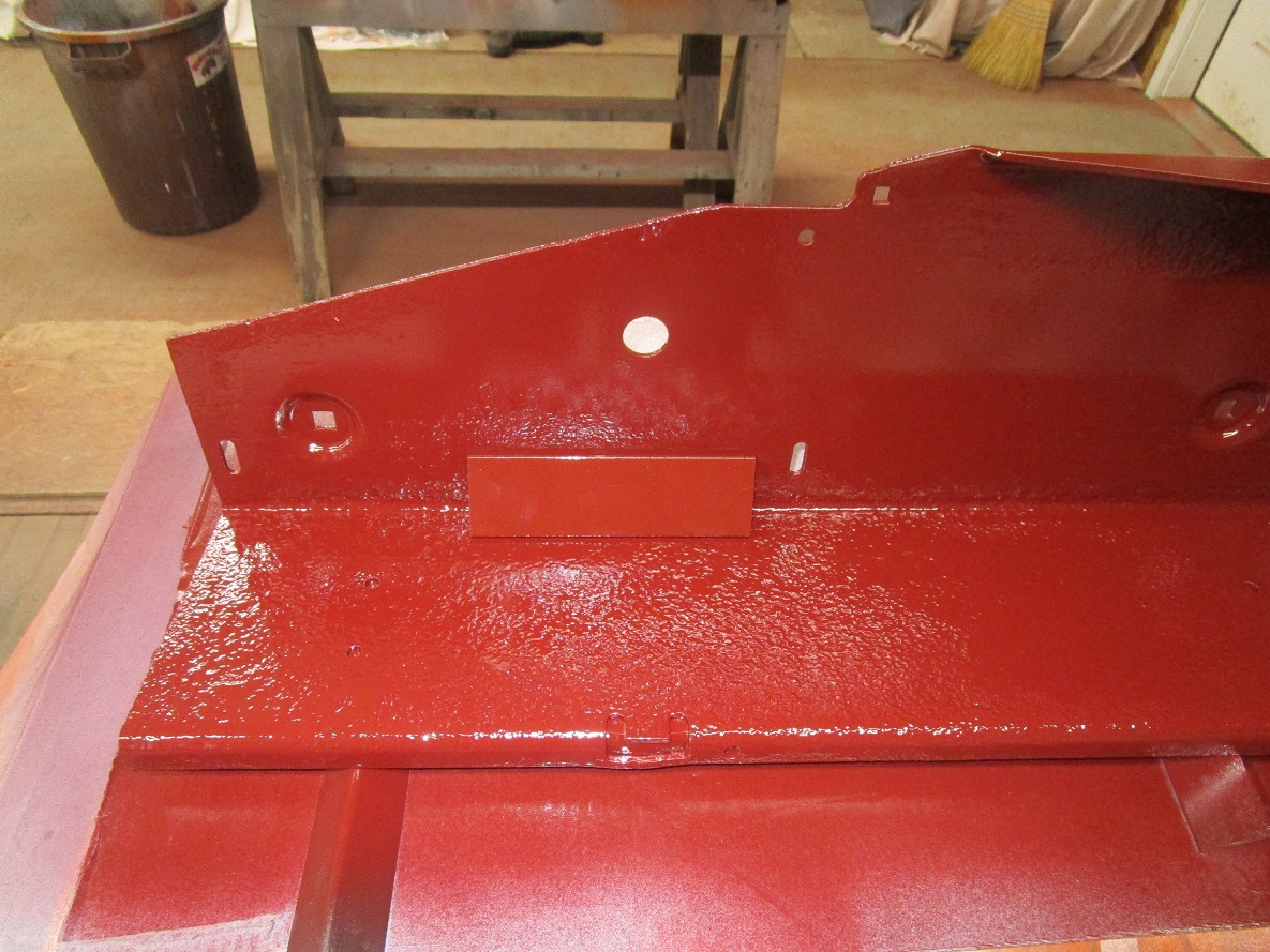

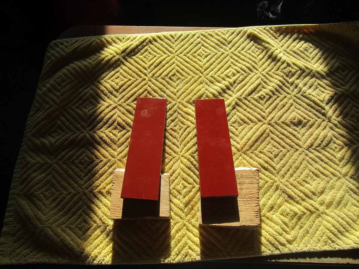

I'm redoing the battery box in my 7000. So I prepped and painted a piece of steel with Agco maroon from a rattle can. Had it scanned, and the closet it found was BMW oak red. When I painted the box, I also did another piece of steel. The oak red is real close, but a little brighter. In the first picture Agco paint is on the left, and its in the third picture. I'd really like to get closer to the factory color. But I need someone who knows paint say, yes you need less high strength red. But how much, and are the numbers after high strength red in grams. Note this is MTK paint. Had them mix me a pint, $45.
