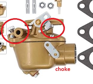

I dont know what carb you have... but "generically"... the circle on the left is the mixture screw ( to set full throttle / good running)... and the circle on the RIGHT  has a screw that pushs on the throttle rod and OPENS the plate to increase idle speed.... The CHOKE is the bottom plate.

I'm confused as well...I've gotta have something going on. I'll try and get some pictures and maybe a video if I can get that to work on here.
I was adjusting the jet screw, the idle stop screw that would hold the throttle plate open is backed off so it doesn't touch the stop at all.
