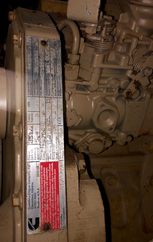

If its of any interest, here's a copy of my 89' cummins 5.9L ve pump 180 hp engine ID tag. This engine is awaiting similar fate as yours. Hoping for an AC 80xx tractor donor for it.
