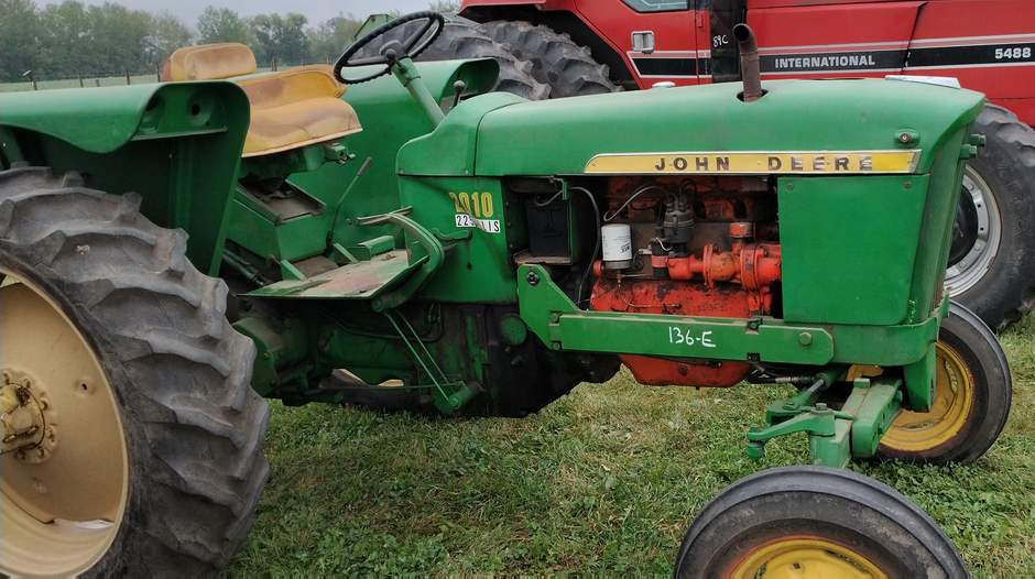

Had to laugh at this upgraded tractor. Looks like a good fit.

Needed a little pep in its step evidently...

I can see where that would piss off a million people !  Clap   Clap
wonder what it takes to adapt the bell housing / clutch .

Maybe not. Any honest John Deere lover will tell you the 2010 gas engine was probably one of the worst engines ever built by anyone !!!  All four wet sleeves were attached to a thick deck plate that sat on top of the block. Known for leaks and head gasket issues and you cannot replace one sleeve...all four is the only way. Truly an idiots design.

I hated those little sh!ts. Worked for three different people that had them.

When you see stuff like this, makes you want to be a fly on the wall of that shop. Beers being drank. What you think was wrong with the poor allis that they robbed the engine from.

Calcium ate the rims.

Any one want to try replicating that. I have a nice industrial 2010 with a working back hoe.
