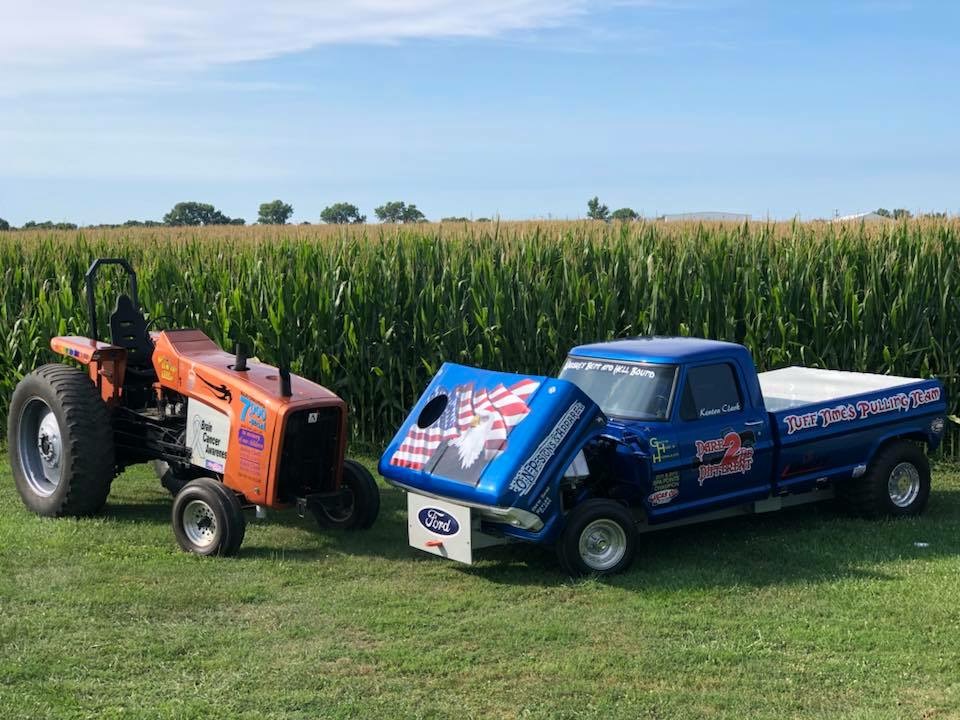

I’ve been running a 1980 black belly for the last eight 8 years I’ve done a lot of changing inside of my transmission tried to upload a picture but it wouldn’t

If I remember, this one has a 5.9 Cummins which does a great job !

Yep 5.9
Blew up 2 301 motors
