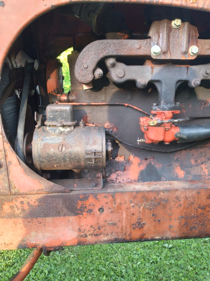

I have a '52 WD barn find I've brought back to life over the last several months. Things have gone very well. But I'm in the final stretch with this tractor and I can't get consistent RPMs for a given throttle setting. Changes without pattern. The carb was rebuilt with the major rebuild kit. Parts washer,USC,bead blasted and USCed again before assembly. Throttle linkage has full range of motion. Linkage? Governor?Spring? I'm stumped.
It does seem to be load related. I was jockeying a manure spreader around and it seemed to be worse.

I followed the directions in the manual setting the linkage it did wonders for my throttle stability. The belcrank under the has tank usually has lost of wear and the spring is important. Dis onnet the rods and check for freedom of movement at yhe governor. He last strp is to slightly bend the rod that goes back to the catb so it just barely goes into the hole on the govener lever.
Points: 22149
Post Options Post Options   Thanks (1) Thanks(1)   Quote DrAllis Quote  Post ReplyReply Direct Link To This Post Posted: 30 May 2022 at 3:18pm
Synchronize the governor to the carburetor first !!   Engine OFF. Hand throttle wide-open. Disconnect the governor link rod behind the generator from the vertical governor arm. When you slide the link rod out of the arms hole, the vertical arm should NOT MOVE one bit. If the link rod is too long, put a bend in it in the middle to make it shorter so it will just fit. 1/8" too long is huge.  Secondly, the throttle shaft on the carburetor cannot have any bind/drag on it. It has to be very free to move. Also, the cotter pin on the carb end of the link rod needs to be cut off short and wind it around tightly so it cannot interfere with linkage movement, because it can rub on the carb if installed sloppily.

Definately to long by 1/4"! The new throttle assembly must clocked off counter clockwise.
So do I throw the bend up or down?

Well, I didn't. The amount of deflection required would have fouled the throttle linkage. I had to remove it and put it in the vice. They must have used high tensile steel in that link. Works now. PTO doesn't affect it. Just pulled an 8% grade with an IH 155 spreader(empty). Second gear no drama.

Technically, there is a tool to slide down on the vertical arm and bend it forward or backwards.  Not having the correct tool might damage the cross linkage which is bad. Putting a kink (or two) in the link rod accomplishes the same thing and easier to do.
