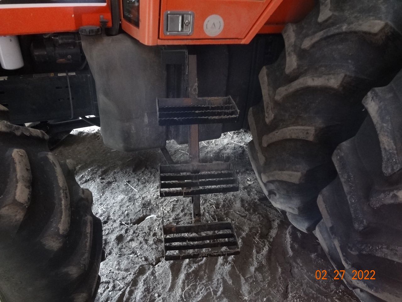

20.8x42 on the back and leave that 18.4 on the front. It will be straight!
Then mount 3 steps.

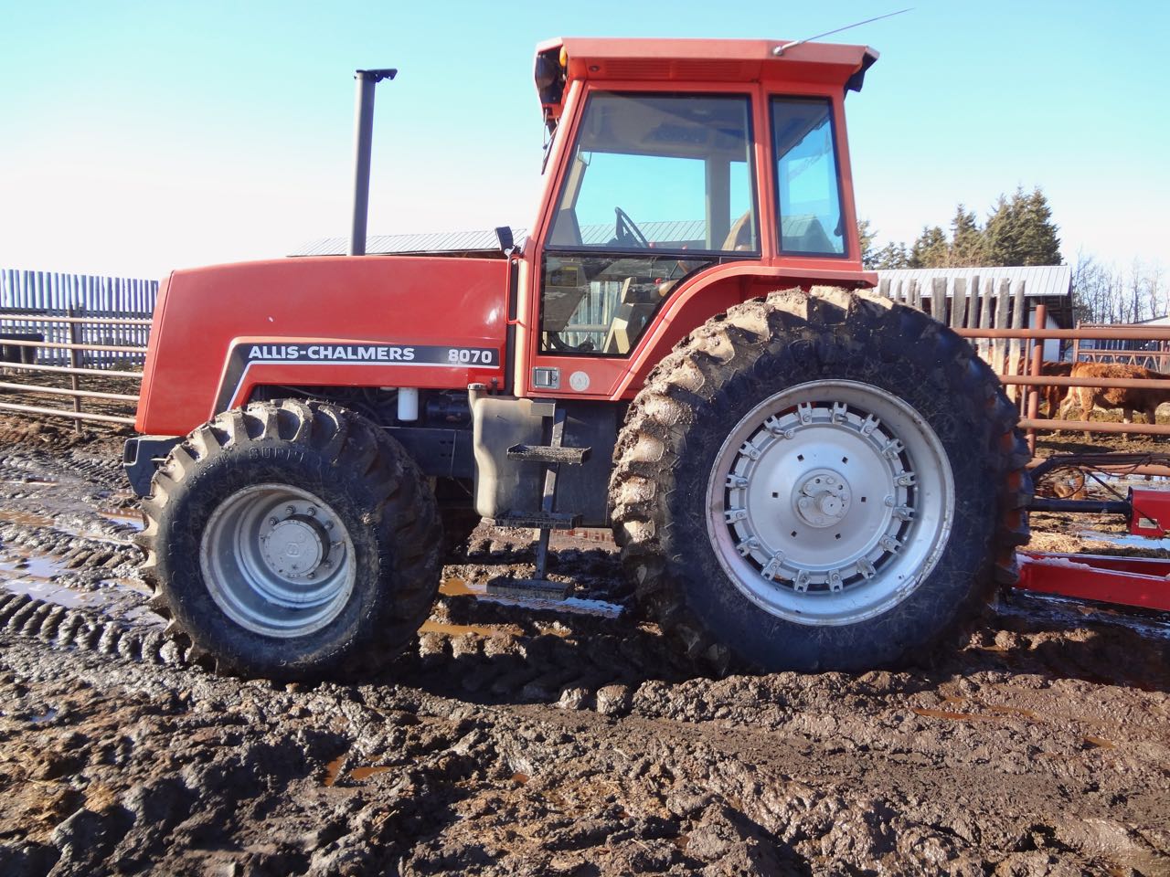

Ron(AB) Thats a great looking 8070.

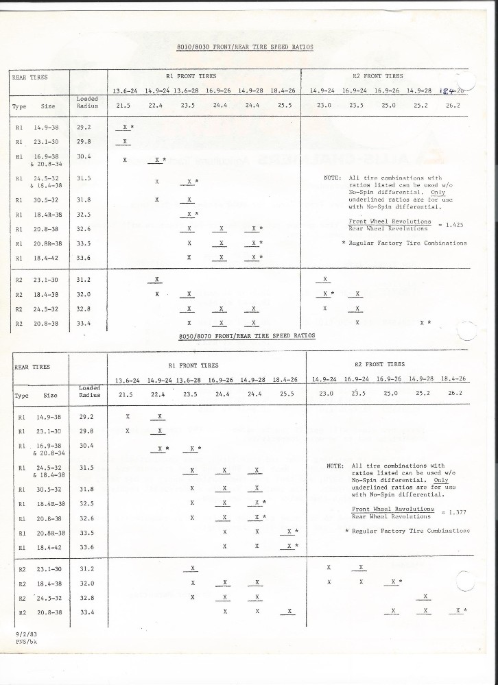

Note that radials are different heights.   They are taller.
I have bias front 10 ply and radial rears.
If you look at Lynn's tire chart, radials are specifically noted with a "R".
That's why my tire combination works
405, 7000, 7050, 8050, 8070, L3, 2300 & 2600 disk

Our 8050 has 20.8R 38s on the back, and 18.4R-26 firestone fwa tires on the front. They are to big. They are slipping constantly, even with no load. Tractor sits with it's nose up like you said. They say 16.9s can be put on the same rims that the 18.4s are on, but we have not done that yet because the old tires are still going. Some have 14.9-28s on the front, and I think they are a little smaller in circumference than the 18.4-26s. Just my penny's worth.
