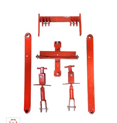

Post Options Post Options   Thanks (0) Thanks(0)   Quote steve(ill) Quote  Post ReplyReply Direct Link To This Post Posted: 15 May 2022 at 7:00pm
there are a couple different "generic" designs for 3 point adaptors for the ALLIS tractors.
The first is a VEE shaped lower arms with the bail built into the end that replaces your present drawbar... and two arms that connect up to your lift arms... you still need a TOP LINK for the 3 point.
Second type is a bracket that bolts to the tractor  / drawbar and then has two individual lower links that pin to it... and again two arms that connect to your lift arms.
Points: 21833
Post Options Post Options   Thanks (0) Thanks(0)   Quote DrAllis Quote  Post ReplyReply Direct Link To This Post Posted: 15 May 2022 at 7:09pm
The second (lower) picture requires the OEM drawbar bail, which this tractor doesn't have.

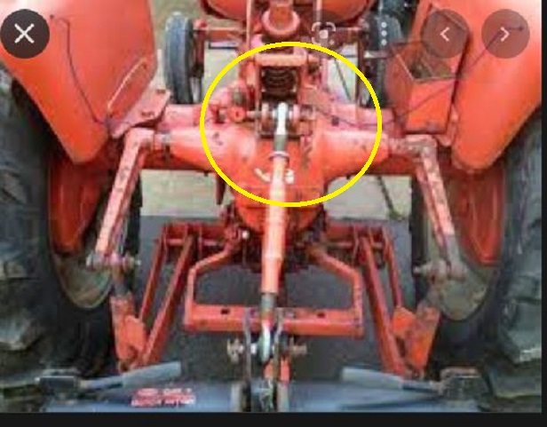

Post Options Post Options   Thanks (0) Thanks(0)   Quote steve(ill) Quote  Post ReplyReply Direct Link To This Post Posted: 15 May 2022 at 8:58pm
If I went with the VEE shaped kit would that include everything I need to get me to the point where I could use standard 3 point hitch accessories?
Jason.. you want a 3 POINT HITCH.. look at the picture and you can see the lower two arms that are lifted by your UPPER HYDRAULIC arms on the tractor... You are STILL MISSING the upper link or the 3RD ARM for the 3 POINT...  that is normally an adjustable link that is attached to a BRACKET above the pto housing near the back of the seat.. Couple different ways to "make that".
