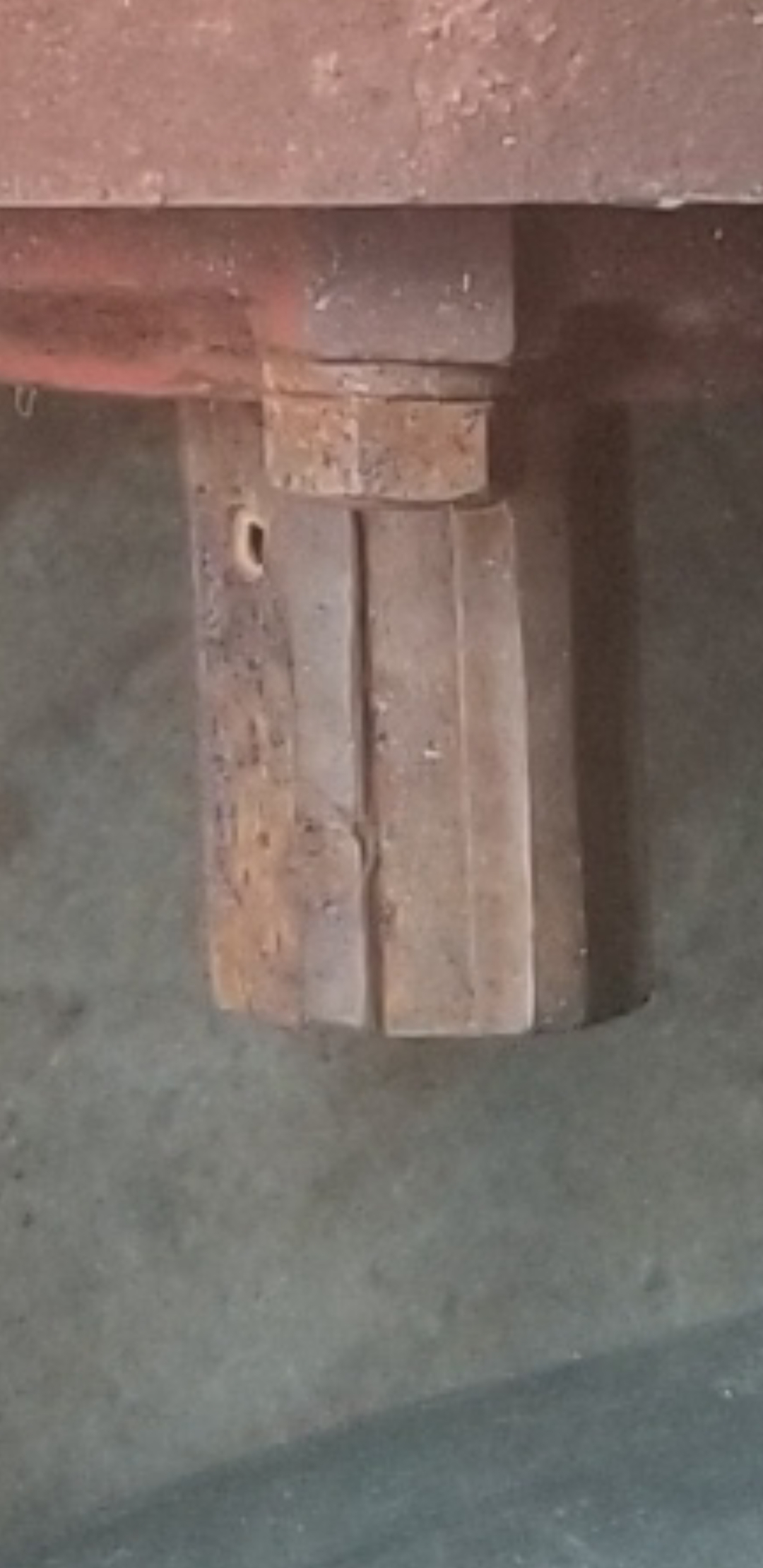

I got a trans with good gears, but most everything else seems to be junk (cracked case, rusty/pitted bearings, worn input shaft).
The main shaft input splines are well worn - 1/2 gone wear edges.
Are the splines heat treated?
If not, I plan to weld them up, turn the o.d. down to spec, and cut in new splines.
At first glance, the CA and B seem to use the same mainshaft. Anyone know (verify common part # CA seems to be 70225410 and C is 76111242)? I may have a good B shaft.
Thanks

I bought a B that had the tapered spline bull Axle damaged when the cast steel hub was loose and wobbled around on it... I welded up the axle, turned the taper back on the lathe, then recut the splines with a hand grinder wheel...I tried to fix the hub but it came loose about once a year. I finally bought a good HUB and works great on the repaired axle.
My point is the Shaft was not real hard as it was worn by the cast steel HUB.. Harder than a grade 2 bolt, but not like a grade 8. ......... I would think the trans shaft was similar..

I tried the weld and angle grinder method on a garden tractor and got similar results.
Now I have a milling machine and indexer to go with my 36" metal lathe.
Edited by KMAG - 22 Mar 2022 at 2:50pm

I'd look for a good used shaft.
The amount of time welding it up and machining it back will be monumental! Getting the geometry right on those splines won't be easy! You might be able to find a 'gear-cutter' with the right profile, that would help a bunch. Even then getting it indexed correctly every time will be a challenge. It would be a tricky machining project for even very experienced persons.
