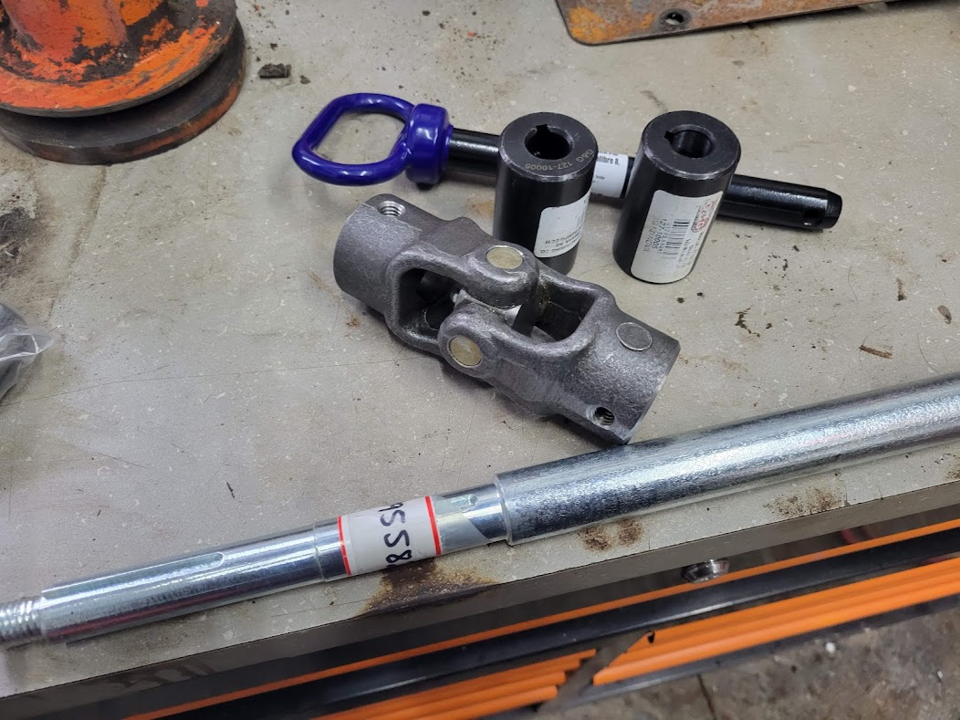

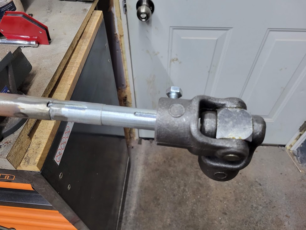

The trouble spots to overcome to fit into these tractors:
  1. splines on EPS is 16.5MM - 36 spline. (larger than 5/8" but smaller than 3/4")
  2. steering shaft is 7/8" in diameter from the steering wheel to u-joint and 1" after that.
  3. it draws A LOT of power. 12V 60A
  4. it fits in the frame below the front crank pulley (gas models) but needs custom brackets to work. = fabrication required.
I have purchased the following components:
5/8" coupler ( one needed, I bought 2 for trials)
3/4" keyed steering u-joint
Go Kart Axle - Steps down from 1" to 7/8" to 3/4" keyed.
tie rod boot for water seal on input to unit.
50A circuit breaker
10AWG wire (enough to go back to the battery box)
Bruno Steering EPS controller (to trick the ECU into providing feedback)
You will also need 3/16" (roughly 6"x6") plate steel and 2x2 or 1x1 angle iron (1 ft) to complete the fabrication.
Since i am changing U-joint sizes, I had to adapt the steering shaft to 3/4" which involved shortening the original shaft by about 5.625" to fit this adapter. I Used the Go-Kart axle for this, Cut the threads off the end and cut the correct length off the shaft. Next will be to weld it to the steering shaft for a perfect fit length wise, and a nice tapered step down to 3/4" for the new u-joint.
Edited by Jtaylor - 20 Apr 2022 at 7:02am

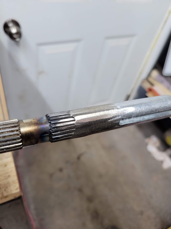

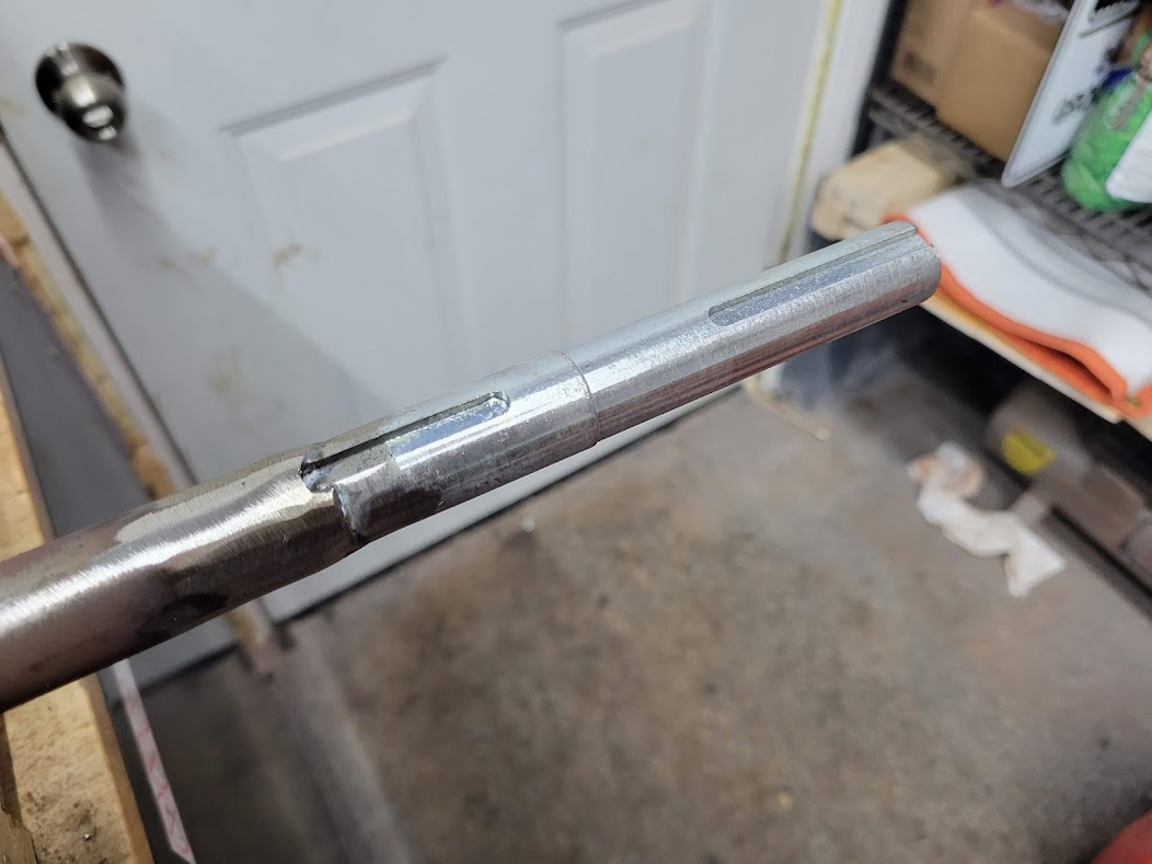

I was able to get the keyed shaft welded to the new steering shaft. cleaned the welds up and test fit the u-joint.

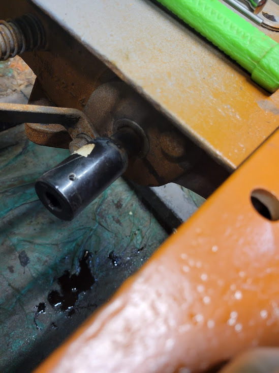

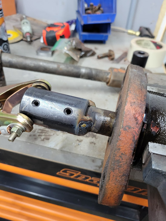

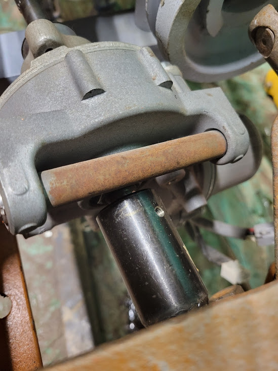

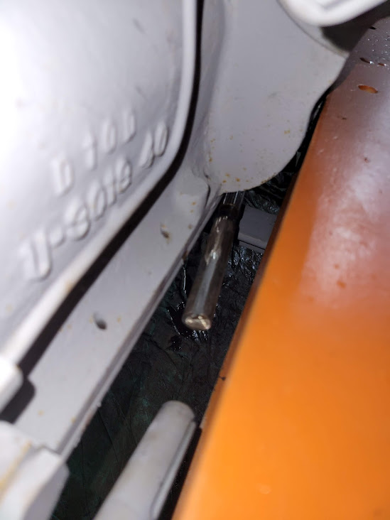

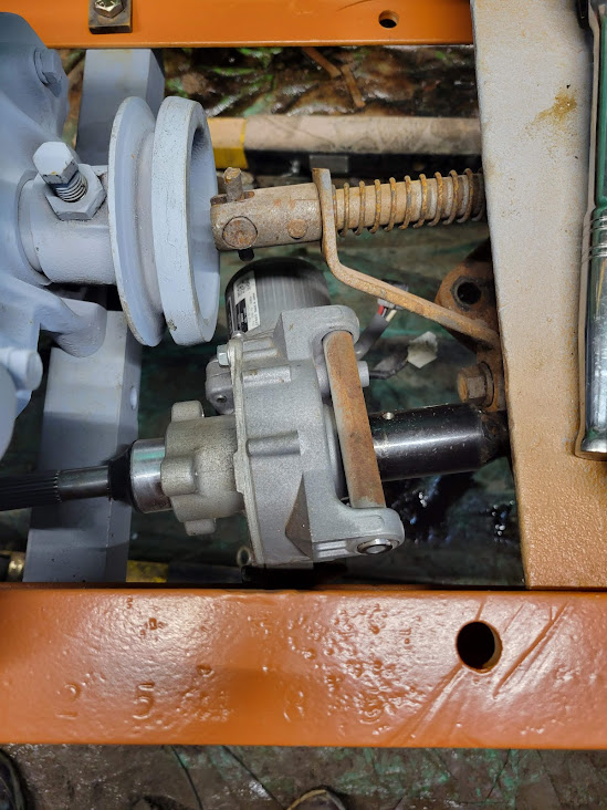

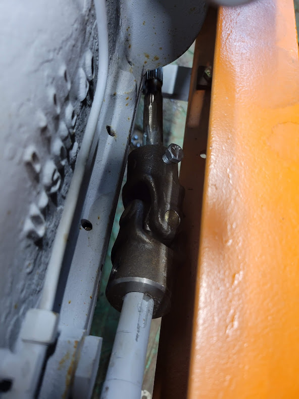

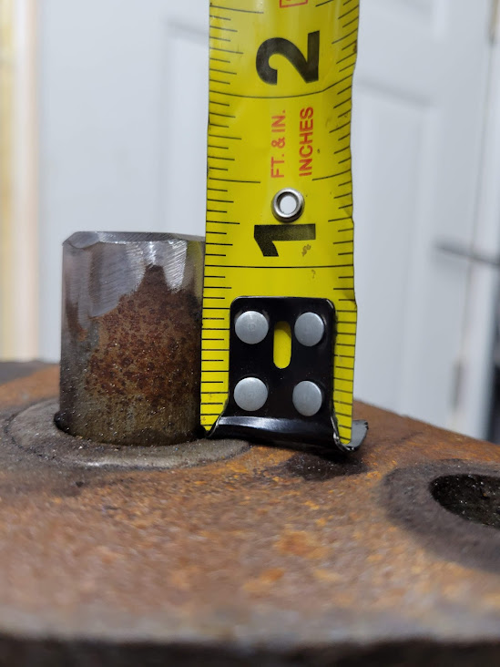

I removed the original steering shaft from the front bolster. I previously marked the shaft in a rough spot to cut. double measured and cut the original steering shaft to make fit! no turning back now..
I ended up with 1 3/16" shaft protruding from the bolster bolt plate.
I took my coupler adapter and welded it onto the stub shaft. I have yet to find a smaller coupler to allow the bolster plate to be removed once this shaft is welded. so, in that case (and so it was in my case) replace the bearings on the worm gear or make sure they are good prior to welding this on.
Once welded into place, I was able to grease the bearings and reinstall the worm gear into the bolster. the worm gear is much easier to fit in once its 2 feet shorter! LOL
I slid the power steering unit onto the coupler for a test fit. It fit rather well with some minor adjustments. It has roughly 1/4-3/8" between itself and the front crank pulley.

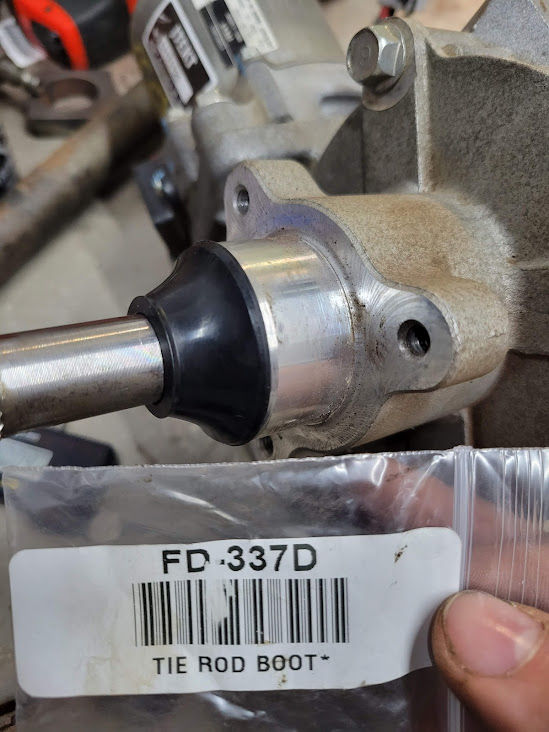

I used a rubber tie rod boot (part number from DJS Tractor) to keep water away from the torque sensors on the unit.

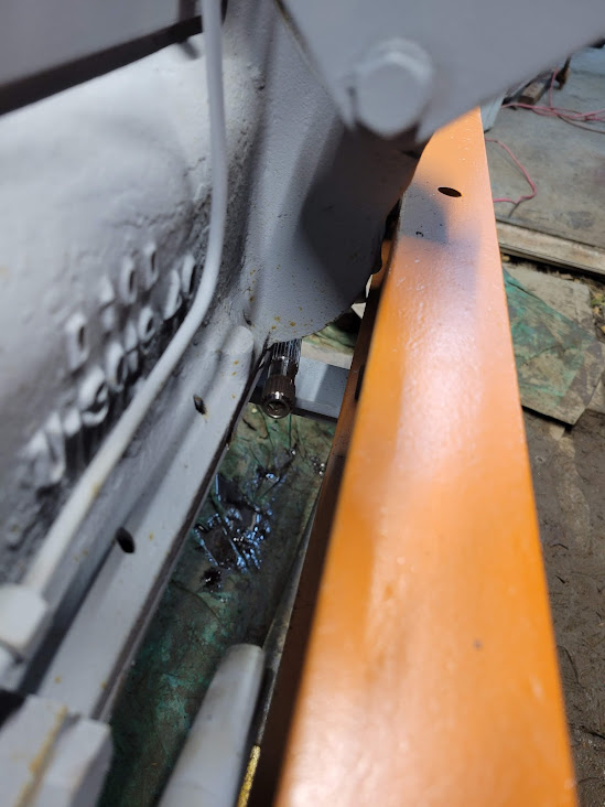

Here is the unit placement in the frame rails. More space then you think but at the same time less space than you think!
Steering shaft comes through the original area under the engine. tight space but no different than the original. I do still have an extension I need to make to mate to the u-joint that will be 3.25" long and made out of the remaining stepped portion of the go kart shaft.

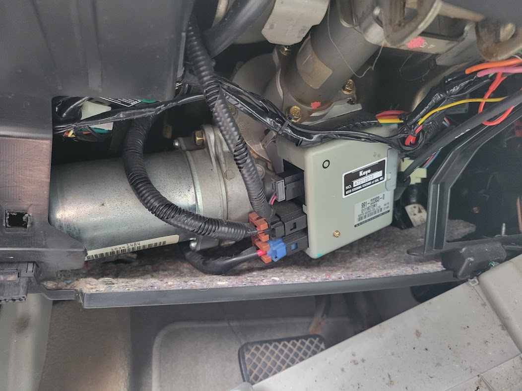

My specific unit came from a 2007 chevrolet equinox. but, saturn vue and ion do work as long as it is a metal (grey) box for the ECU. if it is the black box, it will not work with any controller correctly due to a computer issue inside the unit.
There is a few other units that do the same purpose (toyota prius, nissan cube, kia soul etc) but none that were as tightly compacted as this setup.
I picked my power steering motor and ECU up for the tune of $60 at the local auto wreckers.

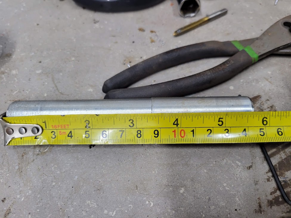

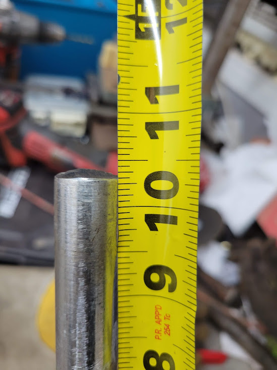

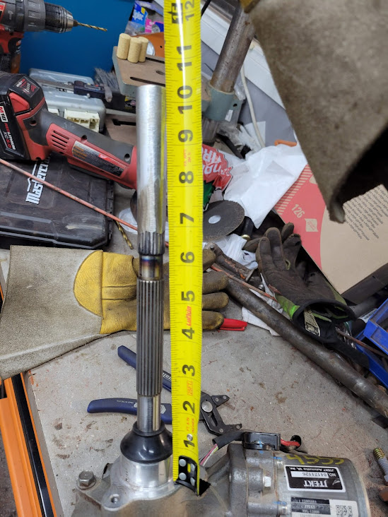

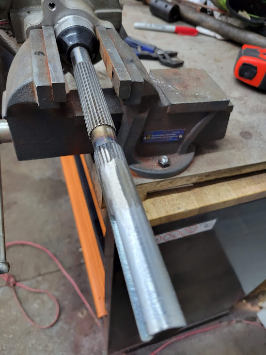

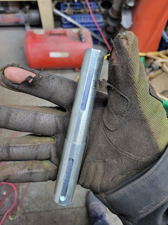

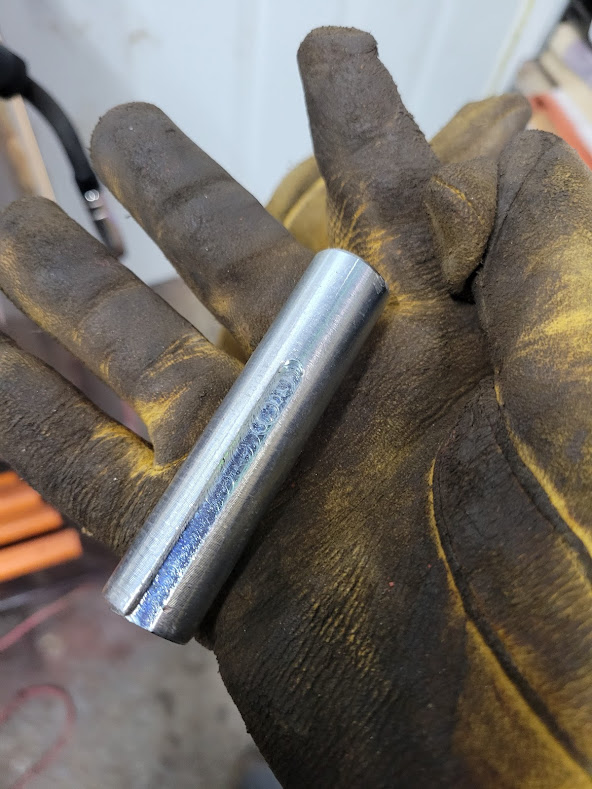

I was able to get the steering shaft extended last night by the 3.25" it needed.
here is the 3/4" section of go kart shaft i cut out to fit.
Welded onto the original shaft without cutting
Total length of the shaft now is as followed:
I put the assembly into the frame once again to double check. it looks like it lines up perfect! I will very likely be re-using the original shaft support as well with a 1" to 3.4" bushing.
Edited by Jtaylor - 24 Mar 2022 at 8:19am

 Looking Good, Justin,,Looking good,,!! Beautiful weld too,,,,,mig or tig,,?
Jtaylor View Drop Down
Joined: 11 Oct 2021
Location: Barrie, Ontario
Points: 194
Post Options Post Options   Thanks (0) Thanks(0)   Quote Jtaylor Quote  Post ReplyReply Direct Link To This Post Posted: 24 Mar 2022 at 10:03am
thanks! That shaft was MIG welded.

Installed the steering u-joint as a test fit. Fits very well! I still have a couple lock screws to make for the correct clearance in the u-joint. working on the mounting bracket next. this should be pretty straight forward.

Post Options Post Options   Thanks (0) Thanks(0)   Quote DrAllis Quote  Post ReplyReply Direct Link To This Post Posted: 25 Mar 2022 at 7:38am
My engineering question would be......how many ft lbs of torque is this device capable of ??   The front wheels on a small car surely would be lighter than front wheels on a farm tractor, right ??
From all the sources i have read, 80 ft lbs is the norm... the saturn vue weighs in at 4894 lbs gross weight. with 60% of the weight being at the front of the car, you have 2936lbs roughly over the front wheels that the EPS needs to overcome.
the WD45 weight varies but consider 4000lbs as a rough number. exclude rear wheel weight and maybe 40% of overall tractor weight on the rear tires? you would have a front axle weight of roughly 2400lbs. about 500 lbs less than the saturn car.
I would think we would be okay from a simple math standpoint.. only time will tell!
