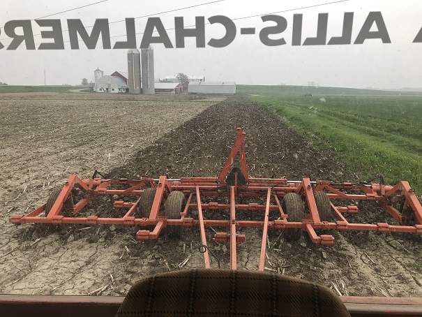

My 8030 fwa currently pulls a 25' 1300 series Allis cultivator.  What size of 1400 series cultivator should I be looking for (ideally with mounted  levelers /drag)?

Michael(WI), Great picture. Looks like the 1300 is doing a good job. Thanks for sharing.
"What size of 1400 series cultivator should I be looking for (ideally with mounted  levelers /drag)?"
I don't see a mounted levelers/drag on your AC1300? If you add any of those items to a 1400, it's going increase load. The AC1400 was offered with double pointed spikes, 6", or 12" shovels in 21'-61' widths. I imagine the 8030's MFD helps distribute loads, but it has two-pinion rear differential & stock 115 dbr hp. Is it's 670T hp stock or adjusted? Either way, 670T's EGTs might climb if under too much load since it has no intercooler.
A 21' 1400 weighs in @ 4345 lbs, with 4" shovels & levelers would be a load for an 8030? But then it depends on how wide of shovels, how deep it set, & how fast it's traveling....???
AC 1400's walking-beam suspension would be nice though.

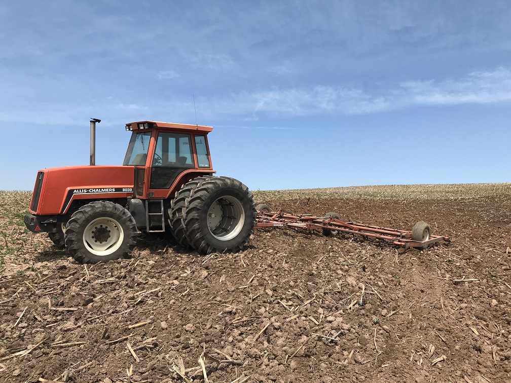

Got a 23' ish.  Thankfully someone painted it orange over the spring green.  We will find out shortly if the 8030 will pull it.  Otherwise I might have to upgrade, shucks....

Your 8030 should have no problem pulling 23' of 1400 cultivator. D21 and 220 have no problem with my identical cultivator. Clay loam soil but not real deep. Just need a good seed bed.  I posted a video of my 220 and 1400 on Facebook in the Allis Chalmers Tractors group.

The 8030 does pull it on the leveler ground.
