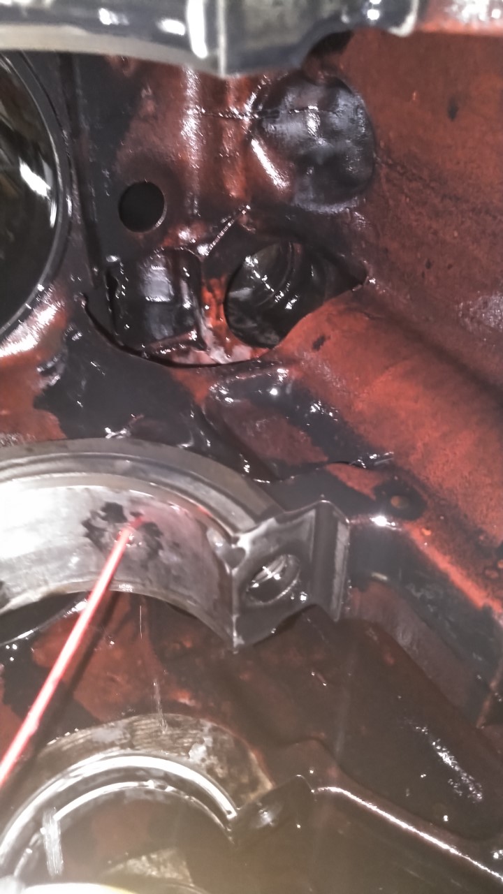

The main saddle was still drilled to lube the cam driven oil pump which exited in the early 210-220.  An ole Ac service rep suggested plugging this at any teardown.

I don't have any good insight for you, but about 5 years ago, I overhauled my 8070 and noticed the main bearings for the top side were different and came with instructions and small round balls to plug a hole in the main saddle.  I didn't want to split the tractor to drop the crank.  My main bearing looked good on the top side.  So I just replaced the bottom halves of the bearings and and left it alone.  From memory, I think it said something about better piston cooling, but I really don't remember.
Points: 22861
Post Options Post Options   Thanks (0) Thanks(0)   Quote DrAllis Quote  Post ReplyReply Direct Link To This Post Posted: 06 Feb 2022 at 7:40am
Two completely different issues. The 8000 series original design upper main bearing shells were discontinued 25 or so years ago. So, as a result, the upper main shells that are now provided need the piston cooling squirter holes plugged in the block to keep oil pressures within a specific range. You did the right thing on an in-frame OH. Just use the old upper shells.

I has been our experience that # 5 rod is the most susceptible to damage due to oil starvation, my buddy thinks this is part of the issue - I can't prove it but he said he never had a failure and oil pressure builds faster with the hole plugged especially after sitting a few days..  This is FYI

He is of course talking about the old Generation #1 3000 series blocks. I've always blamed slow oil pressure build up due to the fact that both engine oil filters are empty from draining back, versus the Mark 2 engines having the oil filters unable to empty themselves when sitting around for weeks on end.
  Exactly, thats why my Allis manual says to fill those filters after oil change.
   Steve Fisher came to the same conclusion awhile back on here.

Hey Steve I used Clevite kits to rebuild my 8000 series 50 and 30 the bearings were exactly the same as the original, no need for plugs.
