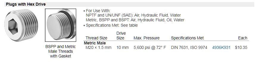

Have your auto parts store try Dorman products....At least you will get a size to work with....
                                                      or maybe start here
HTH...Dale

If it is a 10mm ALLEN wrench drive, that normally matches to a 20mm plug..
20mm is 1/32 of an inch BIGGER than 3/4 inch.

One nice thing about metric fasteners, is you can measure the diameter at the threads to determine what it's diameter is. I use the wide part of the caliper jaw to bridge across the thread peaks, and a 20mm might measure 19.8 or 19.9 and change. Once diameter is determined, now you can use other bolts like Steve mentioned and use a known bolt thread pitch to match the threads on, most likely a 20mm would be 1.5, 1.75 or 2.0 thread pitch. Knowing the exact size will then allow you to look at the auto parts store there's many replacement drain plugs for cars and trucks, many of which are metric.

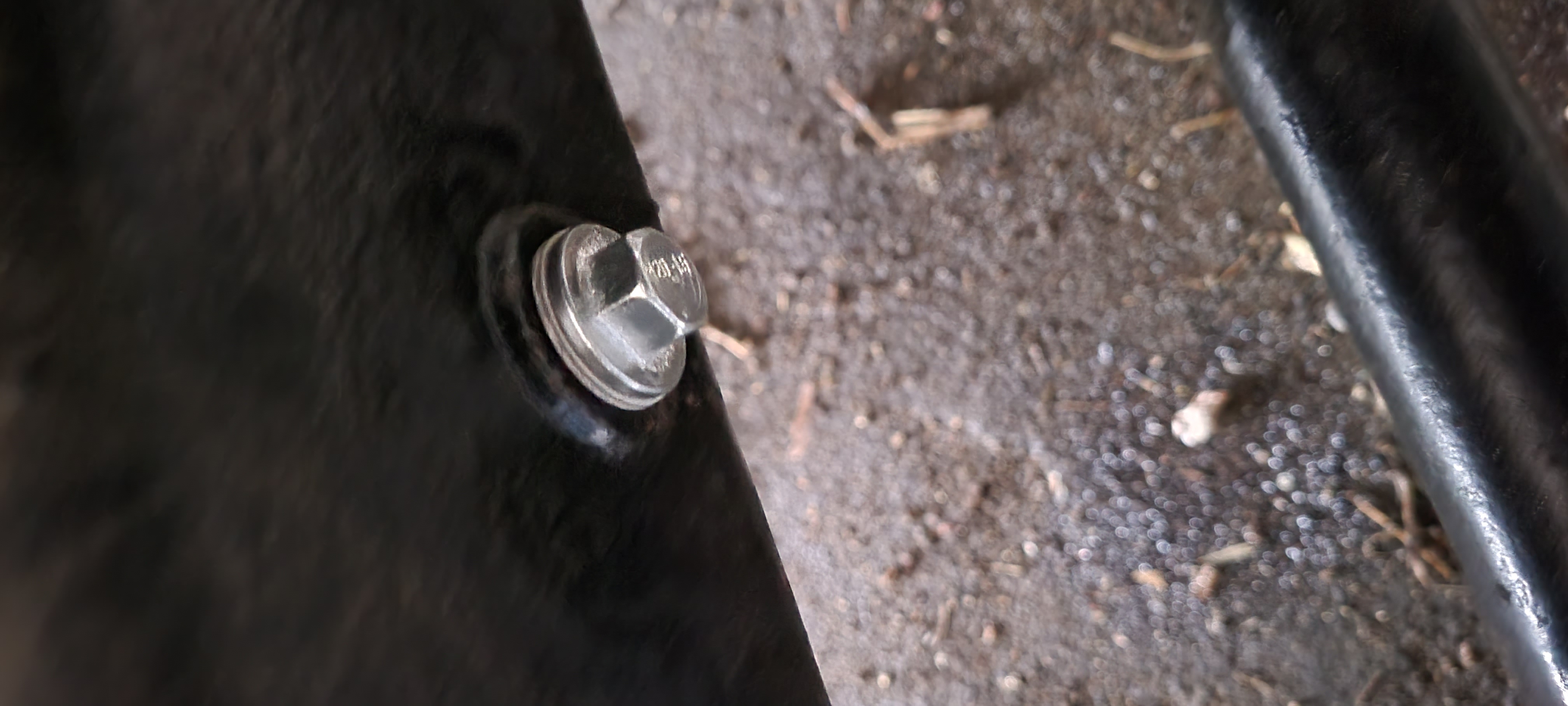

Post Options Post Options   Thanks (0) Thanks(0)   Quote tthams Quote  Post ReplyReply Direct Link To This Post Posted: 06 Feb 2022 at 5:34pm
For those wanting to know the oil plug for the MFWD in our 8070 was M20 x 1.50.
Here is the link to what I bought if it helps anyone! (DORMAN OIL PLUG) It was $4.28.
It fits like a glove!
