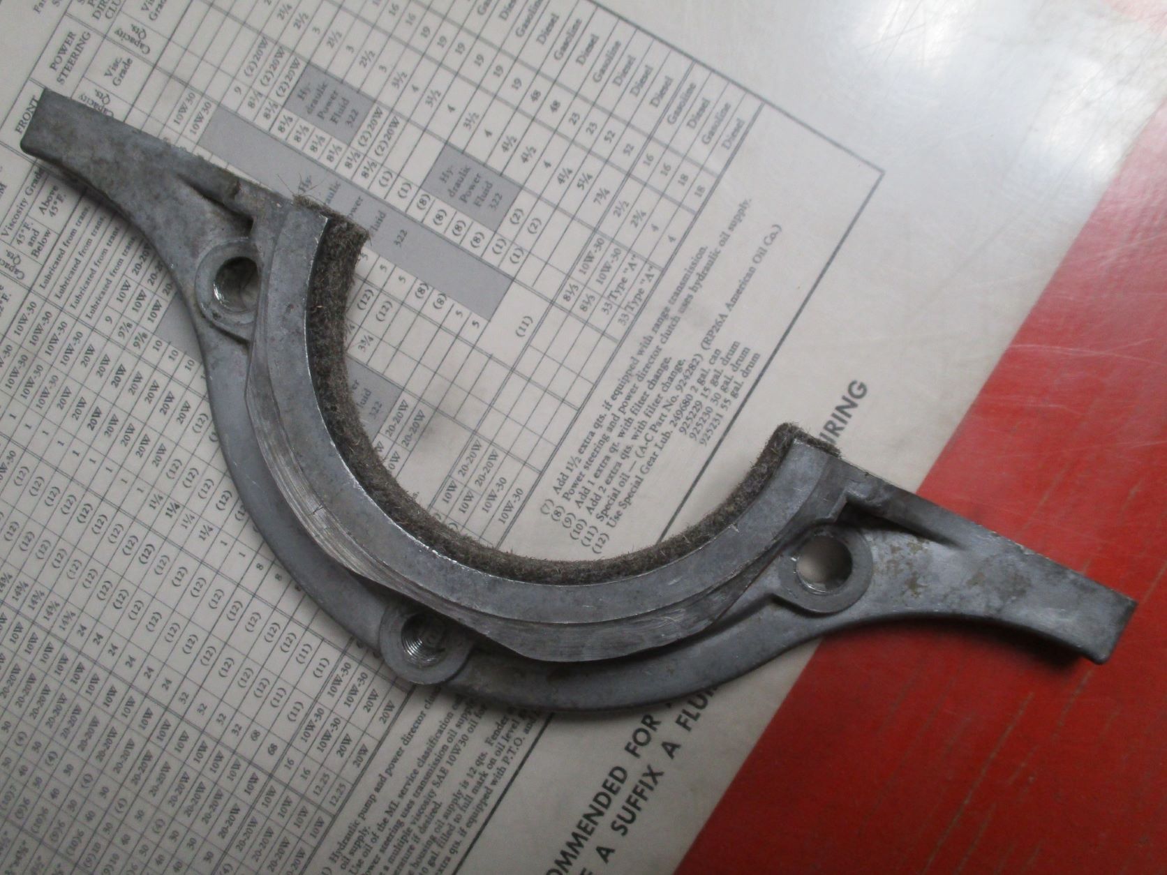

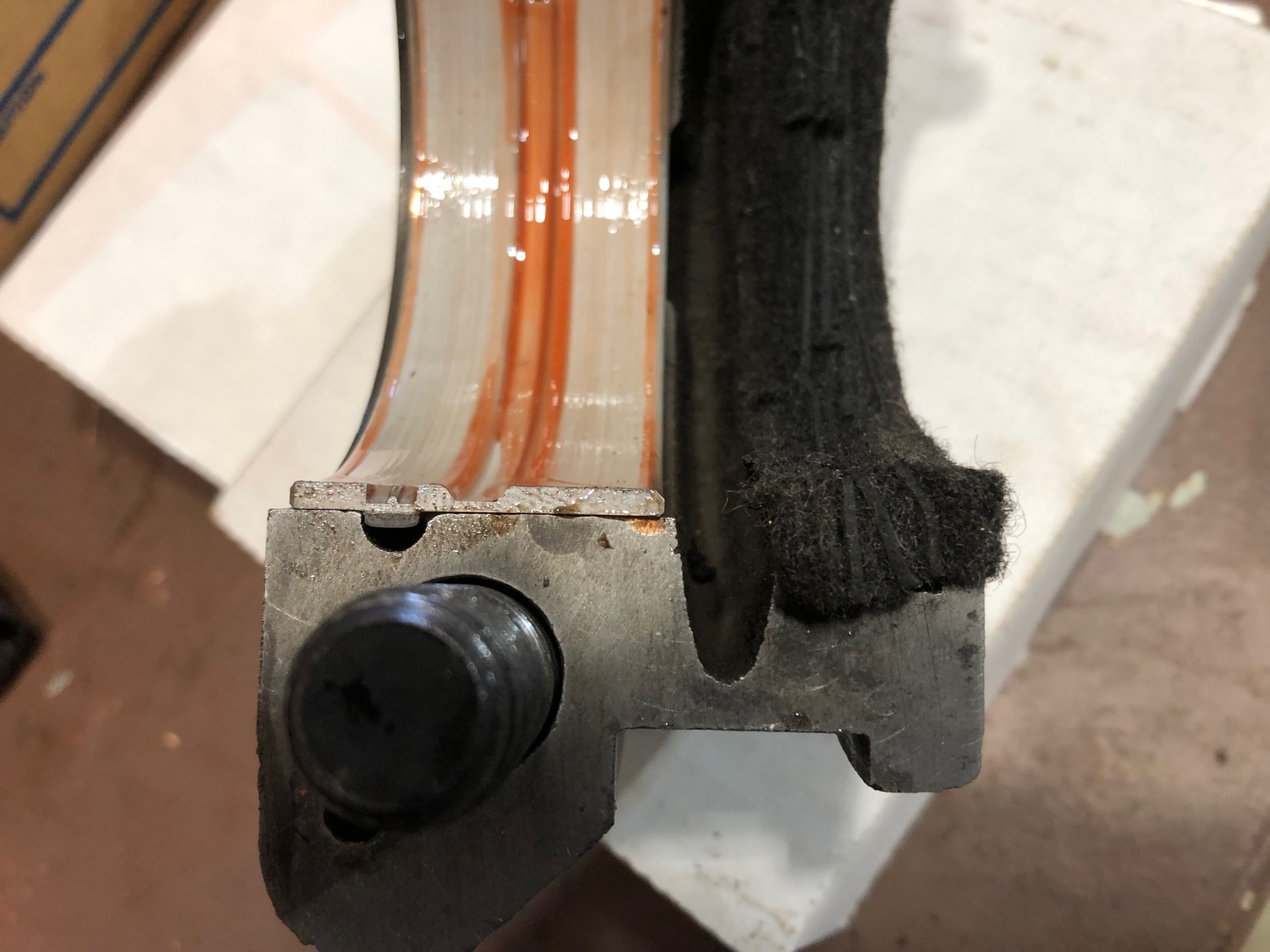

I agree with most everyone to glue the seal halves in the groove. The bottom of the aluminum retainer should be flush with the bottom of the block. You should also not cut the ends of the felt seal halves. Use the F gaskets and coat each side of the gaskets with a THIN layer of rtv/oil resistant silicone gasket maker. That is where my agreement ends.
It appears from the pics you are using aftermarket felt seal halves. I started to use those till I got fed up with how they don't fit properly. The aftermarket seal halves are too wide and slightly too think. When installed there is too much end sticking out of the groove. If you have 1/8" sticking out at each of the 4 ends, it will fold over instead of compress to be flat, I don't care how much you tighten. Too much seal end protrusion prevents the main bearing cap from making a tight seal against the top aluminum seal retainer resulting in oil leaking out the side gap where the F gaskets go. The ends of the felt seal should protrude about 1/16". Enough to compress to seal but not too much that the main cap can't tighten against the block and top retainer. The OEM felt seals are engineered for a PRECISE fit. I always use the OEM felt seal halves when doing rear main seals. They are so easy to install, within 1 minute I can take them out of the package and have 1 seal half properly in the groove. No clamping, no freezing, no waiting. See the 1st pic below for OEM seal in top retainer. 2nd pic shows the difference between the OEM seal half on the left and aftermarket seal half on right. The OEM seal is excellence in engineering and is what I would recommend you use.
