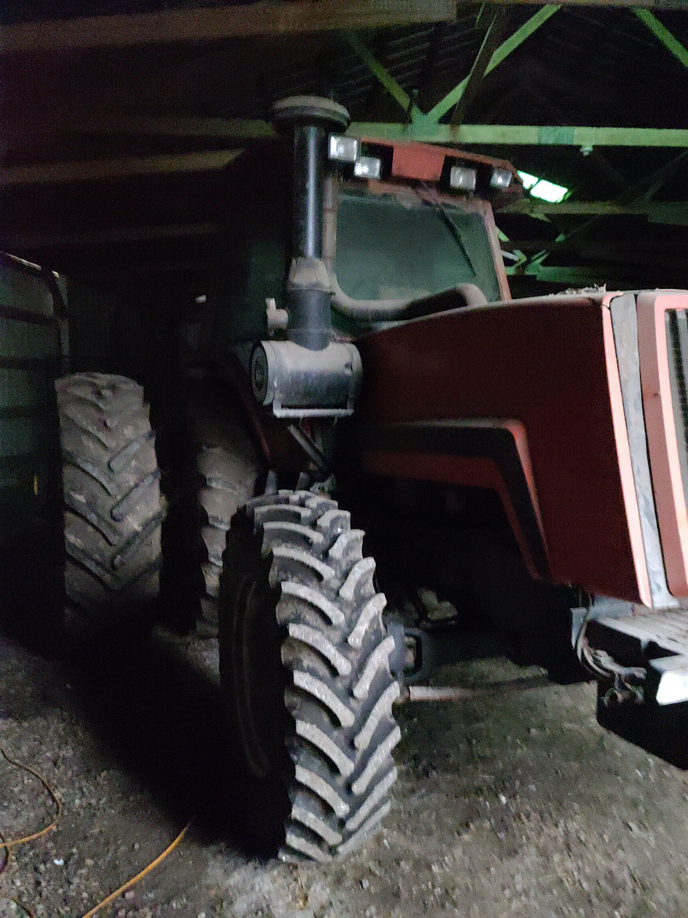

A guy has for sale an 8050 with an n7 gleaner engine in it. I looked it up and it is 270hp. Can the rear end keep up with that engine? It has a power director transmission and the low side isn't working properly. Does that engine actually bolt up to that transmission? Assuming power director has to be rebuilt what would be the price range for that fix. I am guessing $5,000? Attracted to the horsepower but might be a nightmare to keep it running.

My 7580 was turning 300 ish with an 8.3 Cummins that wasn’t a good combination.
Points: 21712
Post Options Post Options   Thanks (0) Thanks(0)   Quote DrAllis Quote  Post ReplyReply Direct Link To This Post Posted: 09 Jan 2022 at 6:43pm
Having 270 HP and using 270 HP are two different things.  Having 270 HP and using all of it and having the tractor weighted down for traction will eventually result in BAD things happening. This also assumes all this power is going to the ground and not thru the PTO. There was someone posting a project like this on this website, but it was to be used for pulling a forage chopper, so maybe in that case some things could survive, like 180 HP thru the PTO and 90 HP thru the axles.  The other thing that is bad about this engine is it makes its HP at slower RPM's, which is BAD for the driveline/transmission.

Appreciate the replies. I figured this would be the one that I probably should stay away from but I thought maybe I could have the n7 engine removed and find an 8050 engine or maybe 8070 engine. Although I said my next tractor would be powershift.

I went and saw this unit today. Very well done .They had a Perkins in it before going with the N7.Think they have it sold.

FWA serial 1015. It's a little east of Decatur Il.

It is on Facebook. It is in Laplace,Illinois. I like the exhaust moved to the side. Nice duals and nice tires all the way around. Fwa looks good.

Makes me laugh. Had a 426 that when adjusted to factory settings was 170 PTO HP. Then, they install a PERKINS ??? Really ??? They never had an engine that would match a 426 for HP. And so now we have more engine that the driveline can stand  !!!   Gotta laugh at this.  They must have more money and time to just play around without a real plan !!!

There's always a want for more horsepower. I don't understand what is wrong with the 426 other than it doesn't have the long 7-8000 engine hour life at its higher horsepower. My rebuilt 8070 was running 6.5 mph with a 40ft 1300 this summer preparing alfalfa ground.

Dr. Allis would have more knowledge on low being out but it could be in valve body and solenoid not shifting back to low or in clutch packs. Possibly of have the increased horsepower could of took the clutches out of low. People put 8.3 Cummins in 4w220s and some 8070s all the time. Ive heard of a 8070 2wd up north of me taking the spider gears out of the rear end every few years with a 8.3 but hadn't been told if it had any tranny issues.

Twisted off low range input shaft.

That was my guess that it was too much engine for transmission but I don't know much. Did the engine seem good? Not sure he has an offer though.

I think transmission failure rates on the 7580/4W-220 with an 8.3 Cummins was fairly high. Same thing...input shaft failures or input gear failures from too much torque and slower engine speeds.

If I remember correctly, the original 426 went down around 1200 hrs. Then the Perkins went in. Ran several years until the N7 came available from a local dealer that has been out of business for 15 years or more . So I was led to believe that it been in that tractor for several years.. Said was used for tillage, bat wing mower and grain cart. It will move in the low side when the oil is cold but slips when warm. High side is ok.
