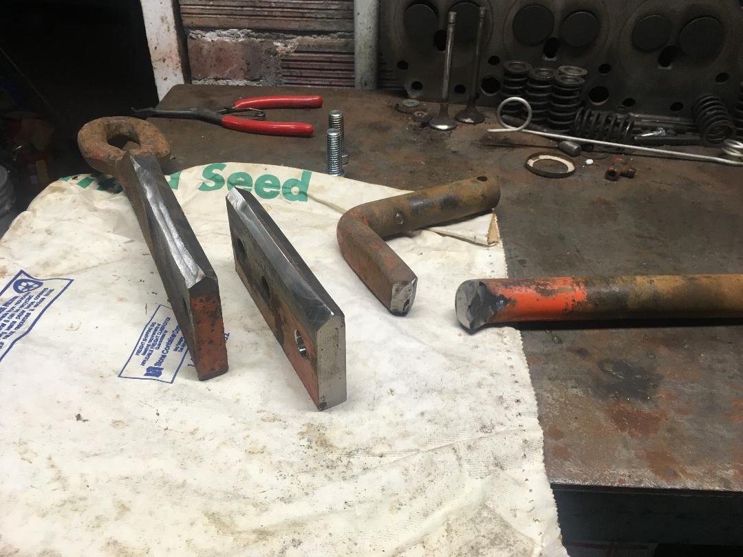

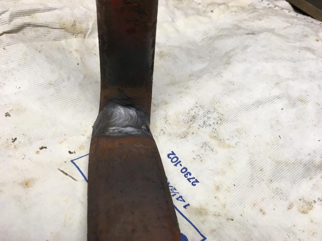

Had to fire up the welder awhile back, broke a coulter mount plowing. As luck would have it, none of my other plows have that style mount. My concern with welding it was the fatigued area next to the break. I ground it back a long ways in the classic 'V', It welded very nicely.

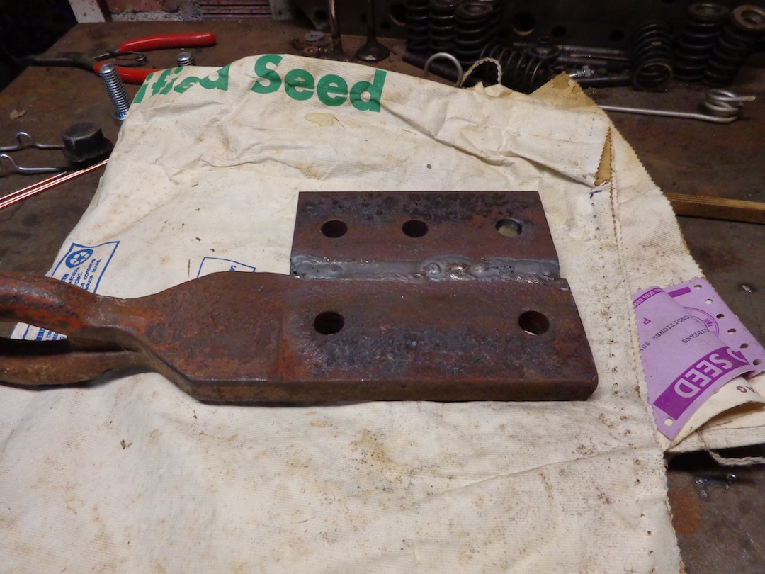

The other project is a bit more of an experiment! Last fall after putting the 16.9X28's on the narrow front, the sub-soiler wouldn't go in the ground to full depth. My idea was to offset the latch eye. Picked up an eye at Hutch, used an old piece of plow frame for the other half. 'V'd them both, preheated and together they went. I'm not sure what the steel in plow frames is but it's pretty hard, the preheating helps with under-bead-cracking. At least I hope it does. Should have time to get this on the soiler today, will give it a try if I do. Ground is really too wet so won't do too much, just see if it works.

Post Options Post Options   Thanks (1) Thanks(1)   Quote steve(ill) Quote  Post ReplyReply Direct Link To This Post Posted: 07 Nov 2021 at 8:30am
very nice weld bead............. preheat sure does wonders on the hard steels.... grind the rust off to CLEAN metal as you did helps a lot... i even wire brush a 1/2 inch PAST where the weld will be so it does not suck any rust into the final weld...again, NICE BEAD.... is that 7018 ?

Post Options Post Options   Thanks (0) Thanks(0)   Quote PaulB Quote  Post ReplyReply Direct Link To This Post Posted: 07 Nov 2021 at 4:19pm
Why not just make 2 plates so that everything bolted together? Ermm Then If you need to make a change to get it deeper you could angle the spread on the holes a bit.

Doc, I hear you! I don't scrap anything unless it really is scrap!
Steve, it is a mild steel tig rod.

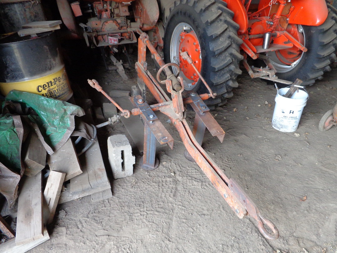

I got this thing installed on the soiler today, had to do a little 'fitting', aka grinding, to get it together. Hooked it on the narrow front for a test spin. I love this thing but it is the most cantankerous snap-couple implement ever! Just a pain to get hooked up to.

Post Options Post Options   Thanks (0) Thanks(0)   Quote IBWD MIke Quote  Post ReplyReply Direct Link To This Post Posted: 08 Nov 2021 at 7:27am
Ted, on other snap-coupler implements the drawbar is right there at the right height. Back into it, snap, hook up the links, and away you go. With the soiler, the eye is on the ground and it's laying on one side. Think I'm going to make some kind of a stand or pair of. It could be supported by rafters with wire possibly. Then if I can just find the right spot in a shed...

Post Options Post Options   Thanks (0) Thanks(0)   Quote steve(ill) Quote  Post ReplyReply Direct Link To This Post Posted: 08 Nov 2021 at 8:30am
Mike, i have a couple small "stands" that i use to support the 4x4 truck and equip when jacking them up..... i cut a dozen 2 x 4 about 8 inches long.. stack them like lincoln logs and spike each layer with  16 penny nails to the layer below.. You end up with a BLOCK that is 8 x 8 inches and as tall as you want...... i have a couple that are 14 x 14 base for BIG stuff.

Post Options Post Options   Thanks (0) Thanks(0)   Quote PaulB Quote  Post ReplyReply Direct Link To This Post Posted: 08 Nov 2021 at 10:14am
Take two plates, drill 4 hole that match the eve and implement in a square pattern and then bolt together with the eye above the implement hitch. This would allow everything to be put back original when said implement is use on a tractor with "normal" rear tires.
  In my lifetime I've probably welded more miles of bead that many young ones have driven, so I look for other ways to make things that don't destroy original parts.

Post Options Post Options   Thanks (0) Thanks(0)   Quote Tbone95 Quote  Post ReplyReply Direct Link To This Post Posted: 08 Nov 2021 at 10:22am
TIG eh?  Those were fantastic looking beads, would have been an accomplishment to be proud of for sure coming off an arc welder.  Not saying it couldn't have been, just saying a TIG sure makes a clean weld, and of course you still have to know what you're doing.

Post Options Post Options   Thanks (0) Thanks(0)   Quote IBWD MIke Quote  Post ReplyReply Direct Link To This Post Posted: 08 Nov 2021 at 1:30pm
Paul, I saved the original eye, this one is probably from a plow?

Post Options Post Options   Thanks (0) Thanks(0)   Quote IBWD MIke Quote  Post ReplyReply Direct Link To This Post Posted: 08 Nov 2021 at 1:42pm
Found the camera in the toolbox on the tractor.
Some shots of the mod and sitting on stuff to get hooked up.
It goes in the ground now!

Post Options Post Options   Thanks (0) Thanks(0)   Quote Dave (Mid-MI) Quote  Post ReplyReply Direct Link To This Post Posted: 09 Nov 2021 at 7:38pm
I used to struggle when hooking up my #4 subsoiler too, until I read the owners manual. Prop it up vertically with the pull bar on the ground. Back over the subsoiler pull bar until the lift arms are under the couplers. Attach the lift arms and lift the unit off the ground. Grab the subsoiler shank from behind, pull back and align the pull bar eye with the snap coupler bell. Swing the unit forward until the eye snaps in the coupler.

Chris, thanks.
Dave, correct you are! Right there on page 5, someone probably should have read that darn thing.
As to the future, I will be building stands so that you can hook/unhook like any other S/C implement, stay tuned.

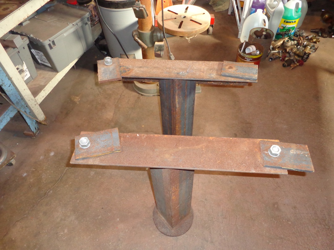

Post Options Post Options   Thanks (0) Thanks(0)   Quote IBWD MIke Quote  Post ReplyReply Direct Link To This Post Posted: 25 Nov 2021 at 8:46am
Well, here is the stands. They came from work, come in on new hoists we put up. Just welded the hold-down straps together. Had to torch the new holes in the angle iron, couldn't get them in my little POS drill press. Mounted and in the shed.
Now if I can get the pics in the right order.
