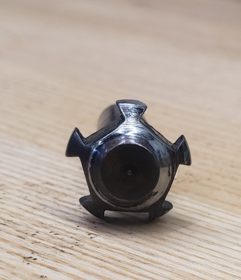

Post Options Post Options   Thanks (0) Thanks(0)   Quote A&Sfarms Quote  Post ReplyReply Direct Link To This Post Posted: 26 May 2022 at 1:57pm
Here is my plunger. It is definitely not seating evenly and looks like it could be leaking in-between one of the sections.

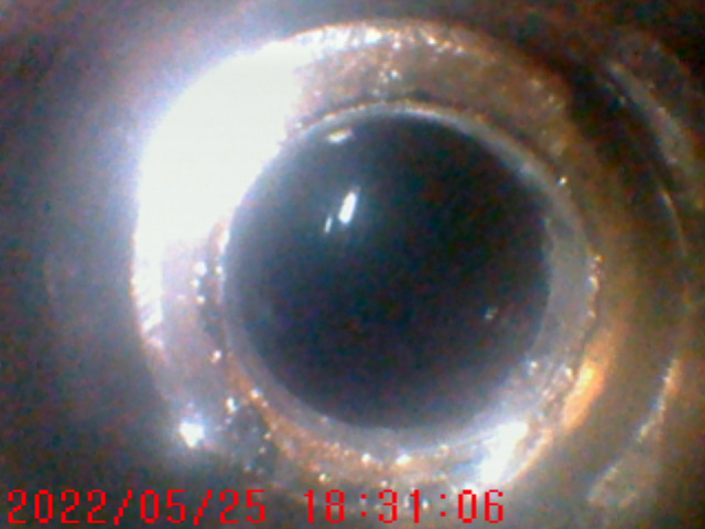

Post Options Post Options   Thanks (0) Thanks(0)   Quote A&Sfarms Quote  Post ReplyReply Direct Link To This Post Posted: 26 May 2022 at 2:00pm
Here is an image from the bore scope. It is hard to tell from the picture, but is there a seat there?? I'm not sure what it is supposed to look like.
