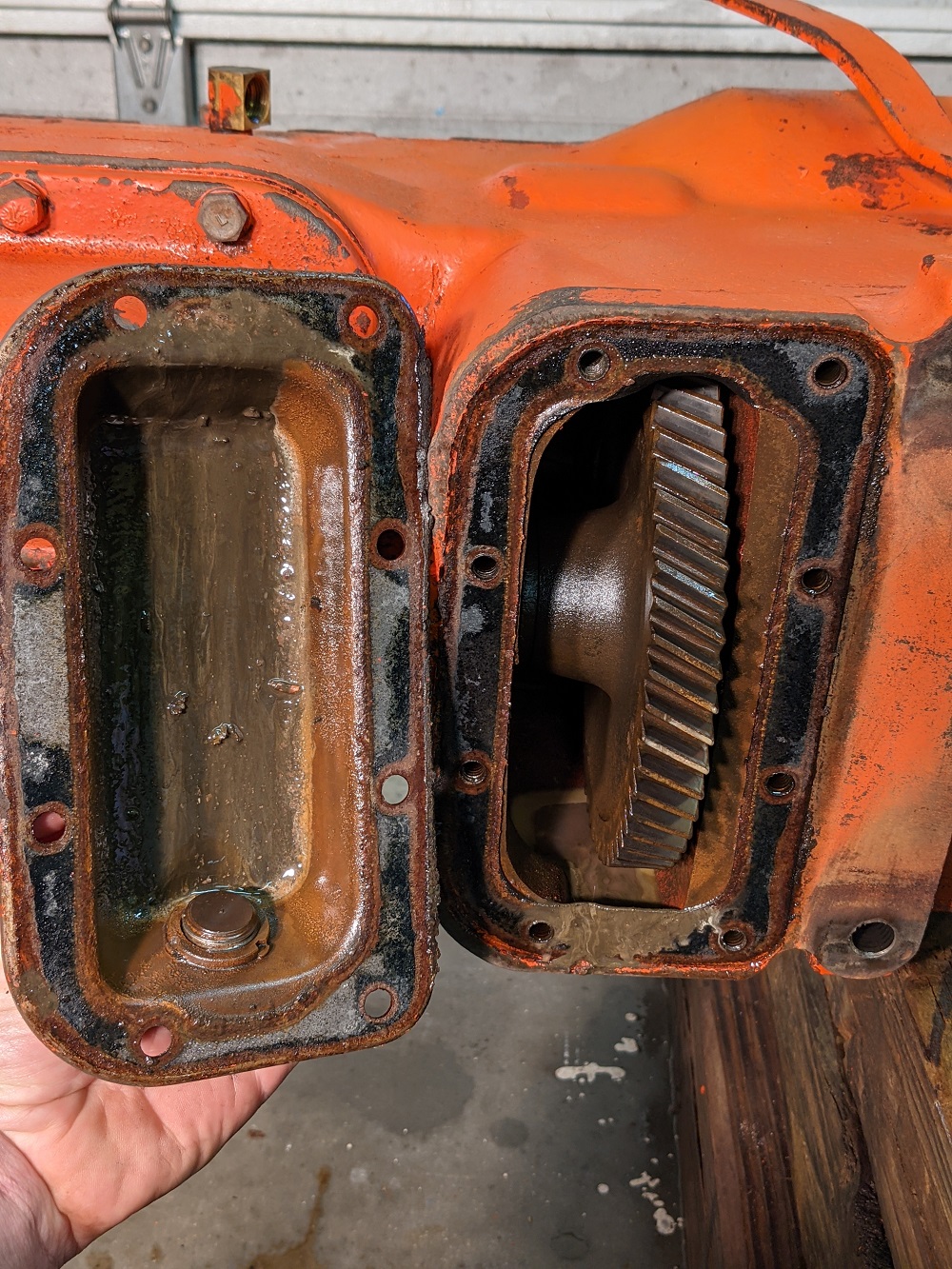

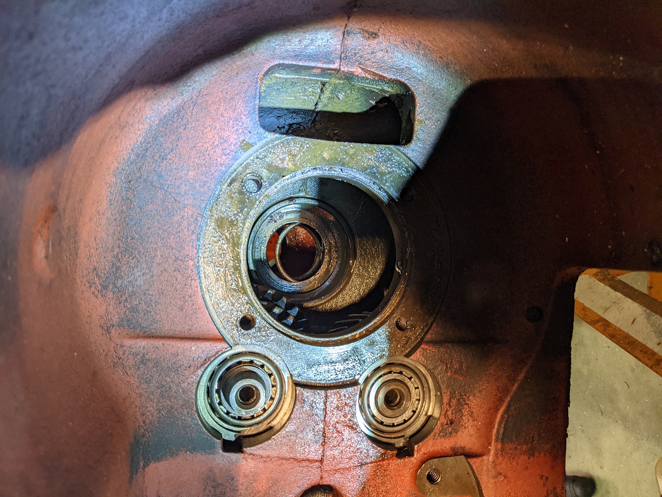

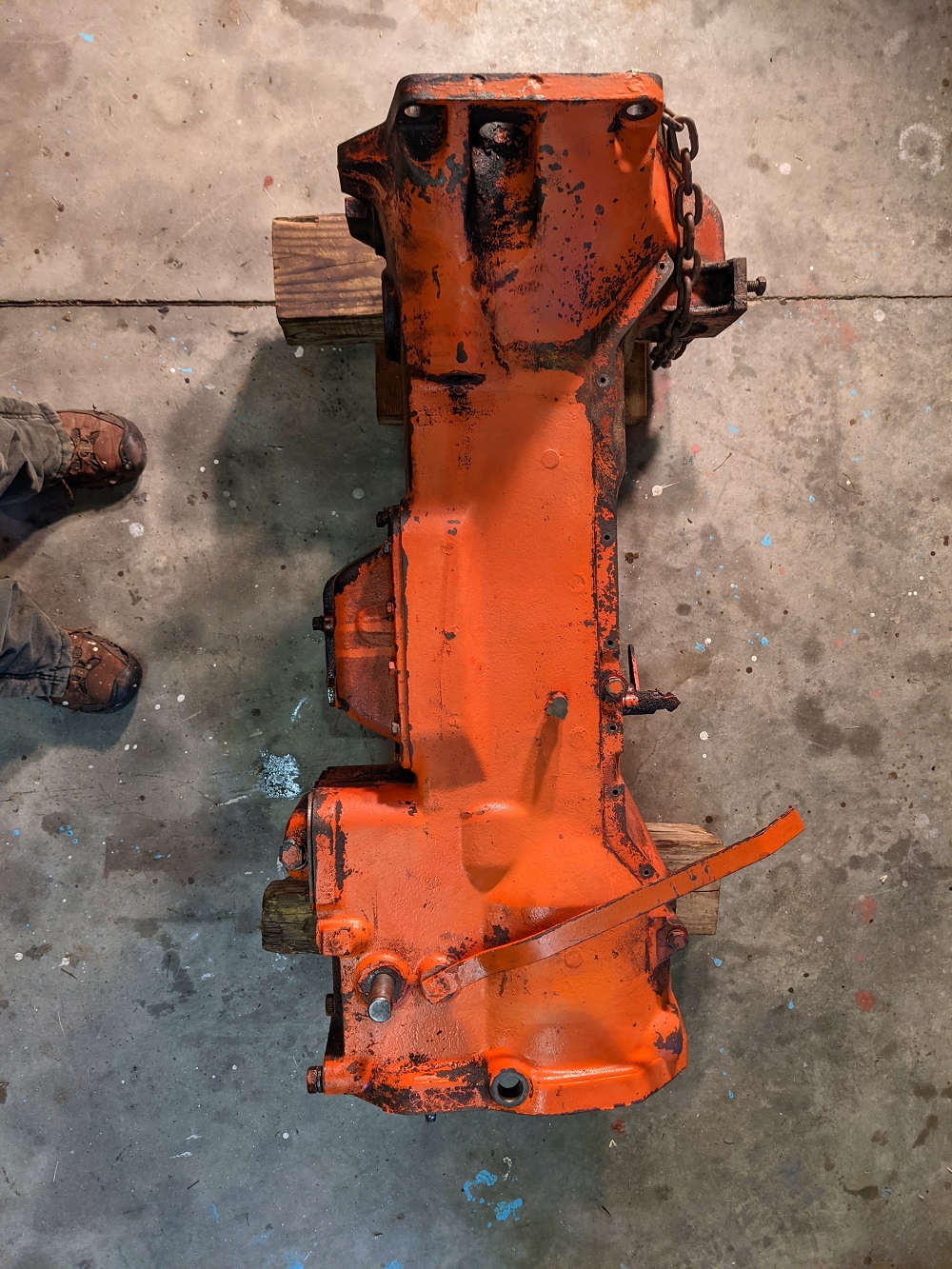

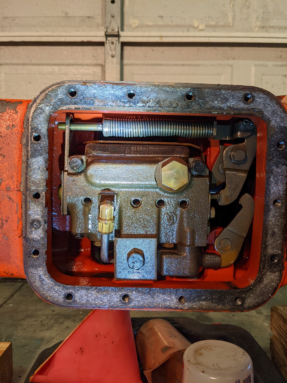

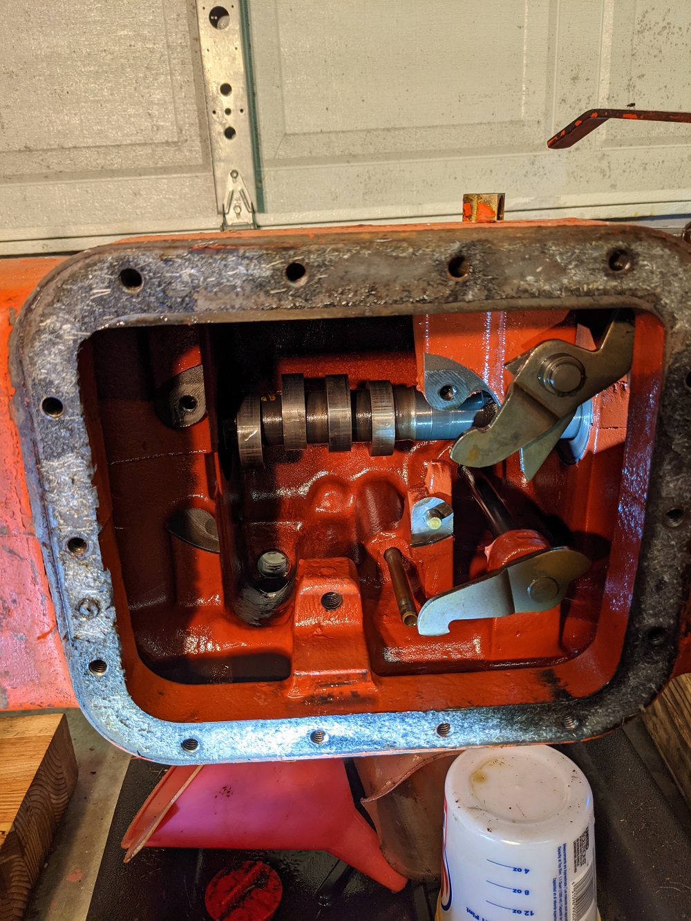

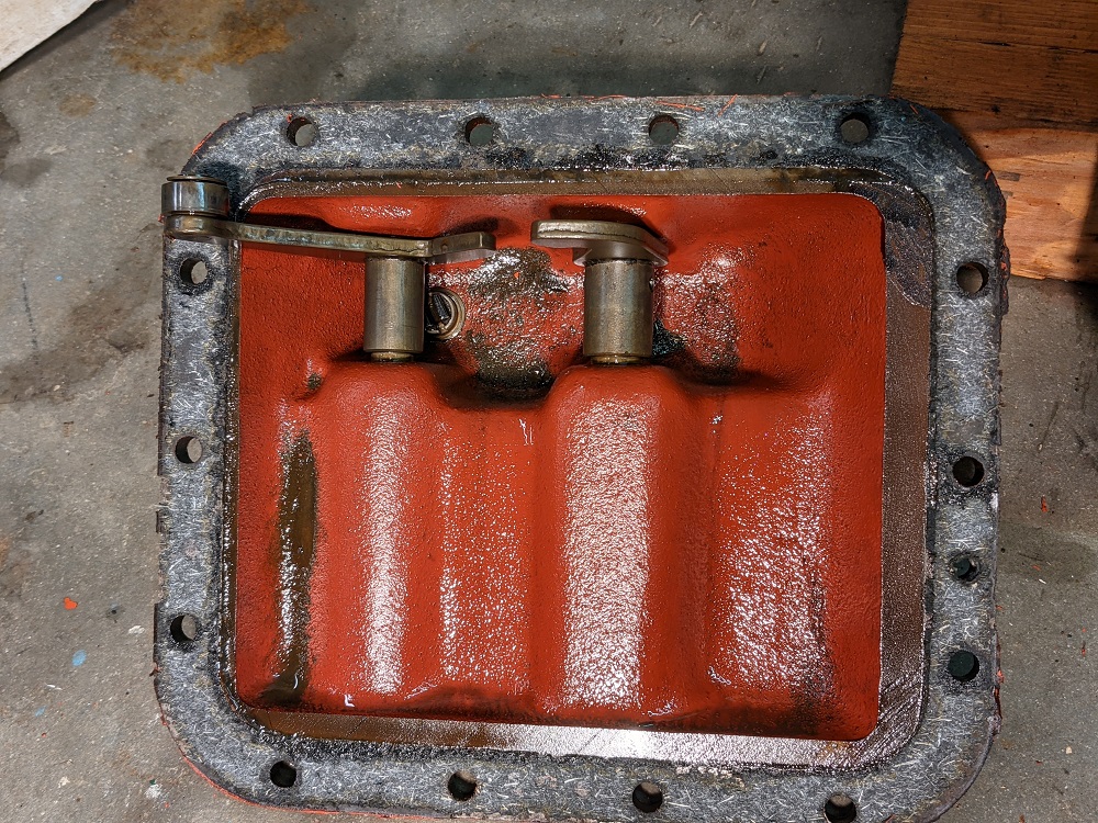

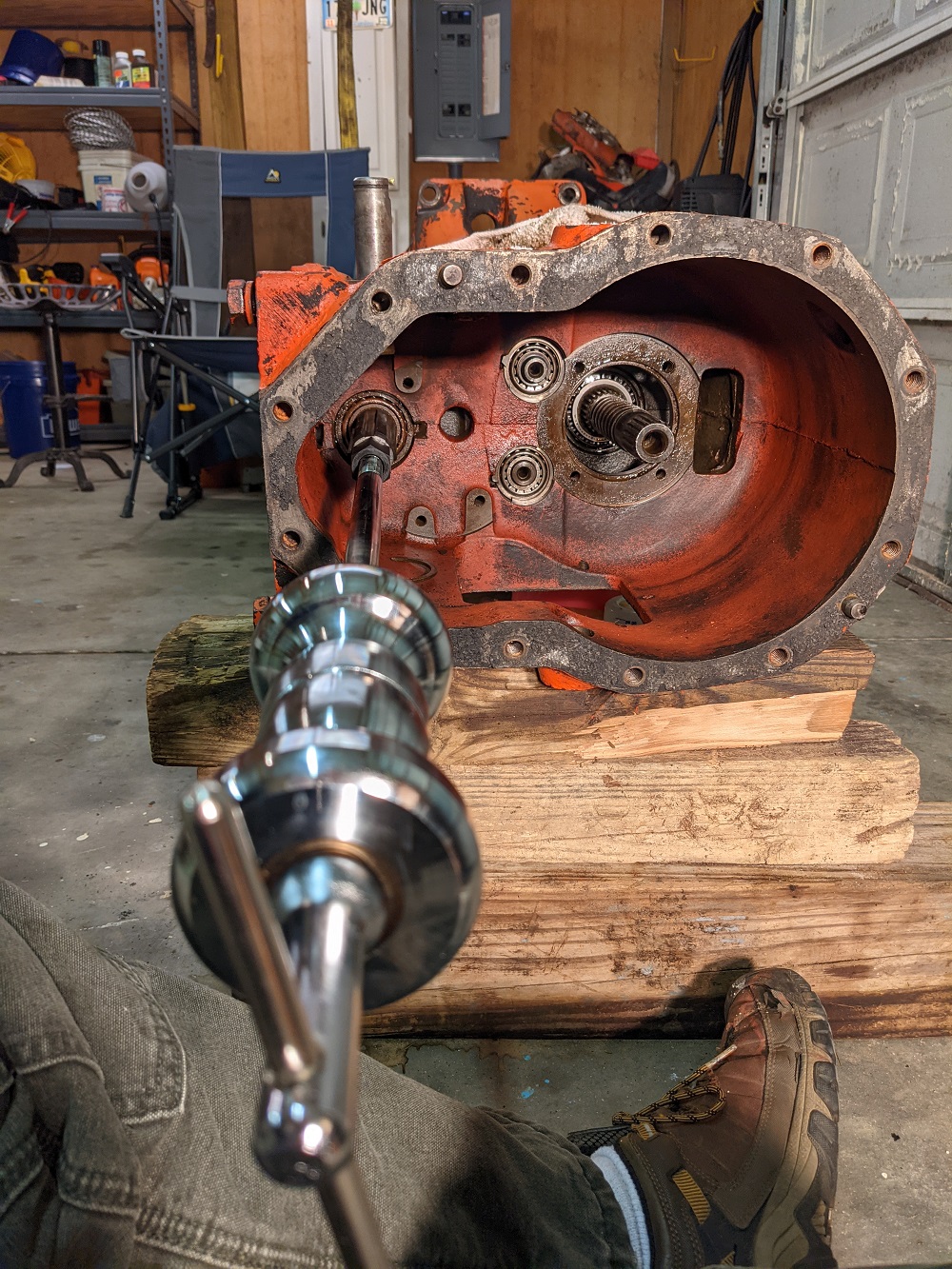

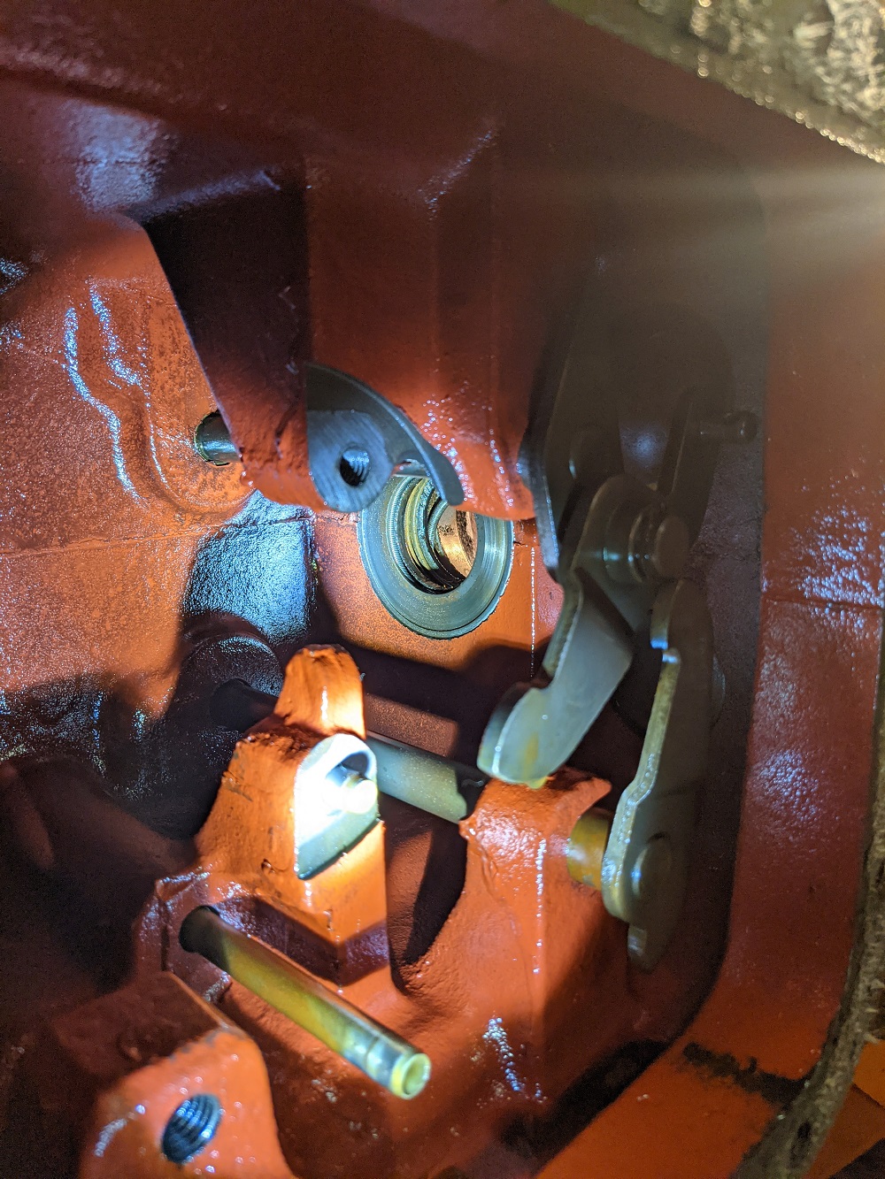

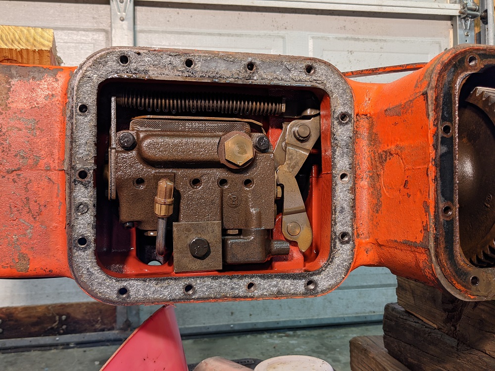

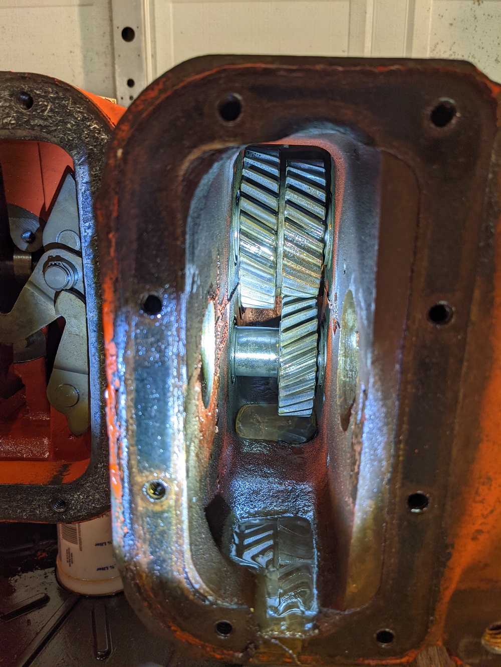

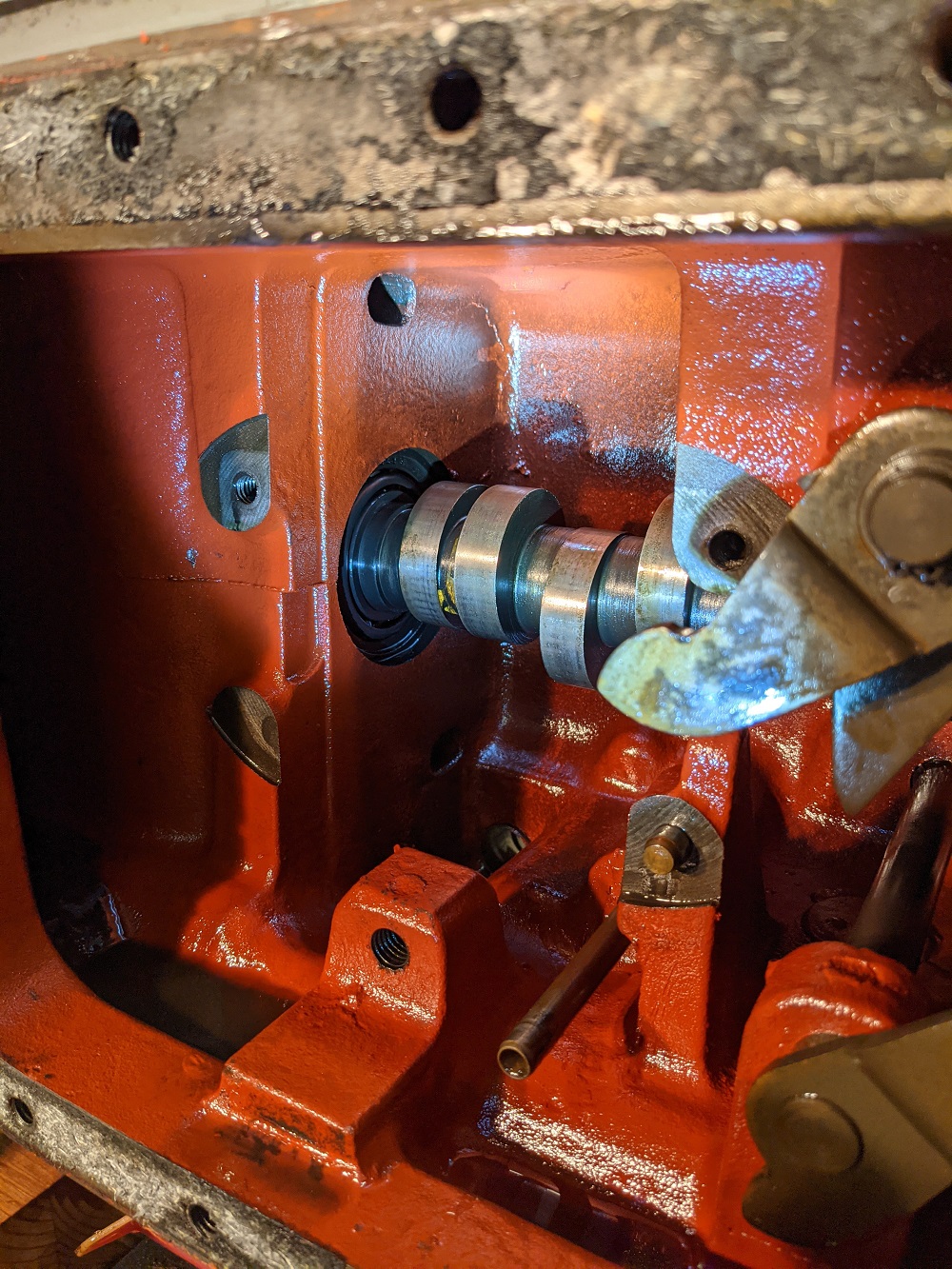

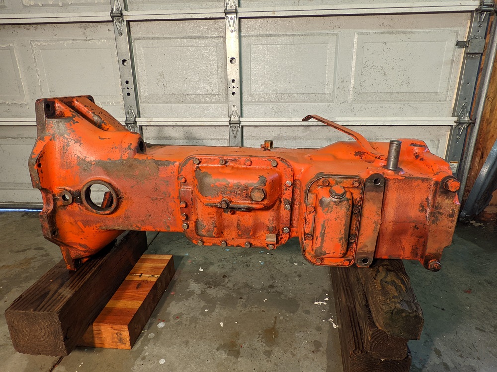

While waiting on parts for PTO and for the power director I've started disassembling the rest of the torque tube.  As stated in earlier thread this tractor had a rattle when in neutral at low idle.  It could have just been the broken power director, but I figure there's no better time to replace all of these bearings and seals on the engine clutch shaft, idler shaft, and intermediate shaft.  Probably get the hydraulic pump rebuilt...  Seems like a never ending list ...  Below are some pics from today.

Nice pictures. My winter job is replacing the the torque tube housing and rebuilding the power director on my 190xt. Hydraulic pump ate some of the ground up gears while brush hogging this summer. Keep us updated, I'm learning as I go. John

sigh, my back hurts just LOOKING at that 'project'. seems like a lot of rust in it..or is that just my aging eyes ??

It's old rust Jay. It'll be fine...just add new hy-tran type oil and it will live longer than the rest of us.

Jay,  there's some rust in the PTO gear compartment.  This compartment communicates with the power director compartment which also had some rust.  I'm going to get everything cleaned up as best I can then fill with universal hydraulic fluid.
  The hydraulic pump compartment doesn't have much rust and to me looks pretty good.  I'm kinda hoping to find a bad bearing on the engine clutch shaft to justify me completely disassembling this torque tube.  Seems warranted either way tho...

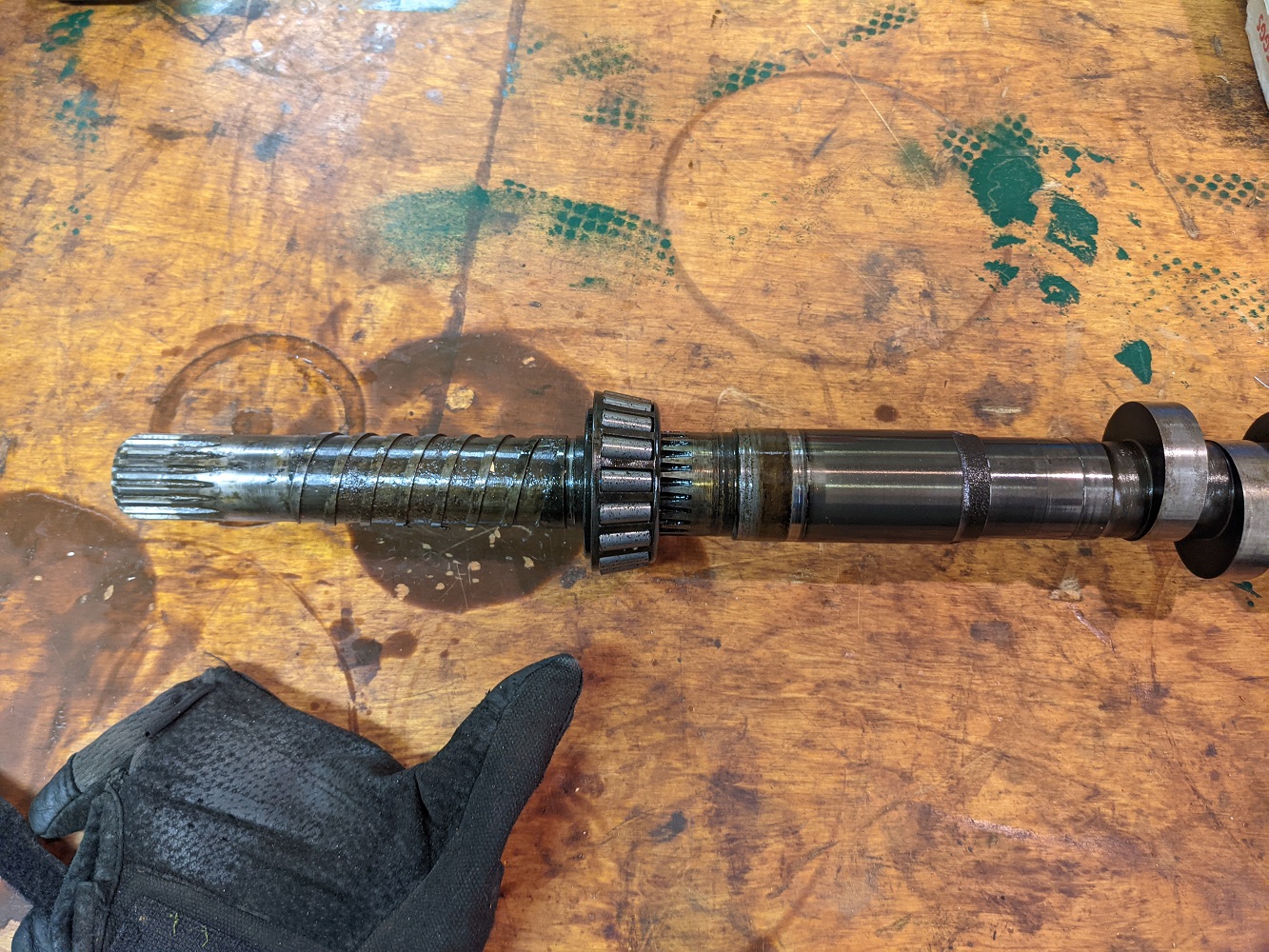

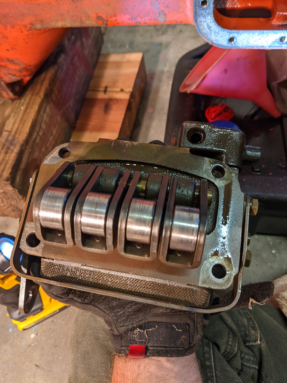

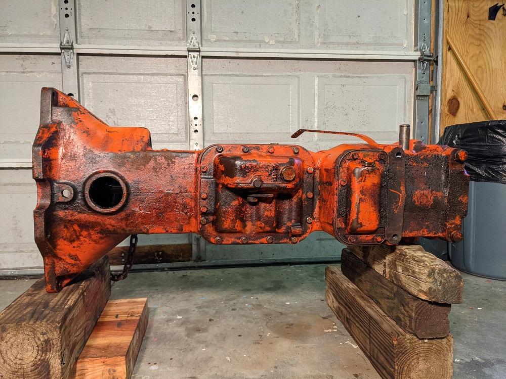

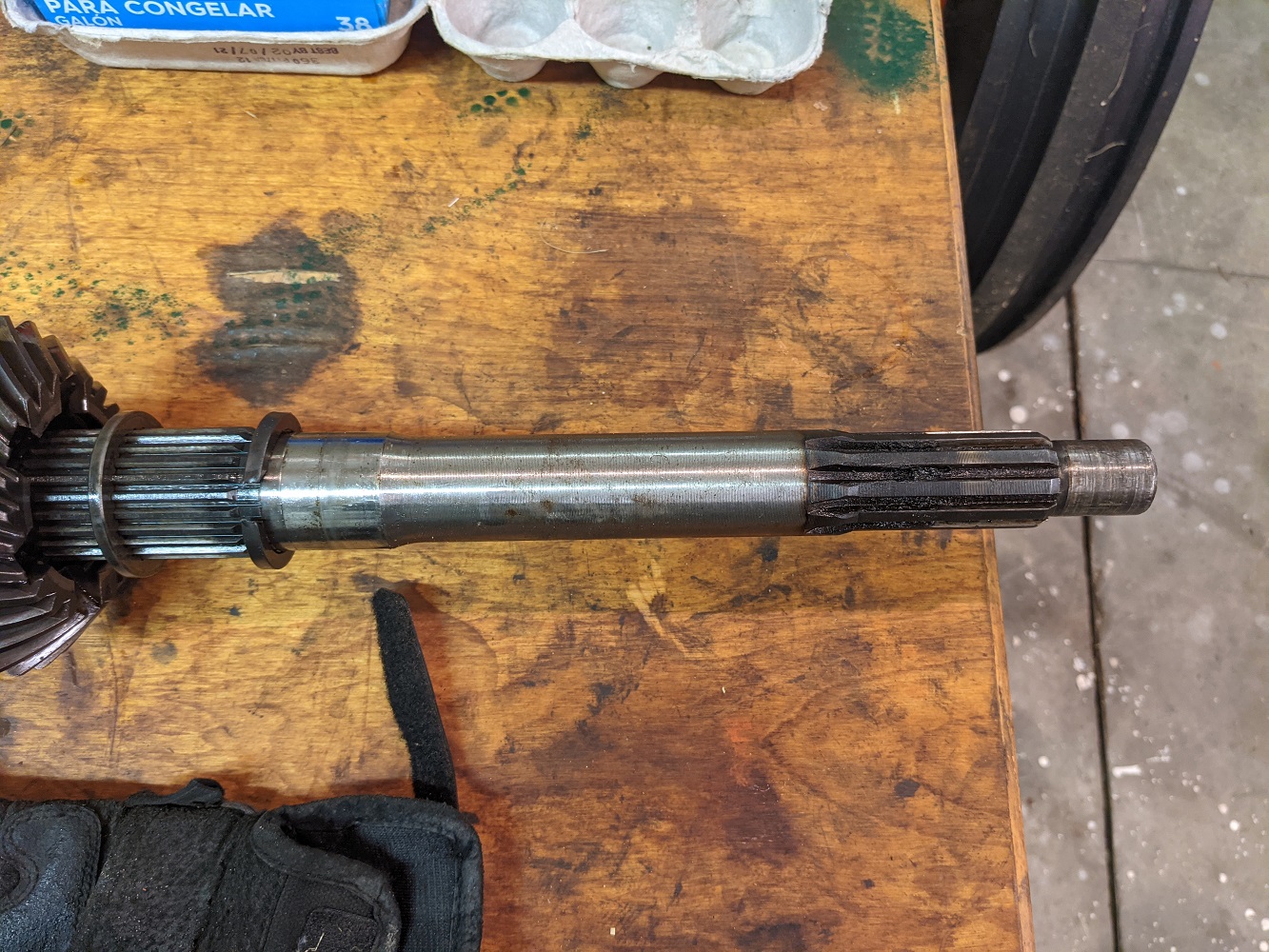

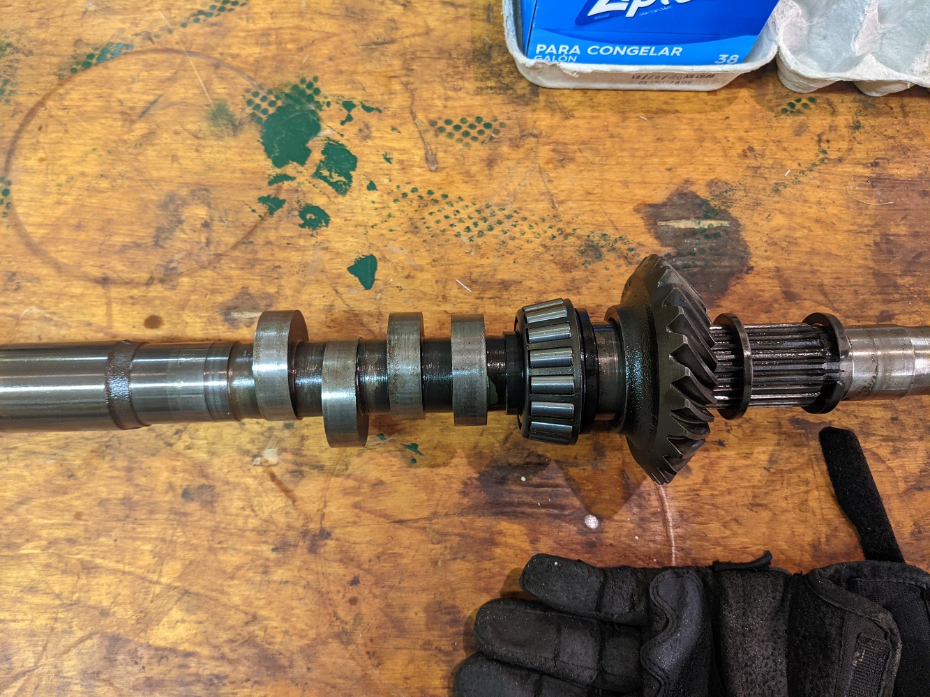

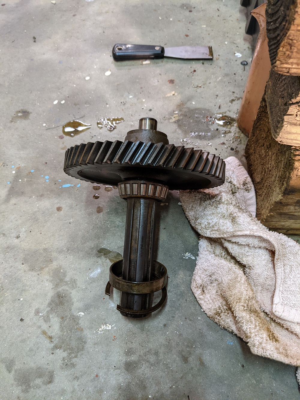

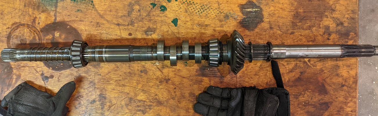

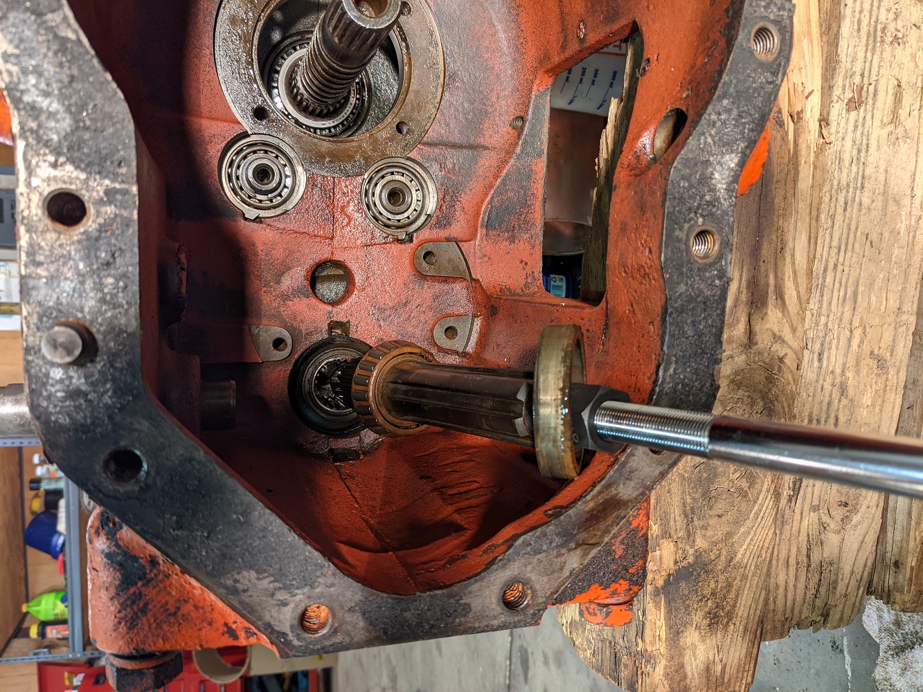

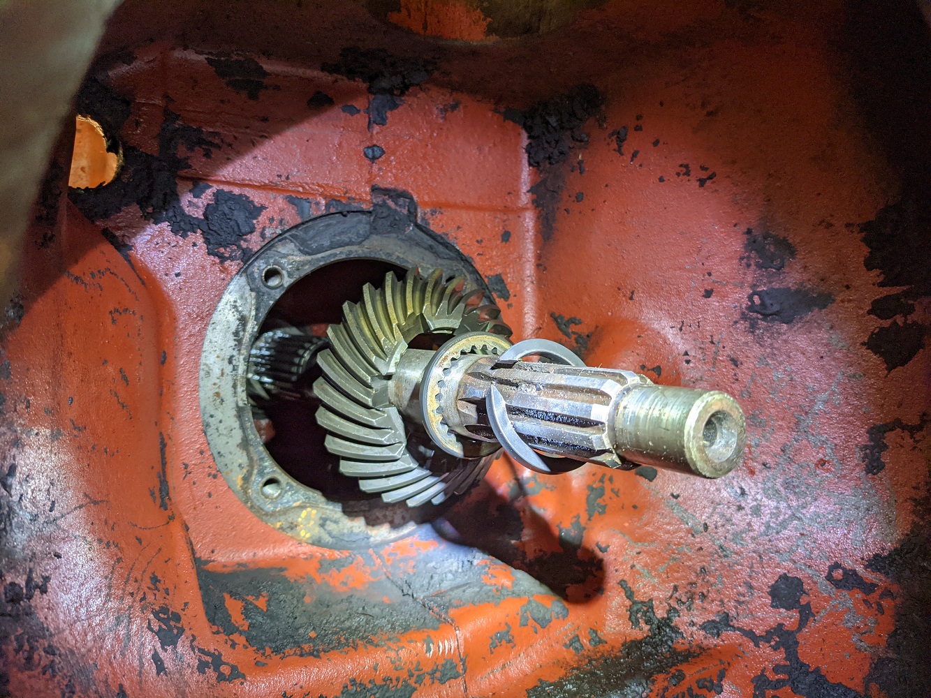

Made a little more progress today.  Used a slide hammer to get the front PTO shaft out.  That worked very well!  Once the PTO shaft and gear were out I was able to remove the engine clutch shaft.  I should get parts in next week and will start replacing all of these seals and bearings.  Once done with these two shafts I'll then do the idler and intermediate shafts.
Front PTO shaft removed
View of idler shaft and intermediate shaft gears
Belt pulley pinion gear
