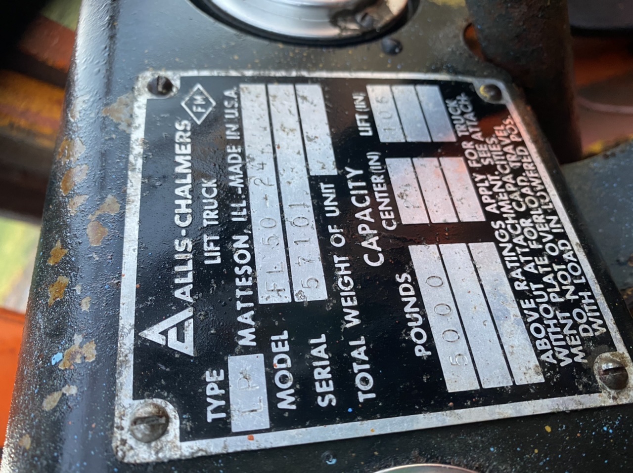

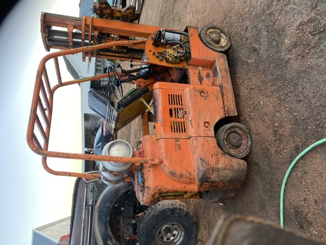

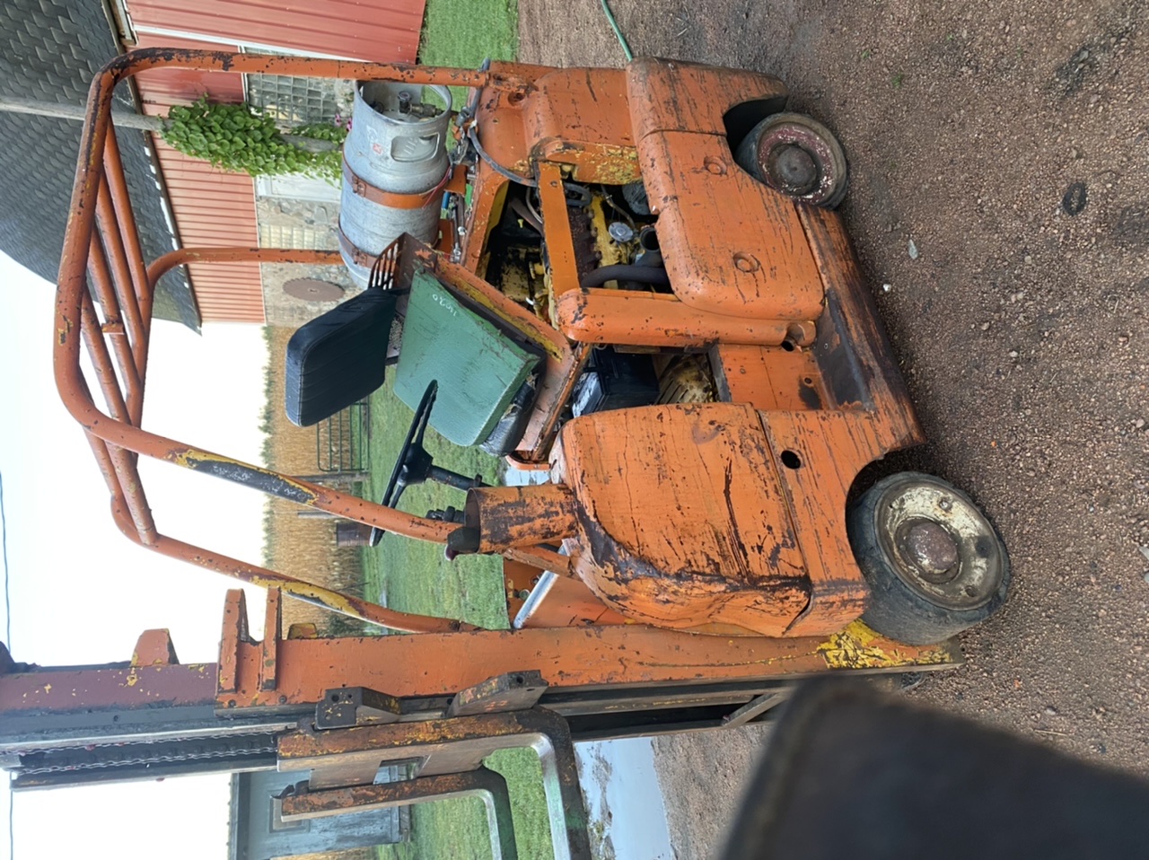

So I named this post this, cause there is limited info on this forklift specifically. Would like to help the fellas and myself by starting this thread. Having troubles nailing down good info on this Allis chalmers FL-50-24 LP lift truck.

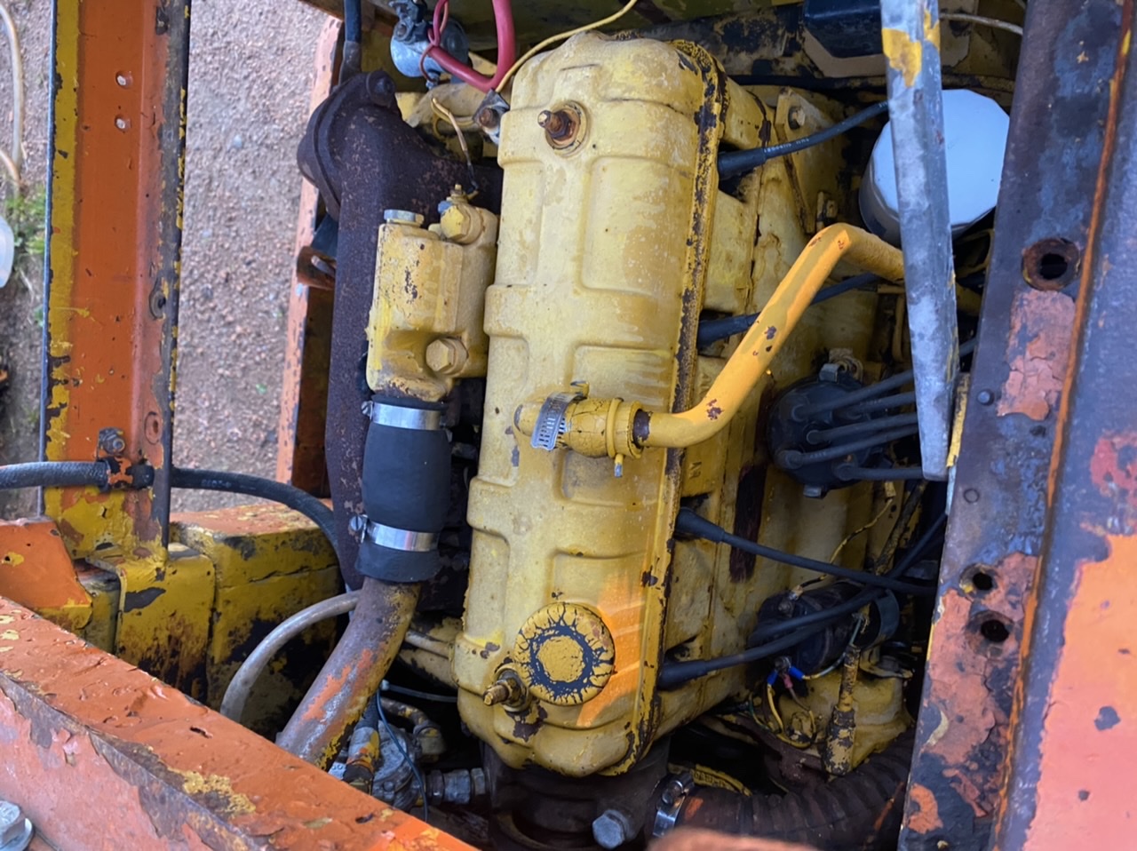

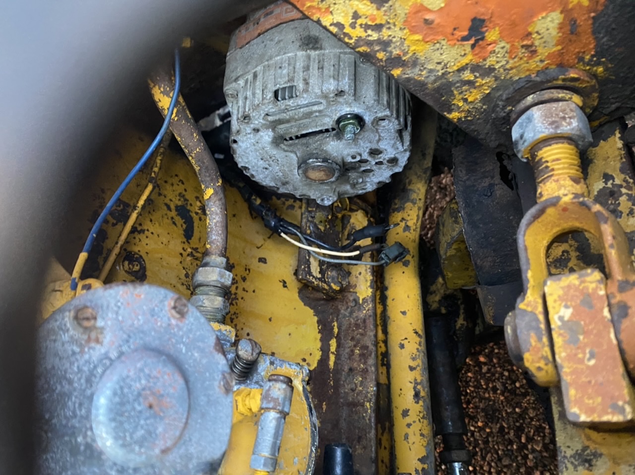

I keep getting a overload code on my multi meter on the black wire that goes to the alt. Dives the am meter. I’m guessing it’s grounding out somewhere but it raises the question, is this forklift pos ground? Also trying to figure out what motor is in here, I think it’s a buda
Here are some photos

Check the wire from the coil to dist.  Is it hooked to + or -  at the coil?

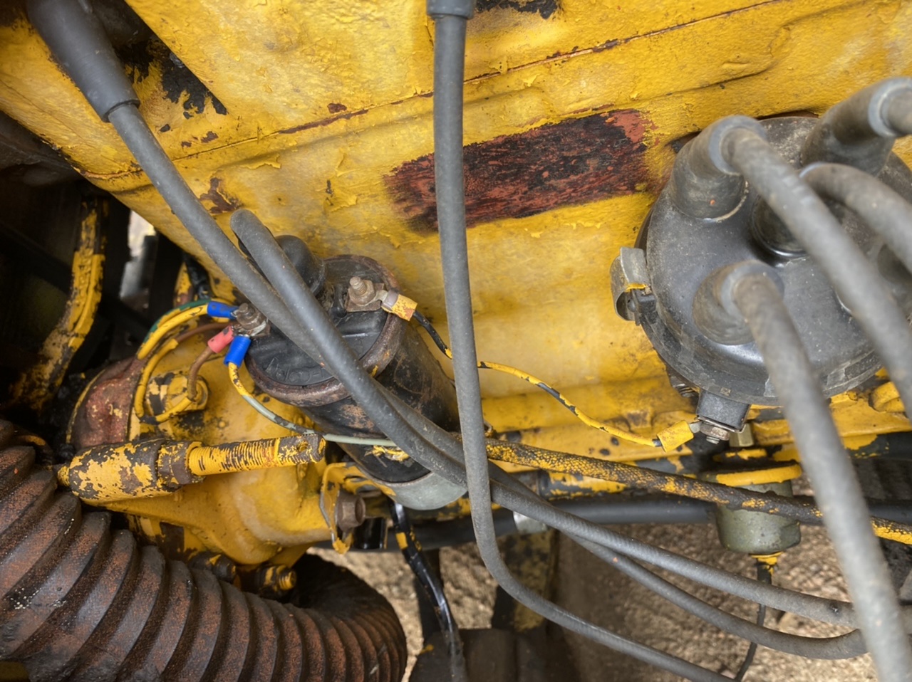

Here is how the coil is set up. - near dist

To me yours looks like the one in the pictures I posted other than it is gas and yours is LP.

If its set up as - to dist, its set up for neg ground.  However, that don't necessarily mean its set up right...Wink

Trying to understand why Three Wires on Pos. Side of coil??  Should be a Ign feed from Switch then Starter Bypass, Third one??

Ya who knows the maintenance guy that took care of this ol girl. Trying to slowly fix all these weird things and I’m tired of jumping it. But my biggest pet peeve is gauges not working. I know I can one wire it but I’d like to get it all hooked up as it was from factory

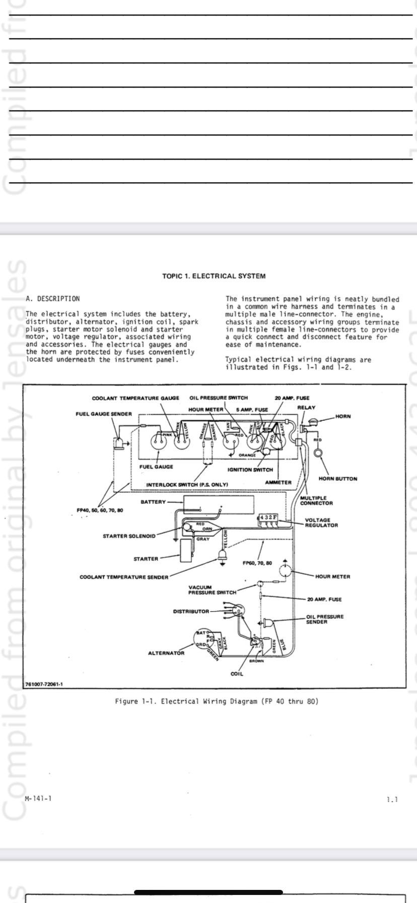

anyone have any wiring diagrams for a FL forklift? still struggling with this thing
Points: 87263
Post Options Post Options   Thanks (0) Thanks(0)   Quote steve(ill) Quote  Post ReplyReply Direct Link To This Post Posted: 26 Oct 2022 at 1:50pm
cant see enough of the alternator to tell if it is an internal regulator or external regulator type... FL50 should be from the mid 1960s ??  Would be very UNCOMMON for a tractor at that time to have an alternator... normally they are generators..
Dont have a wire diagram, but they should be VERY basic in the ignition and charge systems... Amount of dash gauges would be the only unknown..
Wire diagram for a D10-12 might be worth looking at for an "idea" of how things were in the 1960s ........ I see service manuals on line that might have a diagram, but they are $75. or more.

Our F4024 is positive ground.  I suspect your has been changed to negative ground since it has been converted to and alternator.  I had a bad coil wire recently that really made it a bear to get started.

   Agree alternator is usually negative ground. Suggest ditching this alternator altogether and install a single wire alternator, self-exciting type. Dirt cheap.

I know this is an old post but maybe you could still use this schematic. SorryI didn't realize I had this on my drive but here it is:
