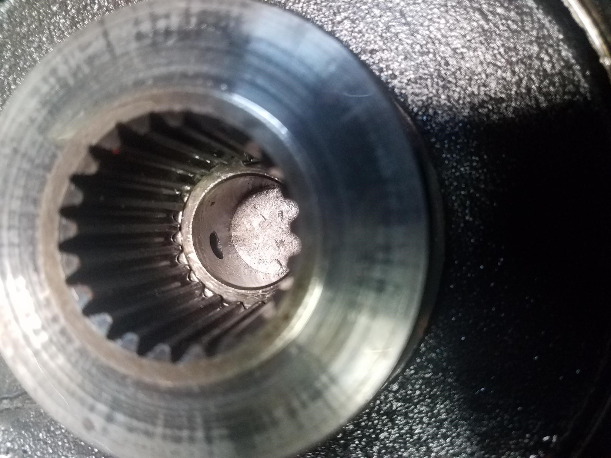

Found some smashed parts of a snap ring at the bottom of the splines in the clutch housing.  Its not shown on the parts breakdown and probably considered part of the housing.  (photo of internal splines, that gap at the bottom had the snap ring)
