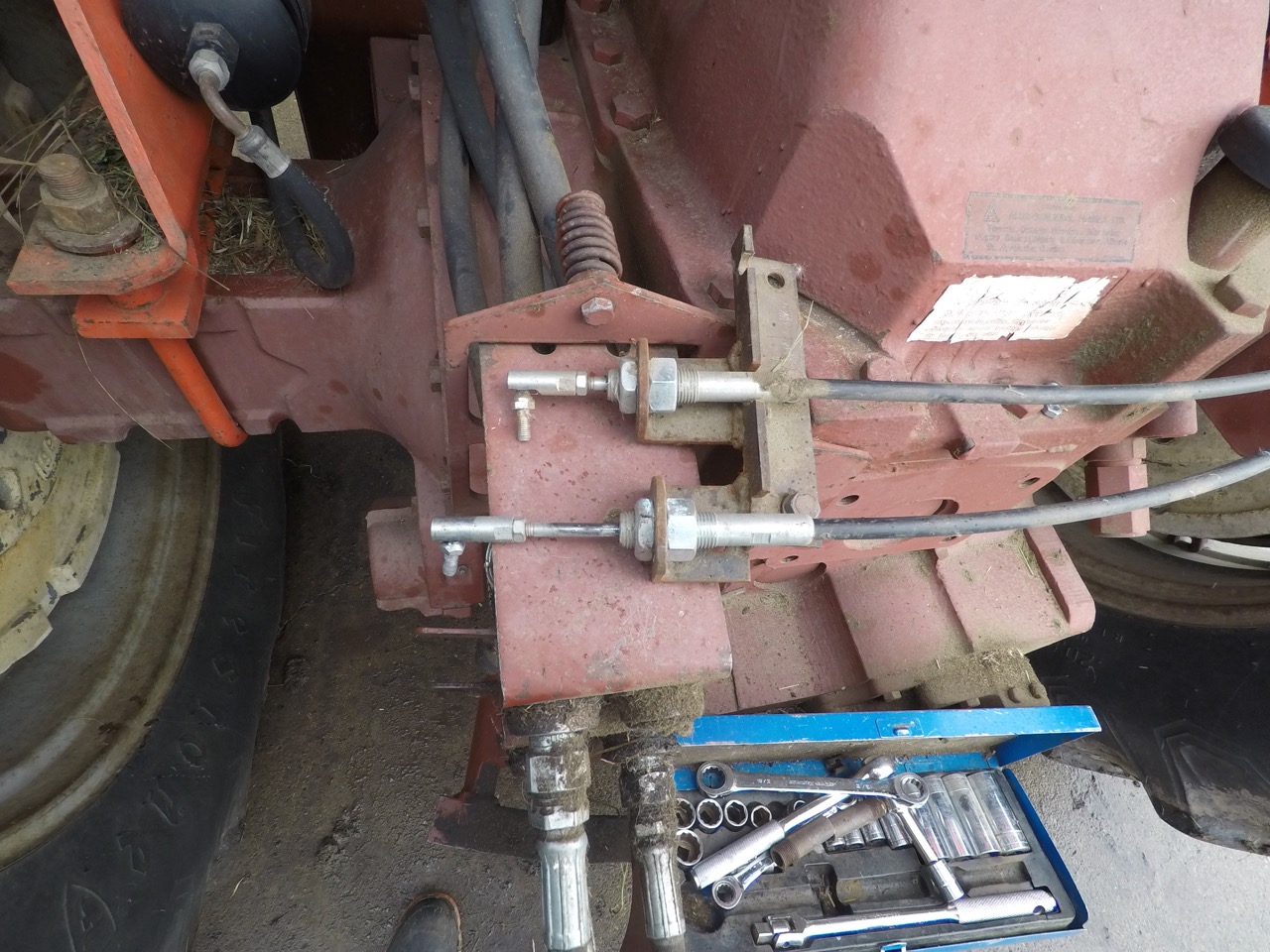

I've changed my 7050 too.   These mods worked very good. The levers move so easy!
There is a threaded adjustment on each end. I had to weld a piece of angle iron on each end with a hole in it to mount the cable.
Look at this:
