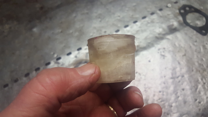

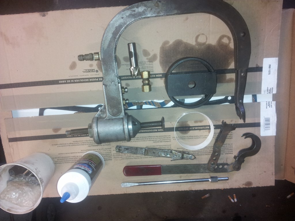

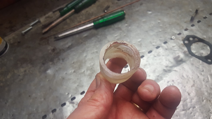

Update.......despite all the good alternatives, I went about it the hard way. I made my own expander tool.
This was made by mixing up some two part marine epoxy and letting it kick off in the mixing up. Then used a 1 5/8" hole saw to cut the OD. That left me with the plug, which had a 1 1/2" OD, same as the inside of the oil seal and outside of the crankshaft flange it has to slide on. Then chucked the plug up in a drill and machined in a taper on the outboard end......down to about 1 3/8". Enough of a taper the seal would slide on and center.
Then drilled inside hole out with a 1 1/8" hole saw using same pilot hole as the original. Was left with plug as you see it. ID of my plug and OD of crankshaft were the same. Hole saw left a snug fit that went on easy, but no play in it.
Because the plug was still a bit under 1 1/2", then made a plastic shim (about 10 thousands thick) from a piece of clear, slick clam shell bubble package from something I had bought. Ended up being slightly larger than 1 1/2". (In retrospect, to avoid needing the shim, next time I'd use a 1 3/4" hole saw for first cut, and then mill it down to about 15 to 20 thousands over 1 1/2" to create the oversized step for oil seal to slide off of....to easily slip over the sharp edge of the flange shoulder.)
Oil seal then slipped over tapered edge and was pushed to the bottom. Expander was then slipped over crankshaft end, until it butted up against the larger step the oil seal sits on. Used a piece of 1 1/2" PVC pipe.....tapped it a bit and it slipped right on....since it was sitting on a slightly larger expander, sliding off onto a smaller step. Was then able to tap it home.
Sorry.....no pictures of the shaft of my piece all mounted up.
Considering this is just a hard piece of plastic, and considering the difficulty in getting that seal on the crankshaft, method calling for a special tool, seems like it would also be a good idea to make such an expander tool out of hard, slick plastic, and include that in the rebuild kit too.
A 30 second job with right tool, way harder job than it ought to be without it.
