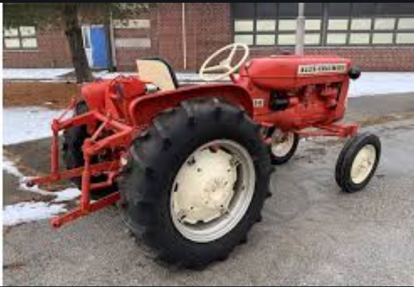

uploads/1181/D10_3_point_2021-05-03_16-05-27.JPG
I had a 1960 D10 similar looking to this one that had a factory 3-point.  I also had a 1962 D15 with a factory 3-point.
