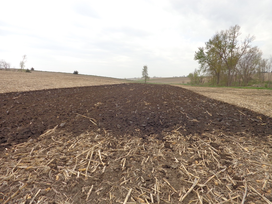

Didn't get to go to the Reedsburg plow day, been itching to try this old girl out. Let's do some 'research'. Water hemp is getting terrible around here, have heard moldboarding will bury the seed and help, so let's give it a try. Just a small plot but should be enough to find out what I want to know.
First time out with this plow, took awhile to get it to digest the cornstalks. Adjusted the coulters a bit and the depth. New gauge wheel worked good. By the time I quit it was working like a champ.

Looks like a nice job of plowing.  Congratulations!

Looking good, cover broads are working.

 I like it! You did a way better job than I did the other day! Thanks for the pictures! Nice ground! You have your tractor weighted up well too. What does it weigh? 5000?

Kenny, yes the cover boards are doing there job, that's why I wanted a set. The dirt really worked up nice. Other than the dead furrows, I could probably just plant it.
Brian, it looks better in the picture than in person. Not that it's bad, just a little crooked here and there from watching the plow more than where I was going!
