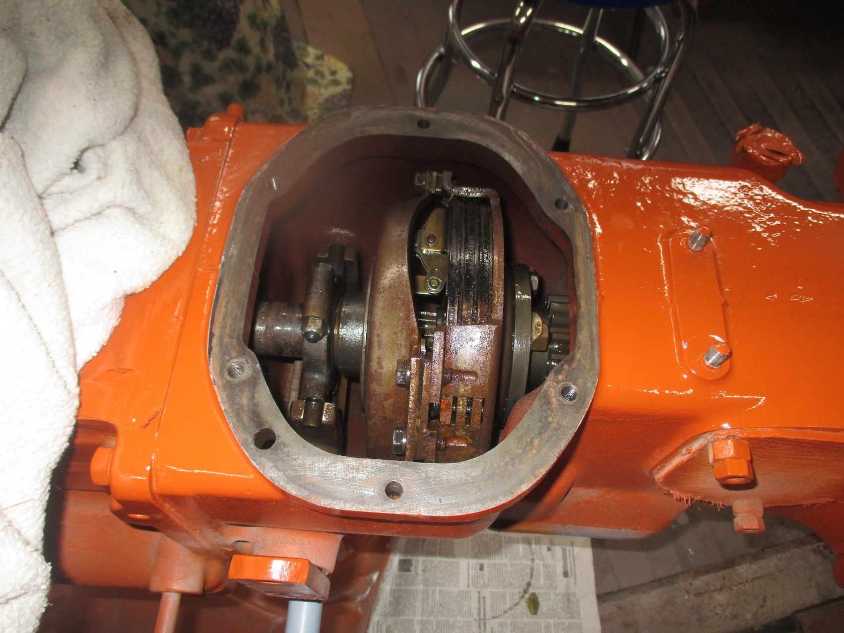

 Looking at the number of clutch disk, is this a WD 45 set up.
  Tim
Points: 22864
Post Options Post Options   Thanks (0) Thanks(0)   Quote DrAllis Quote  Post ReplyReply Direct Link To This Post Posted: 23 Dec 2020 at 7:05pm
Appears to be 3-discs, which the later WD-45's had AND many WD's and early WD-45's were upgraded to when they wore out. Looks like lots of shims are still there for tightening it up if needed.

Post Options Post Options   Thanks (0) Thanks(0)   Quote Tim NH Quote  Post ReplyReply Direct Link To This Post Posted: 23 Dec 2020 at 7:57pm
Thank you Dr Allis. I thought that was what was in there.

Post Options Post Options   Thanks (0) Thanks(0)   Quote Sugarmaker Quote  Post ReplyReply Direct Link To This Post Posted: 23 Dec 2020 at 8:18pm
Tim,
 I see shiney new PO paint we need some additional pictures! Watch the wear in the brass collars that move the clutch bearing. These can get very worn.

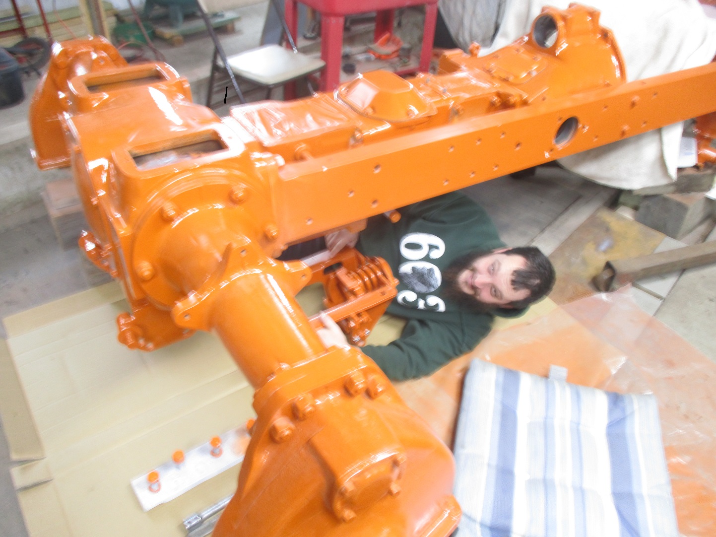

Post Options Post Options   Thanks (0) Thanks(0)   Quote Tim NH Quote  Post ReplyReply Direct Link To This Post Posted: 26 Dec 2020 at 3:42pm
I did post pics of those the steps on my 7000 you got for me. That was last summer. Maybe you were having computer trouble back then. Hers's a picture from today. My son came and helped me put that heavy snap coupler bracket on my WD.   Tim
Points: 8662
Post Options Post Options   Thanks (0) Thanks(0)   Quote Sugarmaker Quote  Post ReplyReply Direct Link To This Post Posted: 26 Dec 2020 at 8:58pm
Tim,
Great you had some help! It sure looks nice! How much work did you have to do on it? Brakes?
It reminds me of my last 45 project!
Keep up the good work and keep us informed! Color looks great!
Ok tell me the trick on the hand clutch. Is there room to get the hand clutch on the pivot pin with the right side rail in place? If so I never figured it out?

Post Options Post Options   Thanks (0) Thanks(0)   Quote Rltool Quote  Post ReplyReply Direct Link To This Post Posted: 27 Dec 2020 at 1:25pm
Tim, I see Kyle is doing the installing today. Your doing the documentary side of it. LOL
Good thing he is so photogenic. LOL
Ray

Post Options Post Options   Thanks (0) Thanks(0)   Quote Tim NH Quote  Post ReplyReply Direct Link To This Post Posted: 27 Dec 2020 at 4:16pm
I needed help, that thing is heavy. I thought the camera had focused, but no, and no redo. lol Kyle can't wait to go to a GOTO this summer.
