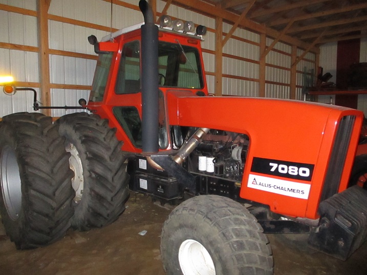

Seen the odd post online where people have re routed the exhaust to the corner post. I have a 7045 i'm fixing up and needs a new stack.
Likely run a straight pipe but now wondering about running it along the cab for better visibility, anyone have any pics?  I'm hand with a welder so that's no prob for me
Still leaves the intake, not sure if it could be moves very easily

I know where there's a 7080 with the corner exhaust, I'll try and get some pictures.

Post Options Post Options   Thanks (0) Thanks(0)   Quote Tim NH Quote  Post ReplyReply Direct Link To This Post Posted: 14 Dec 2020 at 7:30pm
Here's a picture of a Forum members exhaust modification. Very nice job, hope it helps you.

Just getting to reading the replies, Thanks for the picture of that 7080, looks like a real nice job.
If I do go ahead with this I'll build a support to the frame rail, Not going to be attaching to the cab posts or cutting through any panels.

If the stock muffler gives you sticker shock then check the price of a double walled one...... I'll just stick with the regular set up. I can see just fine. I surely wouldn't butcher any part of the tractor for something that really isn't a problem for me though that 7080 looks like it was done right. I wonder if that made a nice looking plug to cove the exhaust hole in the hood?

On a 1 to 10 scale,  that there is a 10 1/2.

Nice work on the 7080. I do like the looks of the original muffler as well. Makes it look mean. I think that chrome setup going thru the hood would be really cool. 😀

That is amazing! That whole tractor looks great
