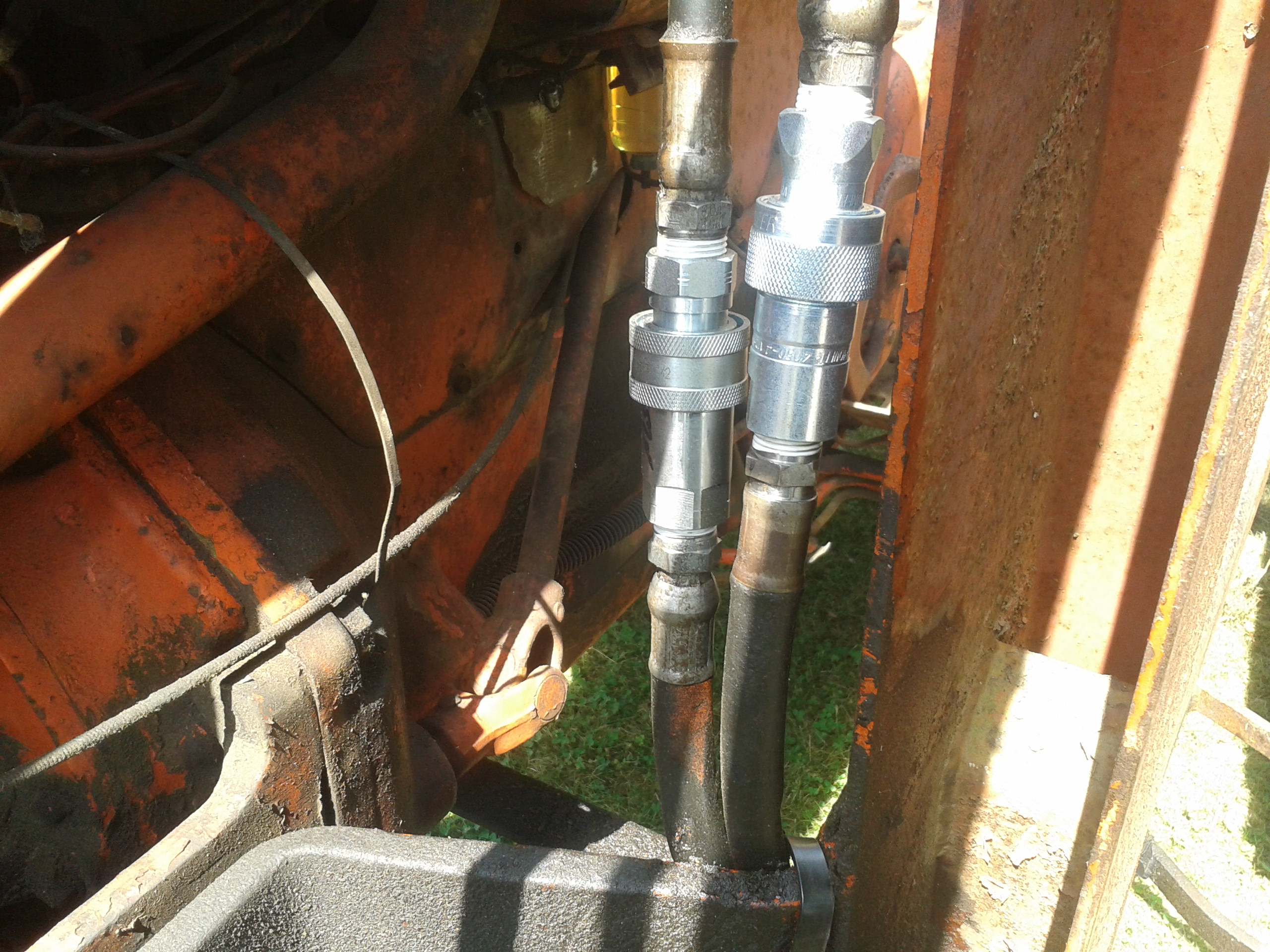

anyway I swapped the seal and as of now, all is well, drier than a popcorn fart. I see where guys would double stack the seal. even though the new seal is thinner than the original, the rubber rides deeper, the felt was there to keep crap off the rubber (or, hold it in I guess)
anyway, that was a major leak solved, and I had 2 snap couplers for the loader that were leaking bad, so I replaced those as well.
The loader does not use the snap coupler.  That is the bell shaped thing under the tractor that the drawbar clicks into.  I think you meant loader cylinders.

yea, dunno. I've always called them snap couplers

they're called Quick Disconnects

learn something new every day. I just looked up "snap coupler allis" on g00gle and i'll be damned...it's a quick hitch system. oops

Around here they are just called hydraulic couplers and many say pioneer couplers. Pioneer is a brand.
