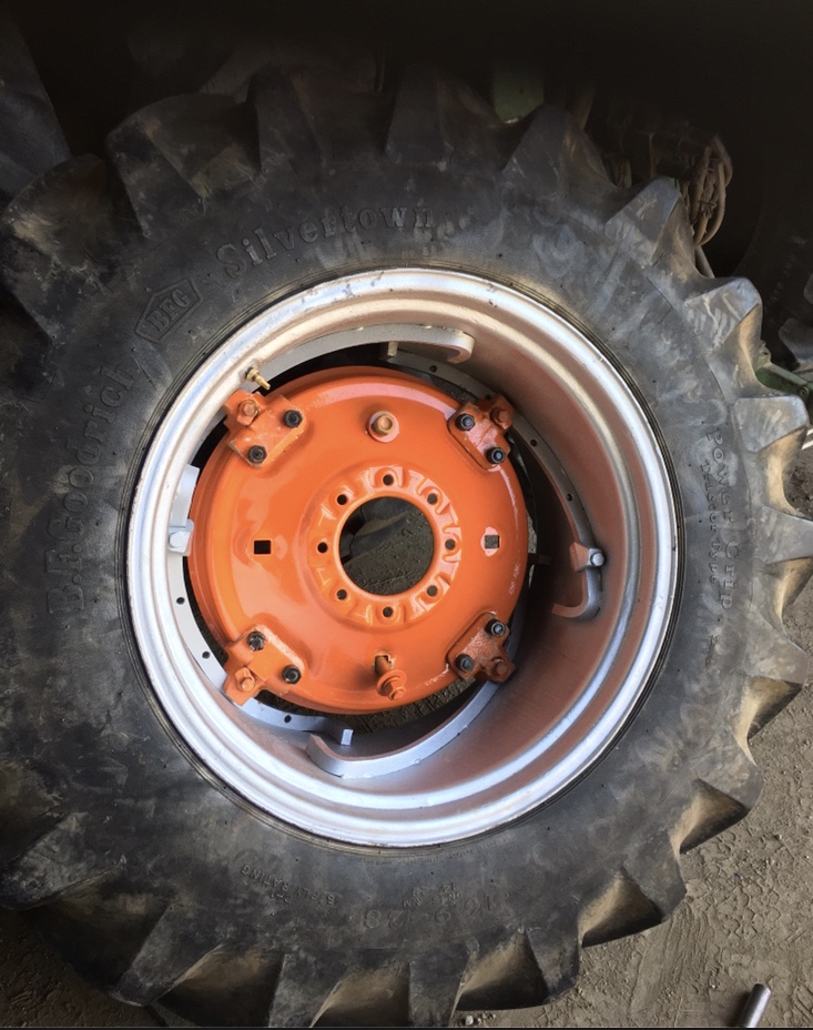

Post Options Post Options   Thanks (0) Thanks(0)   Quote 55allis Quote  Post ReplyReply Direct Link To This Post Posted: 14 Jul 2020 at 7:42am

Post Options Post Options   Thanks (0) Thanks(0)   Quote 55allis Quote  Post ReplyReply Direct Link To This Post Posted: 14 Jul 2020 at 7:44am

Post Options Post Options   Thanks (0) Thanks(0)   Quote 55allis Quote  Post ReplyReply Direct Link To This Post Posted: 14 Jul 2020 at 8:24am
Here is a better picture

Post Options Post Options   Thanks (0) Thanks(0)   Quote IBWD MIke Quote  Post ReplyReply Direct Link To This Post Posted: 14 Jul 2020 at 2:26pm
55, that looks great!

Post Options Post Options   Thanks (0) Thanks(0)   Quote Sugarmaker Quote  Post ReplyReply Direct Link To This Post Posted: 14 Jul 2020 at 9:05pm
Nice big 16.9's on the 45D! I like it. Wheel looks good!
Thanks for posting.
