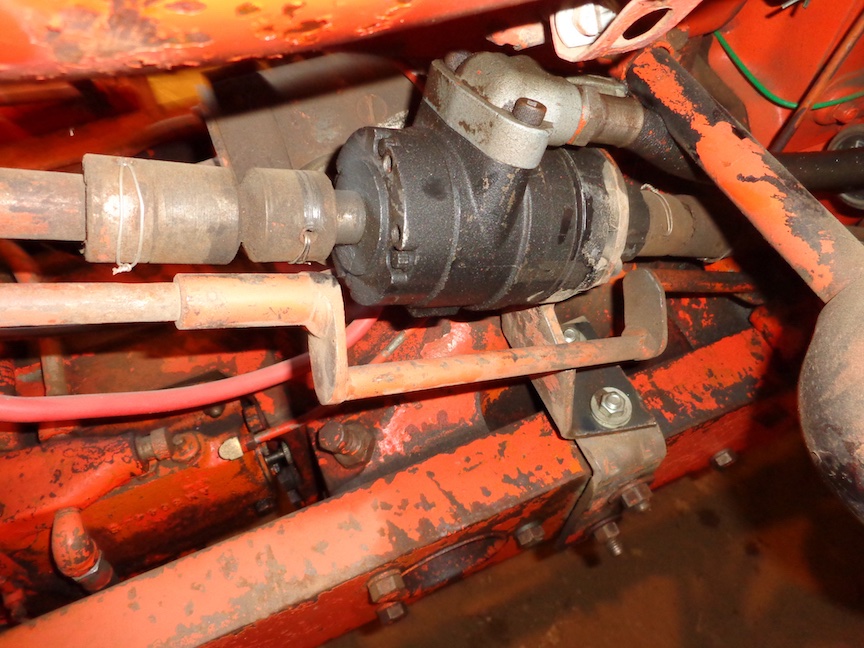

As if I didn't have enough Orange projects going on, I decided today is the day the 'Wide Front' gets power steering. Well, it gets torn down and the process started. Have had this setup around here for several years. Been dragging my feet because I didn't want to have the tractor down. Well, now I'm committed, or should be. There are several little things that I'm going to address during this process. In the better to be lucky than good category, i just happen to have a new steering wheel, that will be getting installed. Going to build up the steering shaft where it goes through the support and install a new u-joint. This may take awhile to get completely done but hopefully the tractor isn't down too long.

I'm not sure if all of these units are installed in the same spot.  My Dad had one, dealer installed and it was just behind the steering support bracket attached to the frame rail.  Anyway, it required a little fab work to bow the throttle and hydraulic rods around the unit.  They probably had to splice in a short section of rod to gain the length required.  It's been a long time since then and that's what I remember.

Dennis, I've seen several different ways the throttle rod has been addressed! The tractor this came from they just forced it out around, really ugly. Have seen one, (or possibly more) that someone used a rod bender to jog the shaft out around. Was a really clean install, I liked that a lot! Alas, I don't have a rod bender so It's going to get done like my NF 45. Whoever did it cut the shaft and made some plates to weld in for the jog, this is in process, will post pictures of it.

I think I  misspoke, probably only the throttle rod is a problem since the hydraulic rod doesn't go down that far.  I don't have a good drawing/picture to look at.  As I recall it was a fairly neat appearing installation and the power steering was a real plus as it was a loader tractor.  On the other hand, I have a WD 45 wide front without PS and unless it has some weight on the front-it steers fairly easy as long as you're moving.

One of my WD's has char-lynn steering on it.--someone added it before I got it. --It does drive nicer that one of the 45's without power steering. One 45 has factory power steering on it and I have no idea how it drives, ---need to pull-start it and right now thats out, since I can't drive the puller and the pulled by myself!
Dennis, the fact that it drives and turns good while moving has kept this project on the back burner for quite a while. However, I have a set of four stack weights I want to get put on this machine and when they are on it steering takes some effort!

Dad used a torch and a vise to heat/bend the rod to clear unit on the WD.

Now that is inventive. I have put offsets in metal by heating it and putting bolts on each side and crushing it in a vise. Use different sized bolts to give different sized offsets.

I kinked mine in the vice with a torch and hammer. It only needed about 3/8" offset to clear the torque generator. My tank is just bolted to the under Sid if the hood just in front of the fuel tank. The pump mount is the worst mine looks as cobbled as it is. Tractor steers with the loader easily. I still need tone slightly moving as my belt will slip under heavy load and I didn't engineer enough tension adjustment into the mount.
