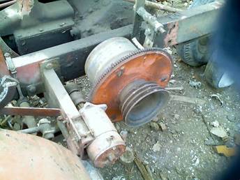

I build some kick-ass starter motors for puller tractors. They're not cheap because they're custom built, but they do the job. No complaints yet. Drop me a line if interested......
You're not the only one - check out this solution:
Has many features:
1. No pesky "nose" to break off
2. Easy visual inspection - even from the operator's seat
3. Expandable - need more torque - add a bracket & another starter
4. Backup power - battery dies - wind a rope around the pulley & give a yank
5. Non-denominational - can use almost any brand starter - the Ford is just one.
In addition, it can be used for:
1. cracking walnuts
2. crimping straw
3. opening the ends of tough potato chip bags
4. zig-zag french fries
5. speed-winding line onto your new open-face deep-water fishing reel

cjohns that is funny,what a set up!

Originally posted by mlpankey mlpankey wrote:
sometimes whats funny is you give a guy the info on  coils and a battery  configuration that makes a kick ss  starter  and they dont believe .  Maybe he can purchase a john deere G and a belt  to hook up belt pulley to belt pulley surely that will produce enough torque to crank it.
...as specified - 2 JDs on one belt.
