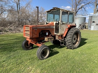

This is the 190XT I recently picked up.  I don't think I did too bad for $1200.  I tell my wife I bought the snowblower for $1200 and they threw in the tractor... LOL  The blower is an International 80.  Had to do a little work with torch/welder to straighten out the flighting, looked like someone had backed into a large rock or sumpt'n.  I changed all fluids/filters, new thermostat, 2 new batteries, wound up having to change the water pump.  Now she purrs like a kitten albeit a dirty one.  I need to take my pressure sprayer out there and give her a good bath.  She's a factory bare-back with a farmer built 3-point system.  Couple things I need to figure out on her yet but I'll get there.  I have a 14ft disk to give her a good work-out as soon as the ground dries up.... farm looks like a big wet mud hole right now.

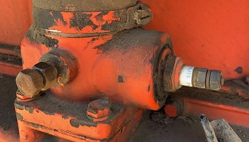

This is on the left above the manifold.  Looks like a short spark plug of sorts, the wire for it is laying below it taped over with electrical tape.  It goes back to a solenoid behind the engine.  Is this some sort of pre-heater?
And what is the plug on the side for?

Looks like a good buy for that price, not even scrap value.

The spark plug looking thing is the air pre heater. There is normally a pipe plug in the side unless the is ether injection.

Great buy! Serial number? Love the early series I bar grilles & arrow decals. Added bonus, it's factory cab should have protected dash/console/battery/seat areas.
Thanks!  It has the first (?) series ether in the cab, the line is there but is not connected to anything.  So I can plumb the ether to the plug and hit the button for a quick shot?  That leads me to another question, if that pre-heater is connected/used, then hit the ether button (injecting right at the heat source), would that not make for a big bang (?) in the manifold itself?
Since this is going to be used mainly as a snow blower which system would be best for starting?  Our temps Jan/Feb can and does frequently dip well below zero, which system is best for starting at those temps?  I will say I don't favor ether after what I saw couple weeks back.  That is a 4020 with engine tore down, did a lot of destruction.  Guys wife gave the diesel a good dose of ether to start with throttle about half full..... engine did not take it well.  I don't want to do this to the 190!
Apologies if my question seems silly.  My other diesel tractor has block heaters and glow plugs, it still does not like to be woke up during low temps.

do not use the manifold heater and ether together, if I was you I would put some kind of block heater or tank heater for ND winters. My 185 has block heater, will heat up in just a couple hours.

I would go with the engine pre heat.  As long as you have good batteries, it will do the job, of course if you have a plug in engine heater, that is even better.

Below 0 i would want an engine heater and good batteries and I would also get the glow plug working, I would hate to think about starting that engine ice cold. It seems like when you start them on ether things only seem to get worse, rings start breaking. A guy I know was doing that with a combine till it got so bad. Just thinking out loud but if a person had to rely on a tractor like that to plow snow or feed animals in winter when it gets down to 0 batteries lose cranking power and I have seen some that have mounted batteries on the frame close to the starter. What would happen if you had the 2 originals and wired in 2 more on the frame?

Skip the ether. Its a down hill slope when you use that. Install a block heater and get the manifold heater working.

The glow plug is energized by turning the key to what would be normally a start position, hold for 15-20 seconds. The manifold will get hot if its working, you will definitely be able to feel heat if it's working
Ok, I hope it works. As you said this will be a winter time tractor, a block or tank heater would be a good investment, also a building to park in will help also,be great if that could be heated too
