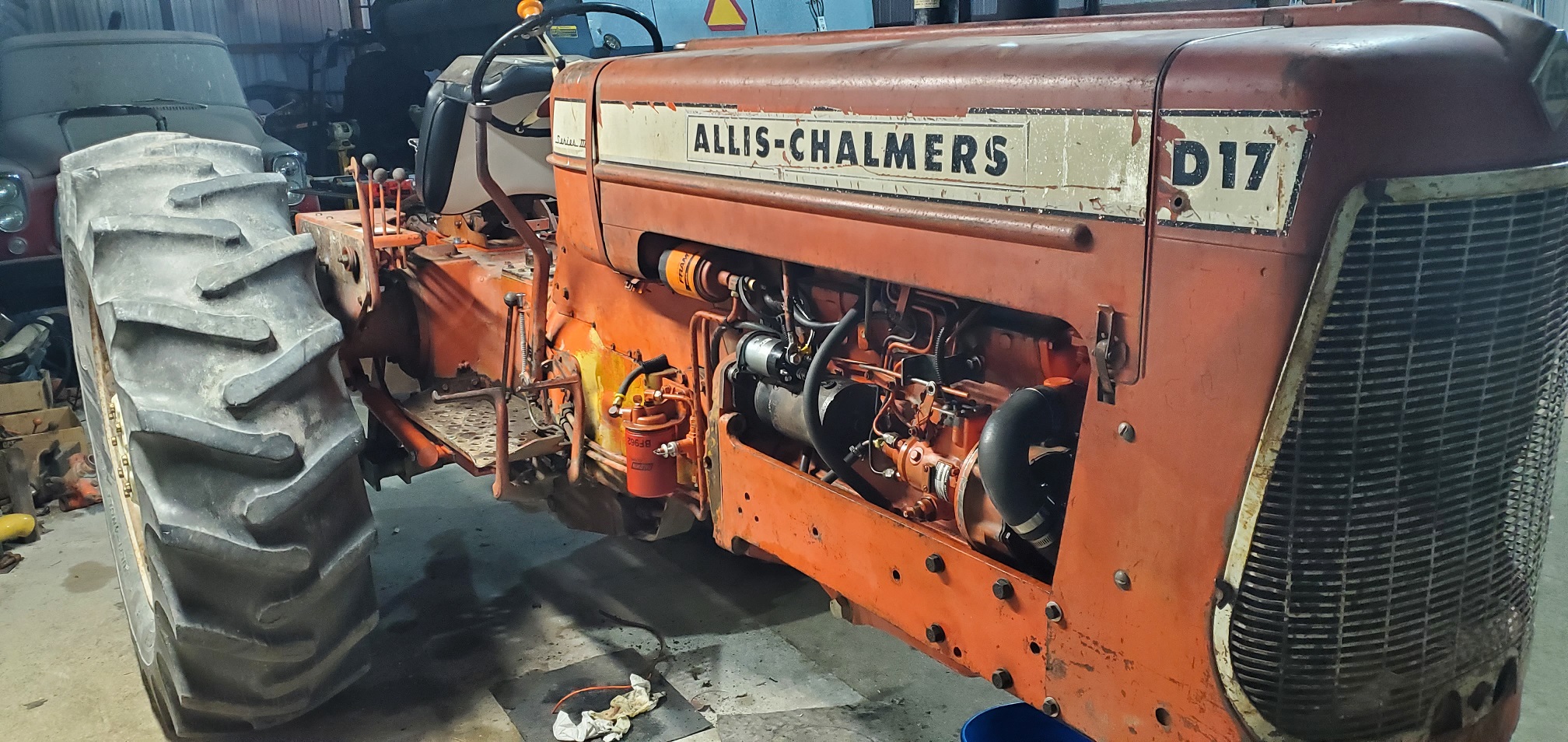

The Dr's.  Look Ma', careful planning means you don't butcher sheetmetal.

Check out a muffler for a JD 830. Offset might be close enough for the hole.

And lose the turbo whistle ?? No way !!

Nice D17 diesel. Is it a 443T or 433I? How many more days til it’s plow day?

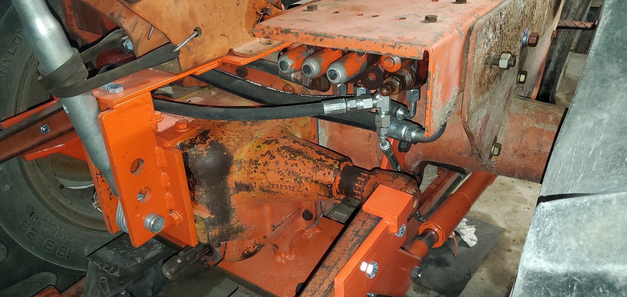

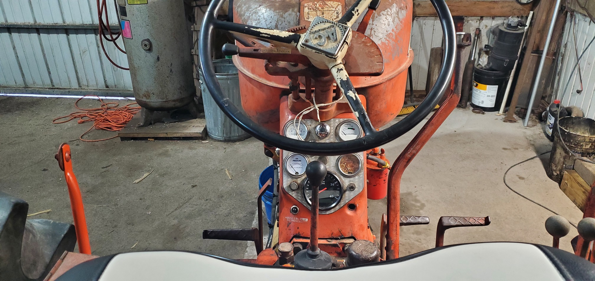

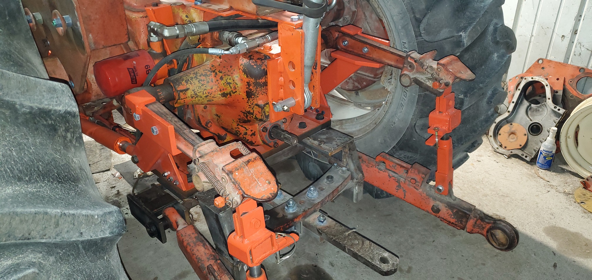

Are you using an orbit motor on the original front steering box and pedestal and control under the dash?
Points: 22772
Post Options Post Options   Thanks (0) Thanks(0)   Quote DrAllis Quote  Post ReplyReply Direct Link To This Post Posted: 12 Apr 2020 at 5:24am
Char-Lynn orbit motor connected directly to the steering worm gear in front. A regular A-C 100 series orbitrol under the fuel tank to send the signal to the orbit motor. This was a big deal and just barely enough room for the orbit motor.  It is a gas chassis with the shorter hoods and side frames. There is clearance to remove the crank pulley without pulling the front end out from under it. The diesel engine is about 3 inches shorter than the gas engine overall. I thought I was going to be forced into using a wide front axle and somehow mounting an external steer cylinder crossways on the tie rods. This way either front end will work. Go to:  D17 project-Google photos      to see an album my son created.  I still have some 1/2" thick rub plates to make for the 3-point lower arms and remote outlets and fender repairs, but it's getting close.  Sad to think the 190XT engine existed in 1965 and this engine didn't get used on the Ag side until 1978 in the F-2 combine. It is a 433-I that the intercooler has been removed to fit under the hood.
Edited by DrAllis - 12 Apr 2020 at 5:50am
Points: 22772
Post Options Post Options   Thanks (1) Thanks(1)   Quote DrAllis Quote  Post ReplyReply Direct Link To This Post Posted: 12 Apr 2020 at 5:41am

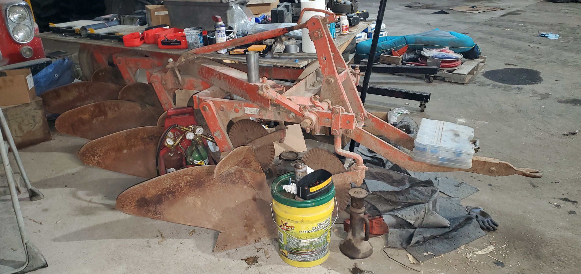

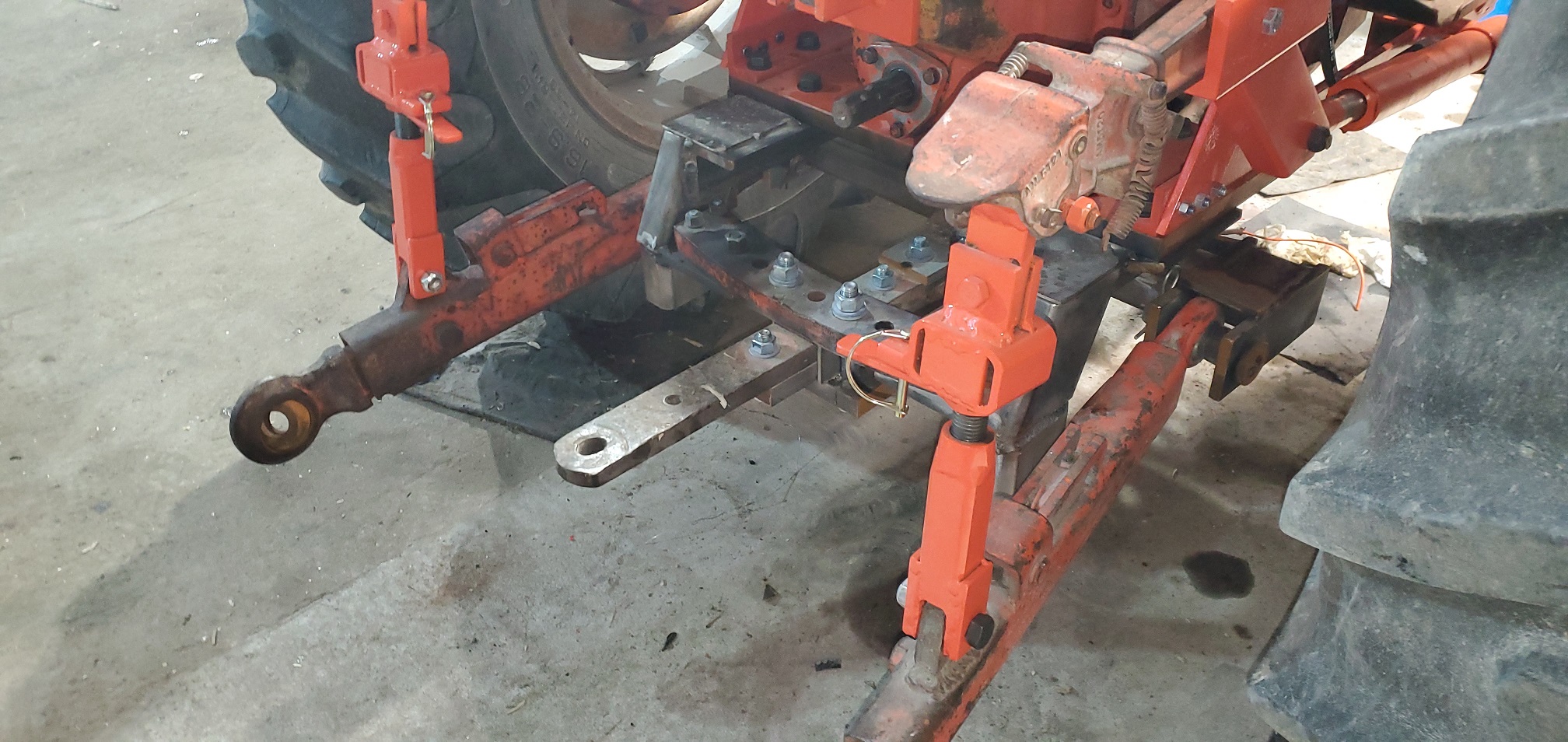

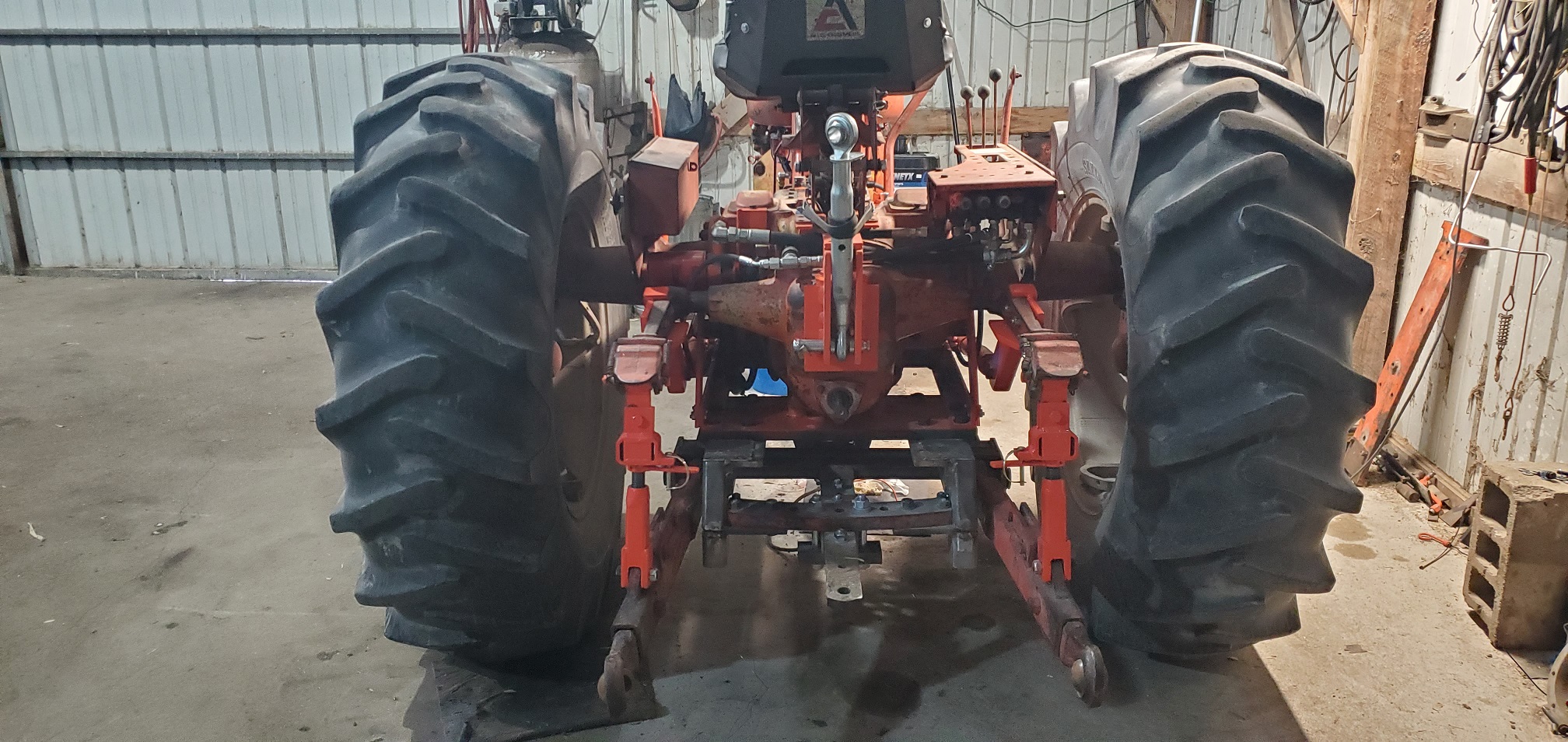

Plow day ?? My brother has 3 acres of sod to do maybe this Summer. The design of the 3-point hitch is such that, after dropping the draft arms/lift links (a 2 minute job), I can unbolt each side frame, the drawbar bail and then pull the drawbar out of the snap-coupler bell and this tractor still works with snap-coupler equipment. The heavy base plate and braces and auxiliary lift cylinders stay on the tractor.

Post Options Post Options   Thanks (0) Thanks(0)   Quote m16ty Quote  Post ReplyReply Direct Link To This Post Posted: 12 Apr 2020 at 8:37am
What is the reasoning behind the external lift cylinders? More lift power than the internal cylinder offers?
IBWD MIke View Drop Down
Joined: 08 Apr 2012
Location: Newton Ia.
Points: 4270
Post Options Post Options   Thanks (0) Thanks(0)   Quote IBWD MIke Quote  Post ReplyReply Direct Link To This Post Posted: 12 Apr 2020 at 8:40am
I like it!
Points: 22772
Post Options Post Options   Thanks (0) Thanks(0)   Quote DrAllis Quote  Post ReplyReply Direct Link To This Post Posted: 12 Apr 2020 at 8:56am
Original internal lift cylinder operates at 3700 psi and 4.5 GPM's. The new "live" hydraulic system (with the pump on the engine) operates at 2200 psi and 12 GPM's, so it takes more cubic inches of cylinders to lift that 4-bottom plow or anything else that is heavy.

Post Options Post Options   Thanks (0) Thanks(0)   Quote m16ty Quote  Post ReplyReply Direct Link To This Post Posted: 12 Apr 2020 at 9:27am
Ok, I overlooked the fact that you went from high pressure to low pressure, via the new hyd pump on the side of the engine. The original system was “live”, you now have “independent” hydraulics.
coggonobrien View Drop Down
Joined: 14 Nov 2010
Location: Eastern Iowa
Points: 1888
Post Options Post Options   Thanks (0) Thanks(0)   Quote coggonobrien Quote  Post ReplyReply Direct Link To This Post Posted: 12 Apr 2020 at 9:28am
He has both systems intact and fully functional

Thanks for posting all the excellent photos. The fact that it’s hood panels easily lift off is so cool for that early era. AC lost that during the D21-100 series era. But glad it got revived or the 7000 & 8000 series.
I also appreciate where you mounted the 433T’s fuel filter & hand primer. Great job! Did the engine plate to clutch housing give you a challenge?

Post Options Post Options   Thanks (0) Thanks(0)   Quote DrAllis Quote  Post ReplyReply Direct Link To This Post Posted: 12 Apr 2020 at 6:38pm
The rear plate mounting and flywheel/clutch were almost as much of a challenge as the power steering. The chassis was a gasser, so that means the clutch shaft is an 1 1/4" or so LONGER than a diesel chassis. Spacing the engine forward that much wasn't an option because of the power steering design. I cut off the nose of the clutch shaft where the pilot bearing goes. I found a metric bearing that would slide onto the splined part of the now shortened clutch shaft. I used a 7000 tractor clutch disc, a 180-200 pressure plate, a D17 diesel throwout bearing shifter, and some machining of the flywheel to get that 100 HP clutch assembly in the 55 HP bellhousing. When complete, the wheelbase of the tractor was 1/8" longer, so sheet metal wasn't any problem. If the chassis had been a diesel to begin with, this part of the project would have been much easier.  The only Sheetmetal change made was the air cleaner stack hole in the hood was opened up about 1/4" to make room for the larger diameter tube.

Post Options Post Options   Thanks (0) Thanks(0)   Quote DSeries4 Quote  Post ReplyReply Direct Link To This Post Posted: 12 Apr 2020 at 8:12pm
You did an excellent job fitting that engine in there and keeping the sheet metal intact, even all the hydraulic hoses are nicely secured in place and don't sag.  These are the things I look for.  You took the time to make it fit and you didn't hack everything up with a cutting torch.

That is one beautiful piece of work.  When I saw the first picture I didn't even realize it wasn't just another stock D17, then I noticed the manifold and, wait, what did he do!
I'll bet there were some cold days working in that uninsulated shop!  What year is that Binder pickup in the background?

Post Options Post Options   Thanks (0) Thanks(0)   Quote DrAllis Quote  Post ReplyReply Direct Link To This Post Posted: 15 Apr 2020 at 7:18am
Both hydraulic systems are fully functional, YES.  The new "live" hyd system auxiliary external lift cylinders simply plug into the OEM high pressure coupler outlet, so all three cylinders work together. When I go to plow with the 4-bottom snap-coupler fully mounted plow, I will unplug that connection and use the internal pump and ram for lift/lower and Traction Booster. I intend to eventually connect the position control lever to the new hydraulic system console to be able to control 3-point hitch depth, but doubt that I will go so far as to fabricate Traction Booster linkage. We'll see.
