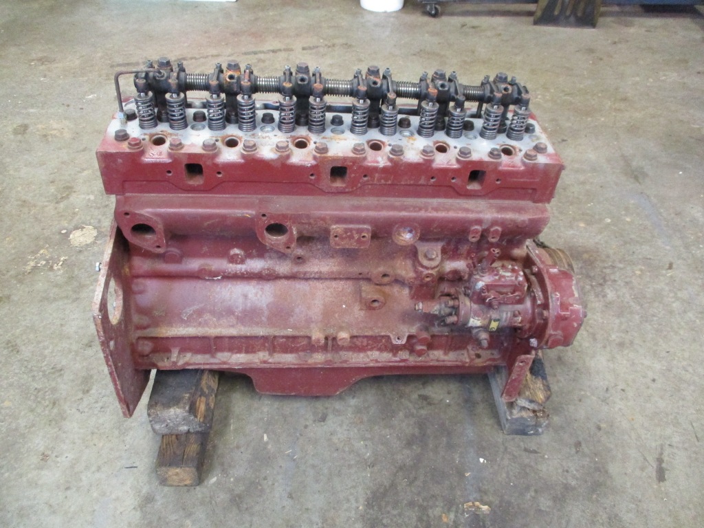

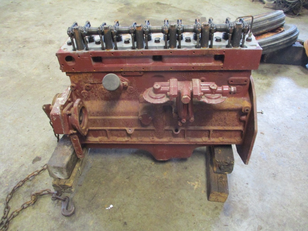

I have a 301 diesel out of a 7000 tractor that I am going to install in a 3/4 ton pickup truck. Truck will be used by me to bum around town and once in a while haul a gooseneck trailer to a tractor show. The plan is to get this engine mated with a manual transmission and one the powertrain is complete, then find a truck to swap this into.
Some of the highways here have 70mph limits on now so I go almost 80 and will need to find trans and differential that can achieve that speed. 5 speed or 6 speed maybe? Also need ideas on any modifications of improvements i should make to this engine for the truck application. I plan to run 15w40 oil and change every 5000 miles.
The engine was rebuilt 8 years ago and sat in the workshop ever since. Turns over but is stiff. I plan to remove the oil pan to inspect bearings and for condensation rust.
Questions: A. Should I worry about the copper sleeves for the injectors? I have a 190/180 head here I could throw on.   B. Should I do any work to the inj pump or injectors for the truck application? (they have been rebuilt)    C. I would like to increase the hp closer to 200hp if possible without making the engine prone to self-destruct.   D. Can i increase the RPMs closer to 3000? the tag on the pump says 2200rpm. E. And how much torque does this engine make at peak torque RPM and Max RPM? I searched all day for a # and failed to find it.
