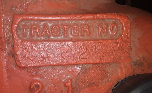

Post your serial number, its in front of gearshift, has tractor no in raised letters, s# will be stamped in.

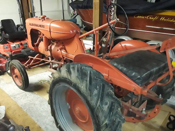

here are the pictures, it is serial #38267   it currently has a belt pully on it (anyone know how to turn it on? Do I pull the round lever under the seat?

Post Options Post Options   Thanks (1) Thanks(1)   Quote DiyDave Quote  Post ReplyReply Direct Link To This Post Posted: 16 Feb 2020 at 8:47pm
looks like a 1940...

yes, according to tractordata.com it makes it a 1940

just found out that under the belt pully there still is a normal PTO, not sure, it might need a conversion though, thanks for all the help, glad i found this group!!!Wink

Dadgum looks like at 21, I'm not the youngest fella on here anymore! Glad to see you have an interest in these old tractors. I got my 1942 B when I was 11 and it's a great machine.
As far as the PTO, yes you pull up on the lever with the round loop under the seat. But have the clutch pressed in when you do it or it'll bark at you when you try to shift it. I have a belly sickle mower like that on mine. Yes, the mower drive sheave is clamped onto the PTO. I'm sure it's the 1 1/8" PTO. You will need an adapter, or preferably an Over Running Coupler (ORC). Both will adapt your PTO to work with newer implements. The ORC is usually suggested because since the PTO is transmission driven (ie-geared to the transmission and rear end) when you get a load on the PTO (think rotary mower) and push in the clutch, the spinning inertia from a rotary mower (for example) will keep turning the PTO and keep pushing the tractor forward. It's not that big of a problem unless you get in a tight corner and need to stop quick. I use one on my tractor when running a combine and rotary mower, and it's kinda nice to have. With a sickle mower this won't be an issue, as they don't have much momentum going.

The fact that you have a PTO doesn't mean that you have hydraulics. Show us more pics from the rear of the tractor, so we can see what is under the seat.
